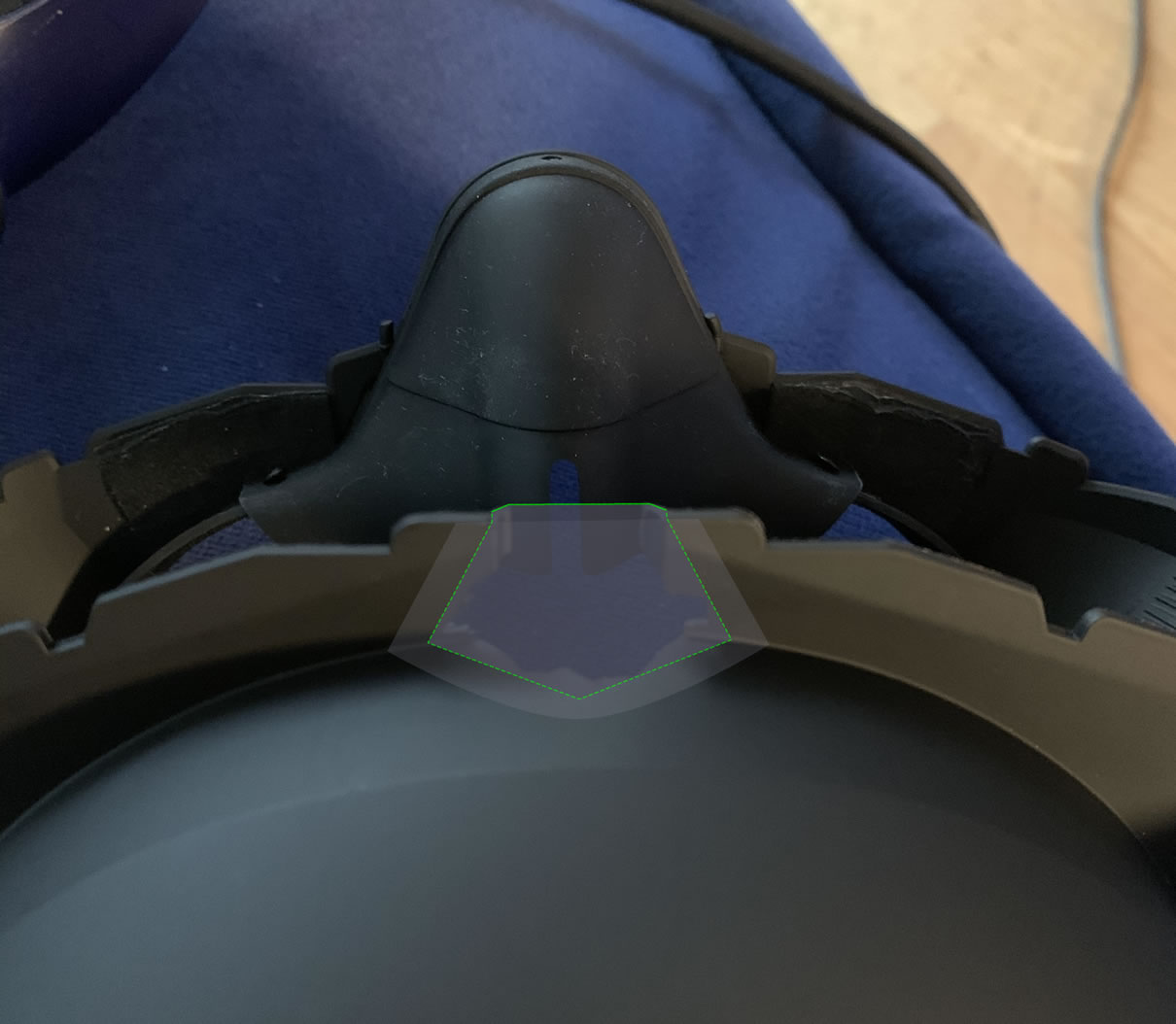

Edit: make it removeable with bare hands.
Thank you. In the case of plastic, the cutting line would have to be very thin so that it can be removed by hand. There is also a risk that it will accidentally break out.
A prepared cutting line that has to be run over a few times with scissors (or a cutter) would be stable enough when not in use and could still be removed easily.
If the cutting area is prepared finely enough, the cut element can later be used as a cover and fixed with an outer one-sided adhesive pad. Which could be included with the eye tracking modules.
See my linked post… :nerd_face:
With 4 cutting lines and the appropriate adhesive pad to reattach the cover. In combination with a finer and somewhat longer cable, this may be a medium-term compromise.

eeek, i thought the fact that i had to have a cable sticking down to the usb port was bad, but having to mangle your shiny new hmd to fit eyetracking is extremly ghetto.

Apparently, You missed this?
https://community.openmr.ai/t/eyetracking-installation-guide/29529
Unfortunately, it appears that the 8KX is still clearly an enthusiast headset. You will likely need to make some DIY adjustments, like installing the Deluxe speakers to upgrade your MAS.
I’m OK with having an enthusiast product, but it makes it hard to recommend to others.

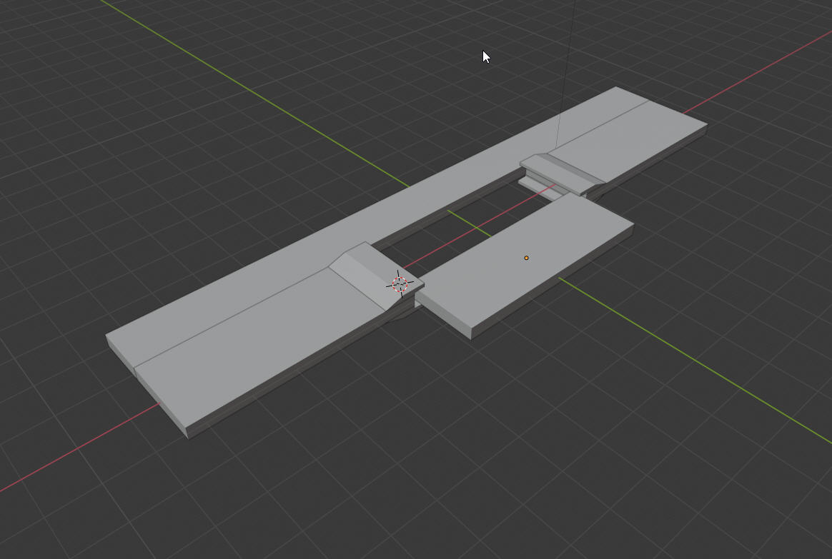

They should incorporate into the comfort kit something like this, sorry a quick 5 minutes mock up.
the injection molds are very expensive and very complex to manufacture. it takes a long time. and your version requires 2 of these injection molds.
It’s better than mine… :rofl:
True. A less expensive option would be to incorporate a “break away” tab. That way, if you install the eye-tracker, you could just pop off the tab and be left with a clean gap.
Why not just have an open space there.
The padding covers it anyway.
Would certainly help airflow and reduce fogging up, without adding light bleed.
