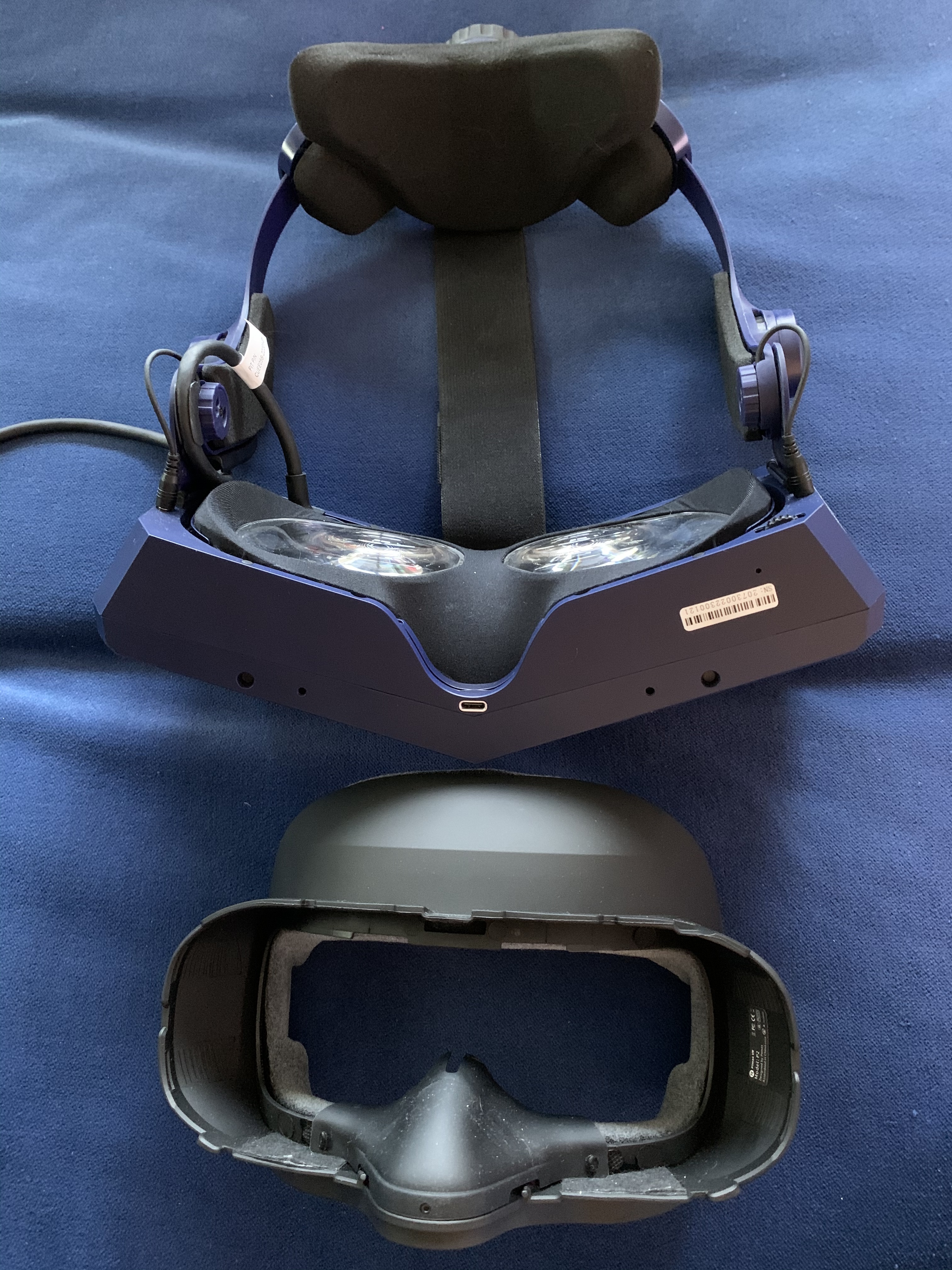

Just installed the eye-tracking module in about 20min.

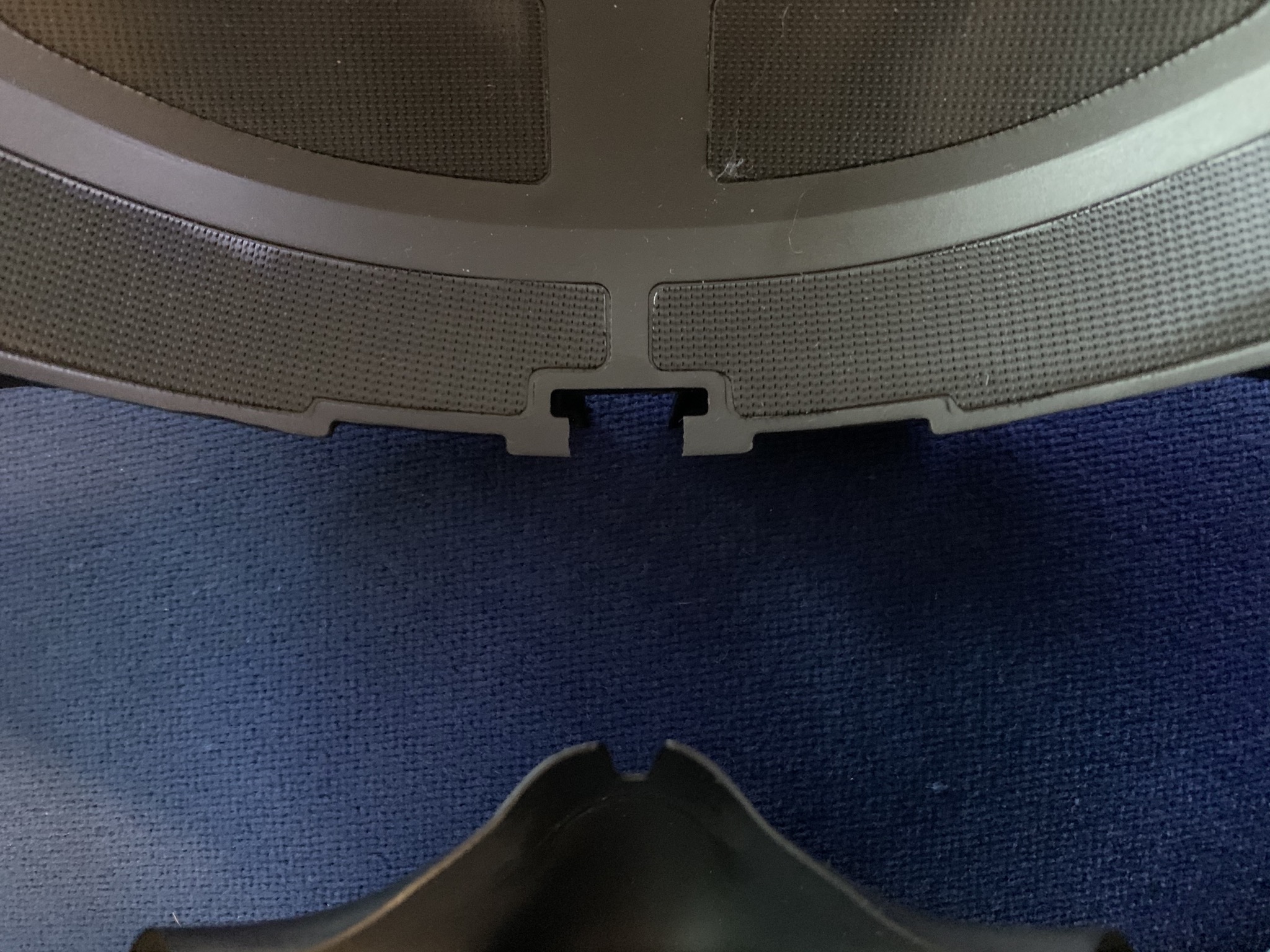

Removing face mask was easy, starting from the lower nose part.
Removed the part needed. Plastic is soft, easy to cut just pressing downwards.
Cleaned the lenses, removed the adhesives from the frames, applied the frames, removed the protective foil from the backside of the eye-tracking glass, pressed first the plug on top in the hole of the hmd (where the USB port is on non 8kX models) then positioned the modules on the metal rings, removed the adhesives on the front glass side.
Dialed the ipd to lowest (helps with guiding the cabling for the two eye-trackers (removed the face foam for it)
Finished!

Turned on the hmd and dialed the ipd in. From around 67mm on I realized a tension on the eye-tracking cabling to a point where the eye-tracking modules suddenly snapped out of position.
So I checked the cut-out:
And extended it in a way that the cables have more room outwards:
Then I put the face mask in place and:
Realized that there is still tension, especially if the foam is on and the forehead presses onto this area. Then the Lower part of the modules snap Up. Sh*t.
So I made even more room, to a point where there is no pressure anymore on the cables:
Even so it looks terrible, the outer side cut is not visible because hidden by the tracker electronics part.
