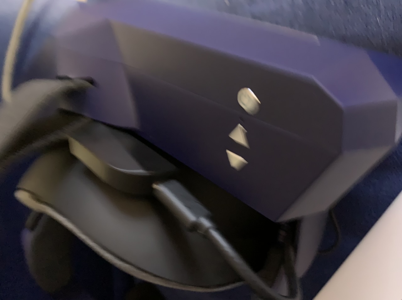

No flash. Better? :crazy_face:
It’s a bit blurry, could we get a better take the next time! Those miraculous metal buttons, I’m jealous. Lol
yeah geez thats a good point, something was bothering me when he said “adhesive”

look at the pictures of my first post. speaks for itself.
The issue is a bad designed face mask. I have no clue how Pimax managed to forget to make room for the eye-tracking module which is in development already for a long time.
It puzzles me how they could show and use pre-production facemask with eye-tracking at the shows and not realize that problem.
