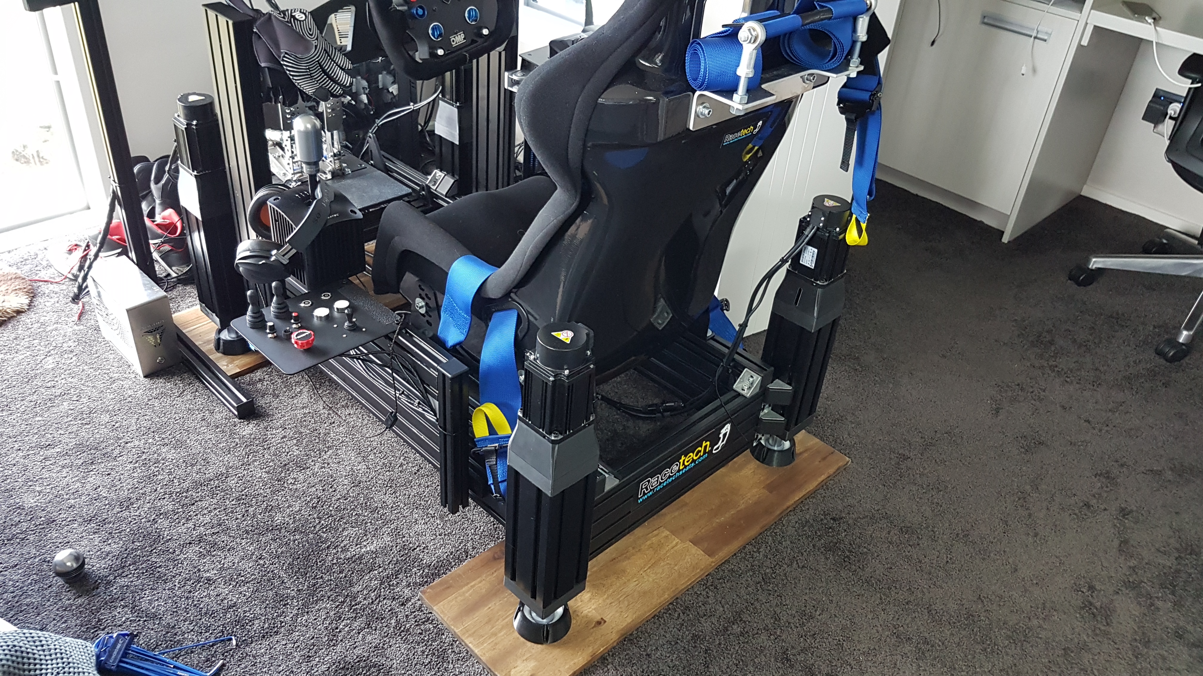

As for usage , My rig is the same.
Race sim only…gets turned on to race and thats it. :slight_smile: and its had a few upgrades since this photo, so its a serious ā€œPlay Hobbieā€
