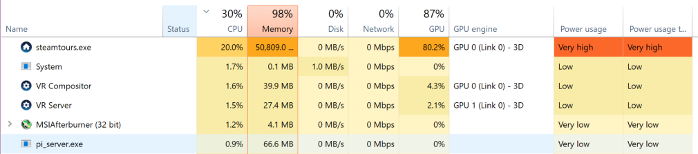

Not sure where to put this but this thread seems to be fairly technical so… just a curious observation after forgetting steamvr on over night with the headset turned off. I’m guessing it is steamvr home that is running up the power bill, but steamvr crashed when I tried turning the headset on to see what it was doing.
Under the worst non-synthetic loads, my i9-9900k and RTX 2080 Ti system consumes <400W. Under synthetic load (overclock burn-in test), <650W.
Running 24h/day, this would cost ~$32/month.
Not great, but much smaller than lighting, HVAC, and similar loads. Moreover, the machine can be turned off when not in use.
I am much more concerned about how tenuous the whole SteamVR stack seems to be, and the resulting economic/ecological damage done by that, than the power directly consumed.
Ah, i wasn’t really worried about the power bill, i was just trying be a bit tongue in cheek that in this case it was steamvr home keeping busy over night.
It is actually more the memory use that is interesting, it suggests that there is an significant memory leak in steamvr home.
Probably is. I don’t imagine many people actually spend much time in SteamVR home, especially now that it breaks OVRDrop panel positions and such.
