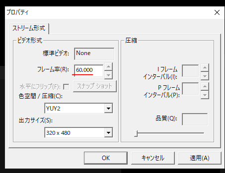

I am an early purchaser of Droolon P1.
In previous tests the calibration didn’t work at all.
I updated the firmware according to the procedure.
Now it’s still running at 60 FPS, but at least the calibration was successful and I started doing eye tracking.

120Hz is not possible in 320x480 for me either, but it is in 320x240.
You did not switch the resolution as instructed in the instructions.
It should say default next to that resolution and it will switch to 120
