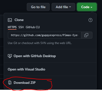

make sure to download the full code it will not work unless you do so.
