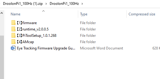

Just download the package from pimax.com under Support → Eye tracking.
The link is:
It contains this:
Now, run the firmware update (for help, check the Word document guide provided)
Install the runtime. But skip the old PiTool. Just run latest PiTool.
In PiTool, when eye tracking is connected, make sure the 7invensun Runtime is running (theres a warning message under the HMD icon in PiTool if runtime is not started).
Now just run the calibration, then enable DFR in PiTool and run any game that supports it. Works really well.
Its a 2-3 minute setup basically.
I have tested it on 5K Plus, 5K Super, 8K Plus and 8KX. All works.
It has never been easier than now.
