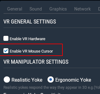

How to set up your xp11 controllers:
First make sure to “enable VR Mouse Cursor” in VR settings. Do not enable VR mode yet.
In keyboard settings, search for “VR” and bind some keys to the “Toggle the 3-d mouse cursor in VR”.
Now enable VR mode.
Move your mouse and validate you see its pointer in the VR space. Use it to open the Joystick settings. Pick one of the controllers “aapvr” and map it as follow:**
