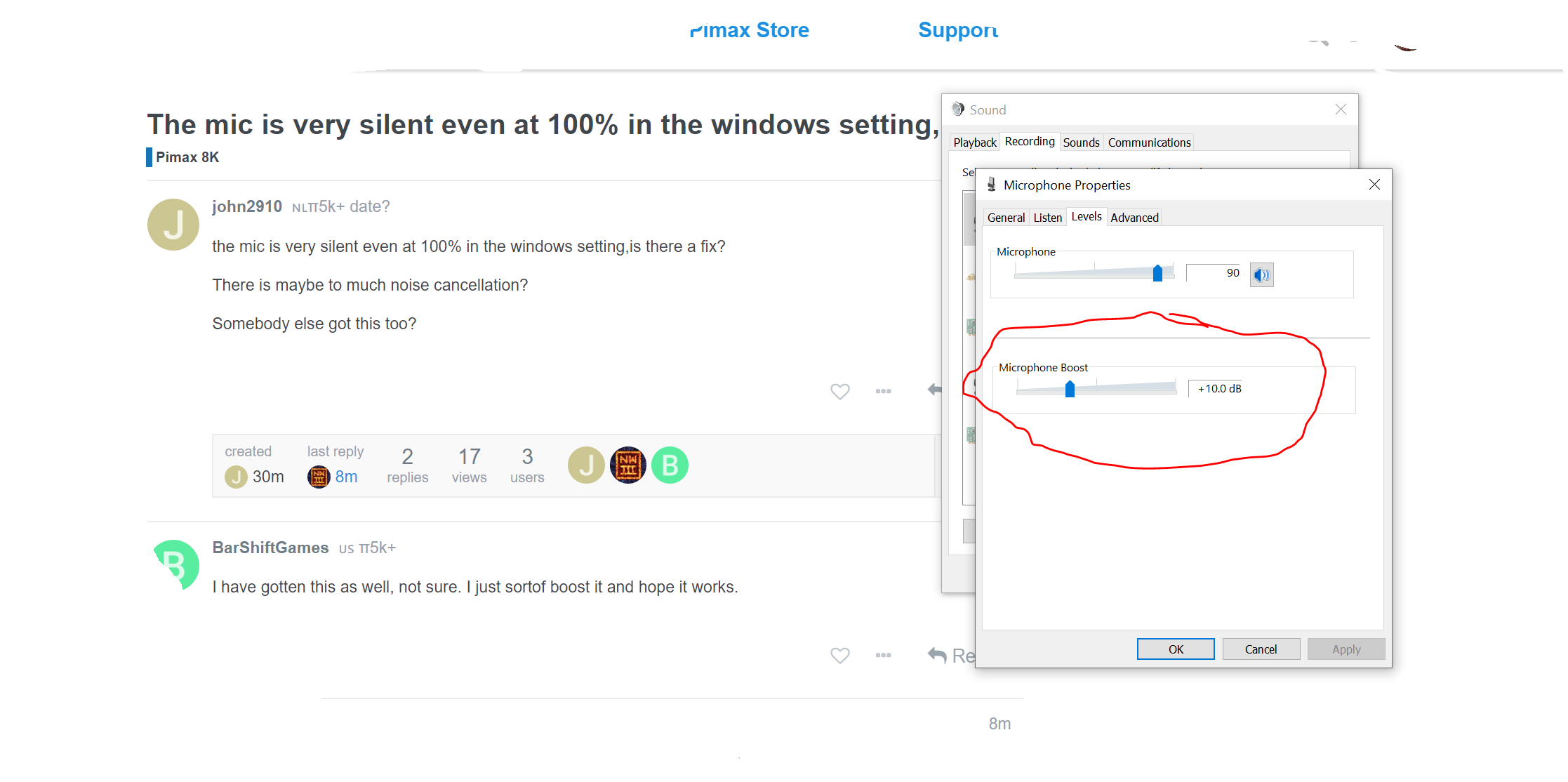

The mic is very silent even at 100% in the windows setting,is there a fix?
the mic is very silent even at 100% in the windows setting,is there a fix?
There is maybe to much noise cancellation?
Somebody else got this too?
I have gotten this as well, not sure. I just sortof boost it and hope it works.
That sounds like a hardware defect. I’d suggest contacting Pimax Support.
Did you try the mic boost slider in windows settings?

that boost option is not in my menu only the microphone slider
" > You need to install the driver package for the sound device. Check the Motherboard mfg website for their driver. If it is a Realtek chipset, you can get the updated HD drivers from Realtek"
i got this from here: https://www.tenforums.com/drivers-hardware/56153-microphone-boost-option-not-showing-windows-10-sound-options.html
Most likely try to update your soundcard drivers.
it doesnt work on the usb sound device from pimax

Have a similar mic problem with my 8K : https://community.openmr.ai/t/pimax-8k-early-batch-detected-hardware-issues/10349?u=bright
There are two different mic sensitivity settings in Win10: https://community.openmr.ai/t/pimax-8k-early-batch-detected-hardware-issues/10349/20?u=bright
As already suggested I would contact Pimax support. In my case, the issue was checked by Pimax support via Teamviewer. Currently I’m waiting for the tracking number of the replacement. Keep my fingers crossed that Pimax cares quickly about your problem.

But since I upgraded to PCIe USB card I no longer have the issue.
the boost sider is still not showing??
Have you checked Steam settings? (Not steamvr) there is mic setting there as well.
Hello there,in steam i dont see any mic settings?
I believe it’s in settings under audio?
if i push the menu button i can set the audio in the open advanced vr settings,but it is at 100%
Will need to boot my gaming pc. The microphone setting was in steam desktop ap. But openvr might be accessing this. It’s among the settings menu with the options for managing steam library folders etc.
It’s in the SteamVR window -> Settings -> Audio tab.
