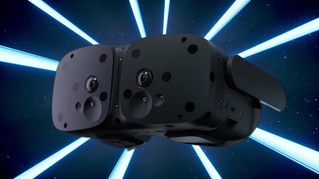

StarVR uses (stacked) fresnel lenses, not aspheric. I yet have to see a headset with aspheric lenses with perfectly stable geometry. I think it’s impossible.

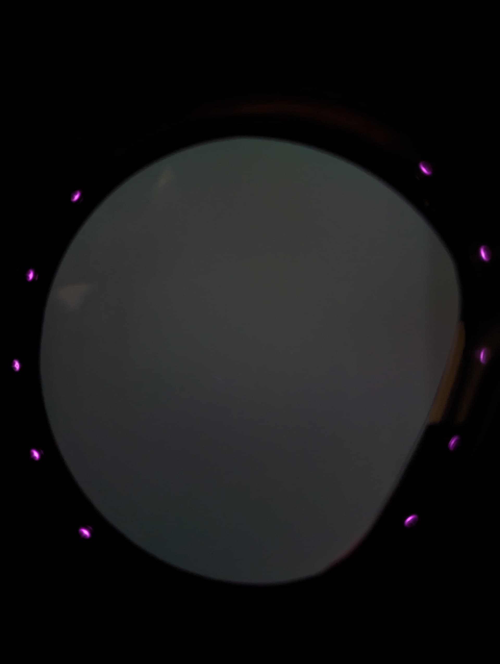

My Pimax Crystal has aspherical glass lenses, these don’t exhibit any glare or reflection artifacts, but do show chromatic aberration especially in overlays, or the steamVR chaperone. Also get some geometric distortion which can cause pupil swim unless looking forward and turning head instead of looking widely across the field of view. Found eye tracking with dynamic foveated rendering made a big improvement for performance and optical stability making it more comfortable to wear.
Get a good field of view slightly less than Index especially vertical, sweet spot like Index seems relatively small but easier to set incorrectly due to overall lens clarity - with Fresnel you can use a high contrast scene and godrays to make useful adjustment!
My time with Almalence digital lens software demonstrated the improvement of dynamic pupil as I’m aware your pupil can move 3mm across it’s range which has big impact on optical comfort, in my experience the aspherical seem less stable, if I remember Valve talked about using Fresnel because it supported a wider range of users making for a comfortable experience.
