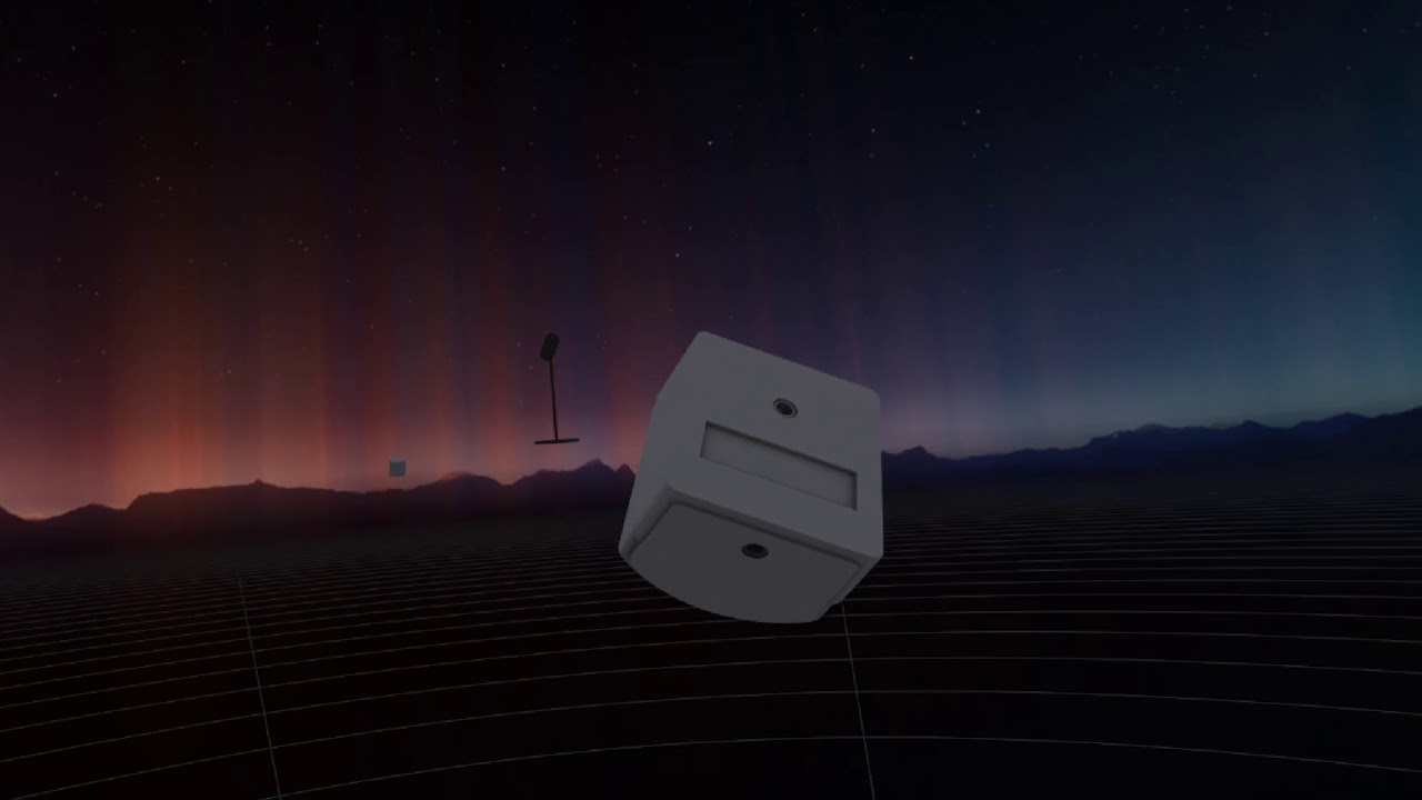

I’m having the same issue with the wands and pimax 8k+.
Tracking issues, sometimes one wand differently jump to the roof… And stupidly remains floating up in the air.
