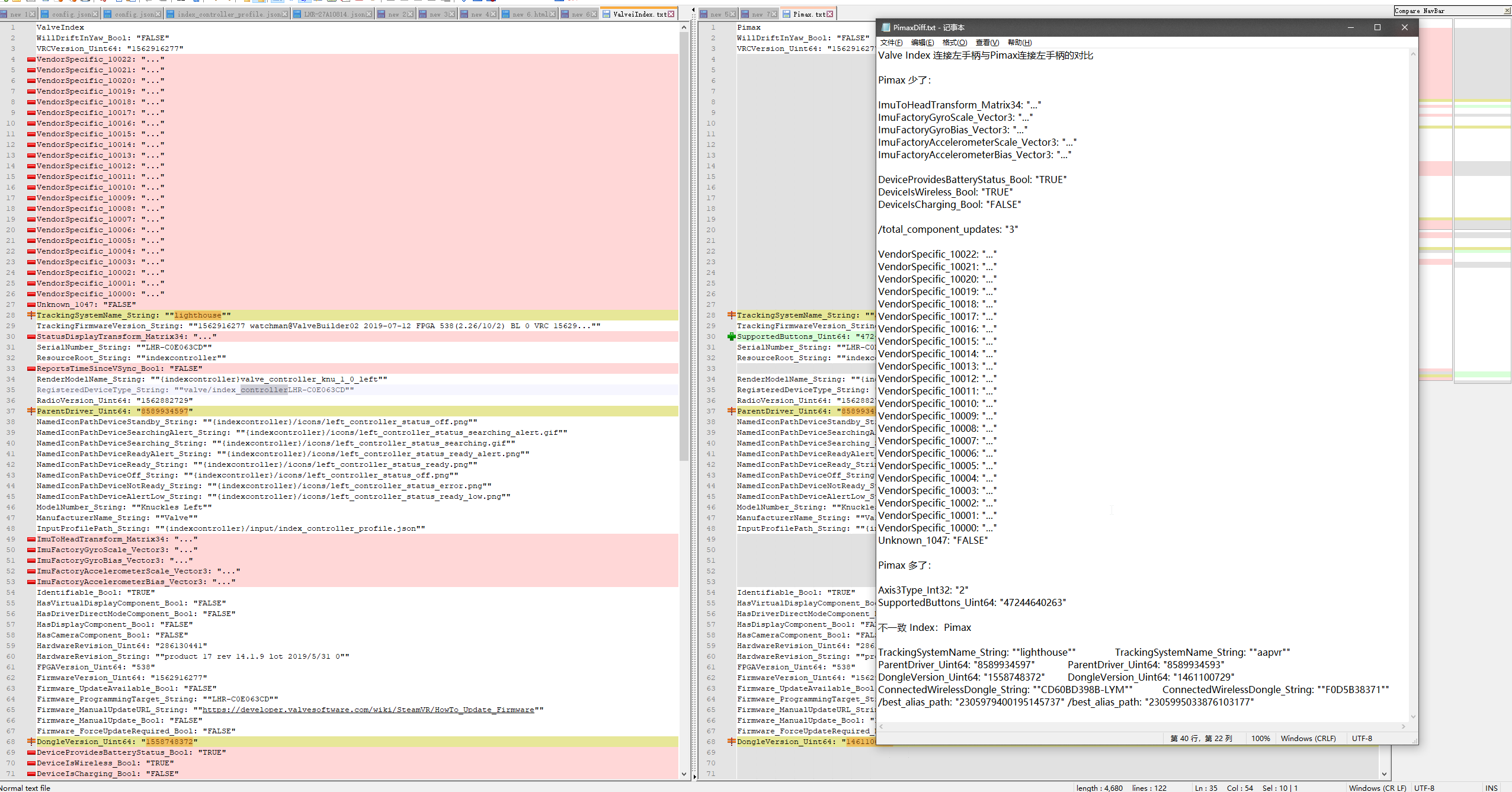

Some controller Compatibility issues with Index controller (Some Info)
I have done some investigate.
That’s some result.
Pimax Lost(or mismatch) some info report to steamvr.
That’s why we had some Compatibility issues with valve index controllers in some games.
I have only compare left hand.
That’s alot Differences…

Diff
Valve Index 连接左手柄与Pimax连接左手柄的对比
Pimax 少了:
ImuToHeadTransform_Matrix34: “…”
ImuFactoryGyroScale_Vector3: “…”
ImuFactoryGyroBias_Vector3: “…”
ImuFactoryAccelerometerScale_Vector3: “…”
ImuFactoryAccelerometerBias_Vector3: “…”
DeviceProvidesBatteryStatus_Bool: “TRUE”
DeviceIsWireless_Bool: “TRUE”
DeviceIsCharging_Bool: “FALSE”
/total_component_updates: “3”
VendorSpecific_10022: “…”
VendorSpecific_10021: “…”
VendorSpecific_10020: “…”
VendorSpecific_10019: “…”
VendorSpecific_10018: “…”
VendorSpecific_10017: “…”
VendorSpecific_10016: “…”
VendorSpecific_10015: “…”
VendorSpecific_10014: “…”
VendorSpecific_10013: “…”
VendorSpecific_10012: “…”
VendorSpecific_10011: “…”
VendorSpecific_10010: “…”
VendorSpecific_10009: “…”
VendorSpecific_10008: “…”
VendorSpecific_10007: “…”
VendorSpecific_10006: “…”
VendorSpecific_10005: “…”
VendorSpecific_10004: “…”
VendorSpecific_10003: “…”
VendorSpecific_10002: “…”
VendorSpecific_10001: “…”
VendorSpecific_10000: “…”
Unknown_1047: “FALSE”
Pimax 多了:
SupportedButtons_Uint64: “47244640263”
不一致 Index:Pimax
Axis3Type_Int32: “0”
Axis3Type_Int32: “2”
TrackingSystemName_String: ““lighthouse””
TrackingSystemName_String: ““aapvr””
ParentDriver_Uint64: “8589934597”
ParentDriver_Uint64: “8589934593”
DongleVersion_Uint64: “1558748372”
DongleVersion_Uint64: “1461100729”
ConnectedWirelessDongle_String: ““CD60BD398B-LYM””
ConnectedWirelessDongle_String: "“F0D5B38371"”
/best_alias_path: “2305979400195145737”
/best_alias_path: “2305995033876103177”
Try Fix this Pimax
@Matthew.Xu @Heliosurge @SweViver @anon57422158 @Konger @PimaxVR @Alex.liu @Doman.Chen

@Alex.liu @PimaxQuorra
I just wanted to chime in on this issue. I can’t play with my index controllers at all. The left hand twitches and wigs out often, dropping grip and guns etc. I hope they can fix this soon.
Pardon my lack of geek on this. What seems to be the issue?
My Index controllers work fine (especially in Oculus games where Pitool is running.
When using them in SVR, they also seem to work fine as much as features are supported. This whether I have pitool running or not.
The only issue, I have encountered to date is the left stick was off alignment in Boneworks only, but that game has it’s own calibration settings which resolved the issue.
Games I am playing with Index controllers:

I haven’t thoroughly vetted all these with ICs, but have tested functionality with them and they seem fine. What should I be looking for?
This is all in response to the newer versions of PiTool. I was able to find an earlier version of PiTool and it fixed these issues. If you haven’t been using the versions of PiTool that came out January/February, you likely never experienced this issue or the jittering visuals issue. I also don’t understand what you mean by “This is whether I have pitool running or not.”. No Pimax headset will work at all if PiTool isn’t running.
Wooties, that is the exact same issue I’ve been having. If I just rest my left arm at my side, its like it looses all tracking. And I use my VR set up in a number of different play spaces and it is always the same.

I had the same issue with my left index controller, specially if it’s not right in front of my body.
the first pair of index controllers did this, plus some hardware issues and had them RMA’D, The new ones still do the same thing(if i put the controllers to my side, it losses tracking sometimes no matter what i do).
i am on the latest pitool .254 Alpha(tried others but same thing, even after deleting ALL Pitool/pimax folders in appdata, and moving my lighthouses 1.0 to different locations up on the wall, plus just trying to use only 1 of my 1.0 LH).
Not sure what is going on really, could be something with our HMD headsets.
Like, if it’s under the HMD it will start acting up or something…
Yeah, turns out my solution only worked for about a day. Now my problem is even worse. Its dropping the left controller worse than it was before and the headset itself now just decides to have an earth quake from time to time. It literally makes me sick to my stomach and everything is unplayable.
