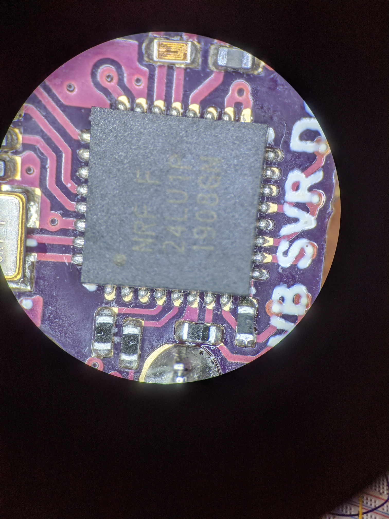

However, although the oshpark purple gets some definite swag points from me, I don’t think the build quality is the best. Clearly missing some wetting on a lot of pads especially on the IC, check this scope shot of the nordic 2.4 GHz transceiver IC. However, on plugging in the PC immediately recognizes it as a watchman dongle. Pairing steps for those interested:

-have fun. 3d print a housing for this poor exposed pcb.
