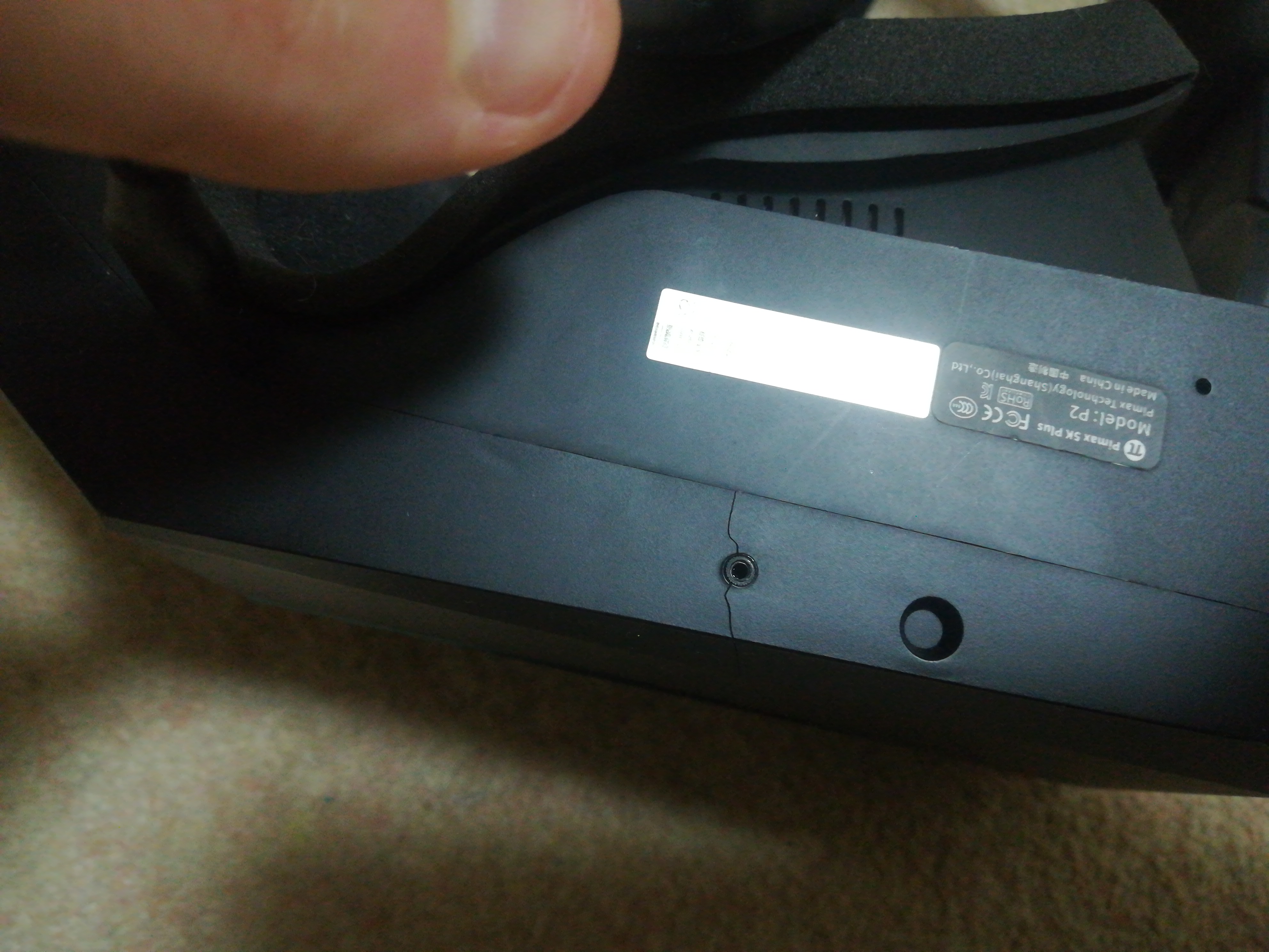

Glad to see this issues has been getting a lot of attention lately while I’ve been busy with college finals. It seems a lot of people are looking into the issue now which is good. Hopefully this is something that can be resolved without having to have everyone send in their headset for repair. (Although I wouldn’t complain as much about having to send my headset in for this issue as much now that the plastic shell of my headset has developed cracks in it while my headset has just been sitting there not being used while we have been trying to sort out this issue.)

I have a question: that screw that you attached to the headset, was it part of the headset or not? I don’t have it on my Pimax:
I had the screw already, didn’t come with the headset, but looks like you’ve got a pretty big crack there.
Might want to contact support, they have been giving out the silicon covers/doing rma to people with cracks
My first unit started cracking at that exact spot and it started going up the front. I got it exchanged and the new one’s been fine, though I haven’t been playing as much VR lately
