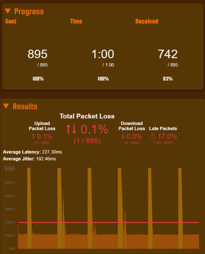

Just too state - I have been pulling my hair out with huge lagspikes every 10 seconds lasting 3 seconds and finally discovered that pitool is the culprit. I am running .180 beta & the issue is also present in the new .197 pitool. I am using a Maximus X Code motherboard’s in-built wifi (drivers updated). This issue can be replicated with any wifi network, and goes away as soon as I close pitool. This is a screenshot of packetlosstest.com while pitool is running:
Can you check if there is any network activity originated in PiTool in the time periods when the comm is blocked? (Like running a sniffer on the wifi interface?)
