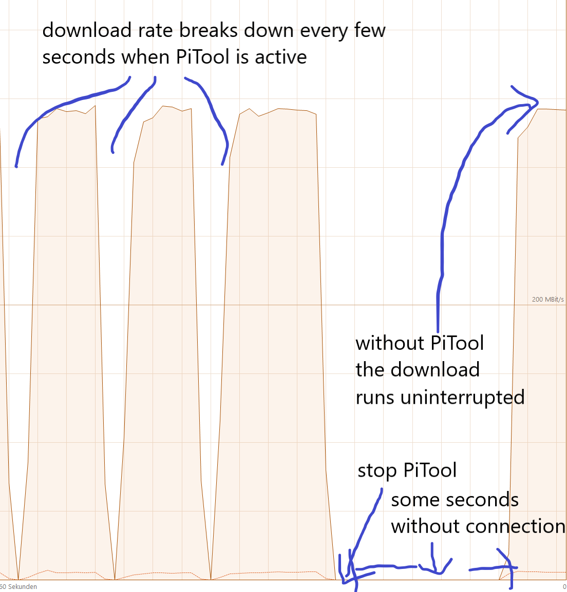

PiTool killing WiFi every 6 or 7 seconds

Just retried it with the current PiTool, I even get the effect when no Pimax headset is connected.
As soon as PiTool exits the data transfer stops completely for a few seconds and then the download continues with a steady rate.

I still feel as if this is a software issue considering it happens without the headset plugged in and powered.
Even if the result of this is ‘don’t use usb wifi’, there’s no reason pitool has any effect on USB in general without a device being communicated with

FYI I have this same issue with my asus maximus X code motherboard, I posted about it late last year - I had to run ethernet through my house and have not turned the WiFi back on since. The exact same network activity pattern as above only when pitool runs
Well I would have to agree some are having a software issue. If no headset is plugged in/on and pitool running is causing network issues proven by killing pitool issue is resolved. Then something in pitool is interfering with some setups.

Interesting part is also that the problem only occurs with PiTool running, using Pimax headsets with the PiTool closed leads to no issues with WIFI. I would understand if the drivers or services would require some high prio threads in order to guarantee a steady framerate. But PiTool is just a configuration tool.
I am pretty convinced that the current behavior isn’t a necessity and could be solved better.
