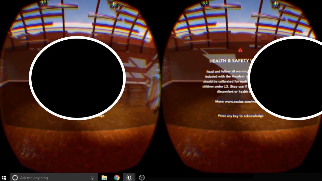

For double check and I need confirm: I use openXR Toolkit, and testing there for foveated rendering and CULL out the gaze area (mask it out) my right eye gaze area shifted with 30-40degrees to the outside, and by this the sharp areas are not matching with the two eyes. I see something like this:
this is just an illustration. Do you have it symmetrical?
And for this case the right eye is not sharp
