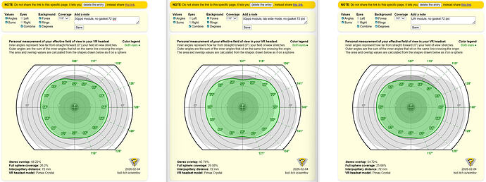

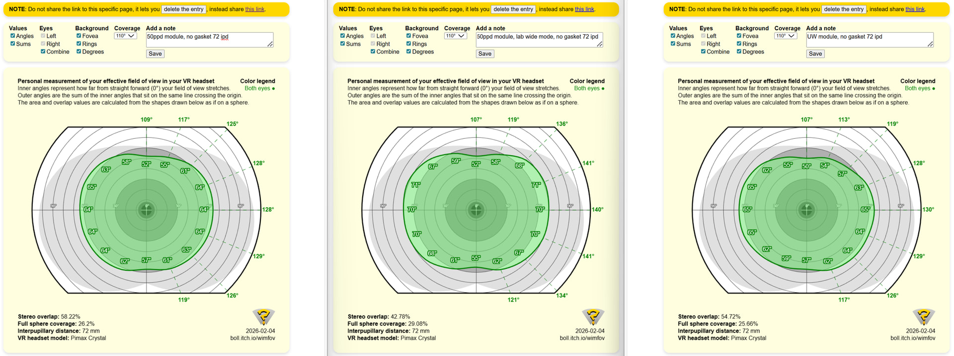

Thanks, that’s what I did for the 3 measurements I posted above. ( I did read your original post which made me want to check that out as well, no interface at all, eyes as close as they can go, IPD maxed at 72.) You are correct in that the FOV is significantly affected by distance of the eyes to the lenses, I can gain about 10 degrees of FOV vs. wearing it normally but I also see those same gains with the standard 50ppd as I do with the UW. 120 for both worn normally and almost 130 for both with my eyes as close as possible. Shouldn’t the UW be wider though if I keep everything else the same? That’s what I’m trying to find out.
Then with lab mode on the 50 it goes from 128 worn normally to 140 with no gasket, 72 IPD, so I get an even slightly bigger gain for the 50 in lab mode doing that (+12) vs. the UW or 50ppd in their normal modes (both +10). Every test I’ve done has the lab mode of the 50ppd producing a wider FOV than the normal mode of UW module and the FOV of both the 50ppd and UW in their normal modes measuring almost the same.
So, is that to be expected? Does anyone get a wider FOV with the UW than they do with the 50ppd in the lab wide mode? Otherwise for me the UW and 50ppd are virtually the same FOV in every test and the lab mode is always at least 8 and up to 12 degrees wider than both so is that an indication of a problem with the UW module or is that as it should be by design?

For me currently it’s #3 by a wide margin (140 lab mode vs. about 130 for both the UW module and the standard 50ppd when both are worn with no interface to get as close as possible, eyelashes brushing the lenses and the IPD maxed at 72, when worn normally but with the thinnest pad and a slightly higher than actual 66 ipd I get 128 lab mode vs. 120 for both the UW and 50ppd in normal modes) and again I ask is that as it should be?

When I put the the 50ppd and UW both in pass-through I see the same physical screen width in front of my eyes, whereas with the 8kx in which I measure 140 FOV wearing glasses for the normal mode I see screen well beyond the rims of my glasses whereas with both the UW and 50ppd the physical screen I see is right even with the edges of my glasses. So is that supposed to be the case or should I see more physical screen with the UW than the 50pp?
If it’s correct that they should appear the same width in passthrough then the difference in FOV is only what the lenses and distortion profile can deliver. The 50ppd has a normal profile HMDQ reported FOV of 127.04 and the lab wide profile which sacrifices stereo overlap to get to 139.05 whereas the UW normal profile is 138.29 according to HMDQ. So can anyone actually see 140 FOV without a profile that reports at least that much to the PC and couldn’t they sacrifice more overlap to get a UW profile at least wider than the lab wide profile of the 50ppd? Maybe not? I’d just like to know to make an informed decision.
The only other way to see more physical screen width in front of my eyes then is to get closer but it seems like maybe the design benefits of the UW are only significant if someone can already get very close to the lenses and naturally see a wider than average FOV. So if you can already see 125 on the 50ppd you’ll see 135 on the UW but if you can only see 115 on the 50ppd you’ll only get around 120 on the UW and if only 105 on the 50ppd you’ll only see 108 on the UW and if you see below 100 with the 50ppd you won’t be able to see the difference at all? That at least would explain why many are seeing about the same FOV with both modules while others can see a clear difference but again that would be good to know when choosing between them if many of us are basically face-shape prevented from getting close enough to see the FOV benefits of the UW vs the 50ppd.
