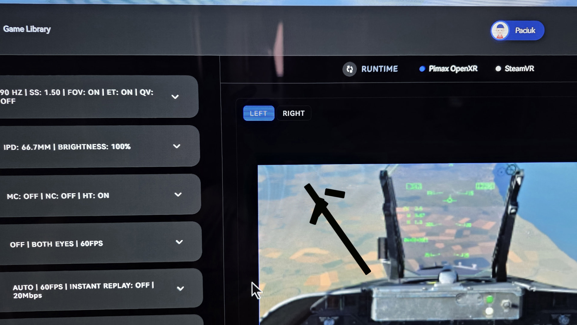

But I have an issue on the left eye where the center area, on the left eye does not have the same brightness than the peripherical région.
(No sharpness)
Do you have the same issue?
(Pimax dream air)
I have the same. Pimax micro oled
En mode lineaire, il semble que je n’ais plus ce soucis.:+1:

In linear mode, it seems that there is no issue anymore.
What is this? LEFT RIGHT
Does it only occur with Quad Views enabled?
Edit: So it’s working now after selecting Linear for the transition setting?
This preview shows how the image will be rendered in the selected eye based on your current settings.
