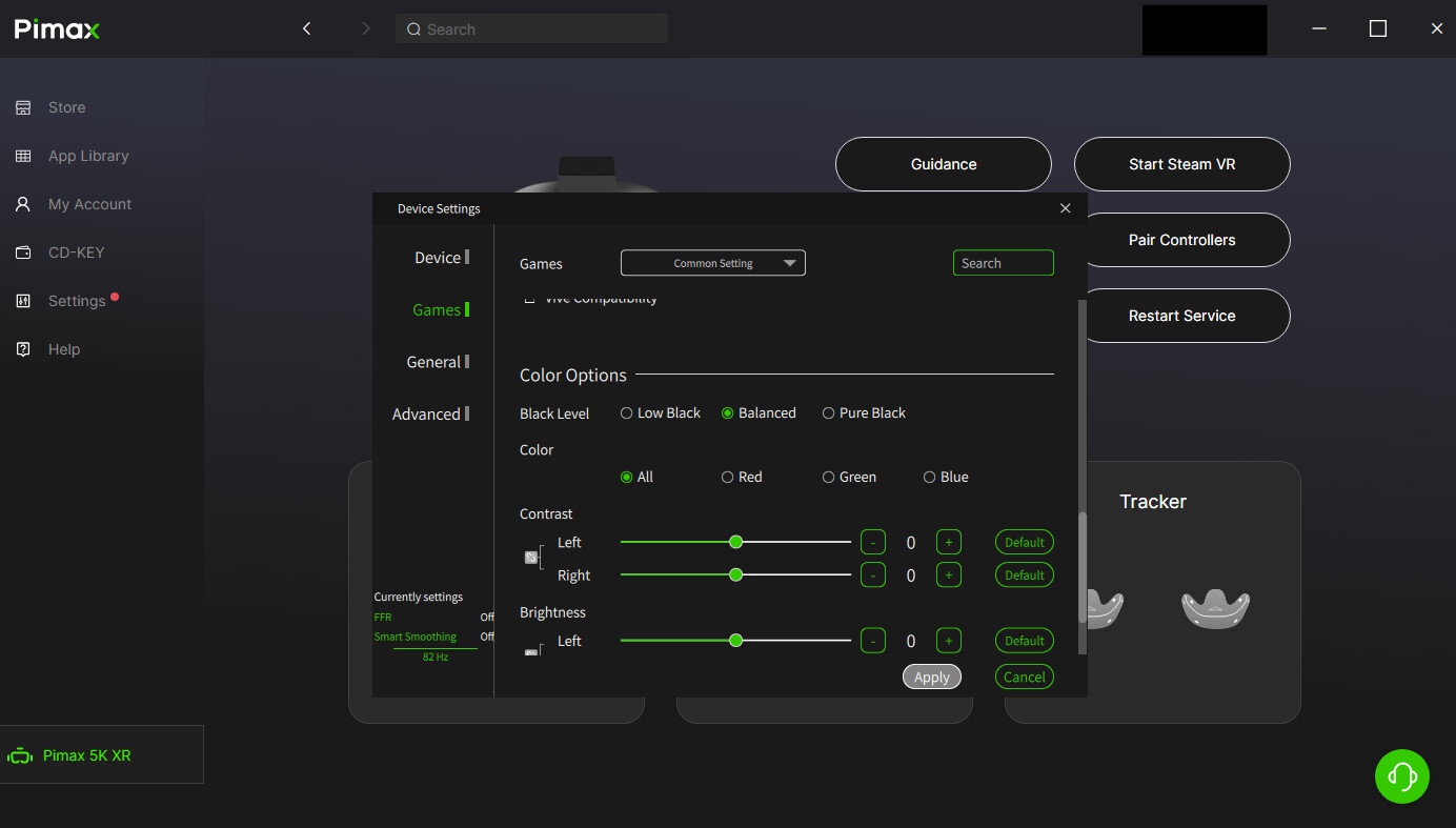

Hi PimaxQuorra,
I setup my 5K XR again and I found the latest Pimax Play is missing the OLED darkness/black adjustment. Everything else seems to work well though.
This setting isn’t currently available in Pimax Play.
Let me check with our development team to see if it can be added in a future update.
If you want to configure the black level, may need to revert back to Pitool.
Actually I am positive it was in the v1.x branch. It must just be missing in 2.x. I just noticed on the download page that v1.x is still available so I will try that.
Yup the OLED black level is present in Pimax Play 1.44.2 so it is only missing from the new 2.0 client.
I’m waiting for the team to provide further input on this.
