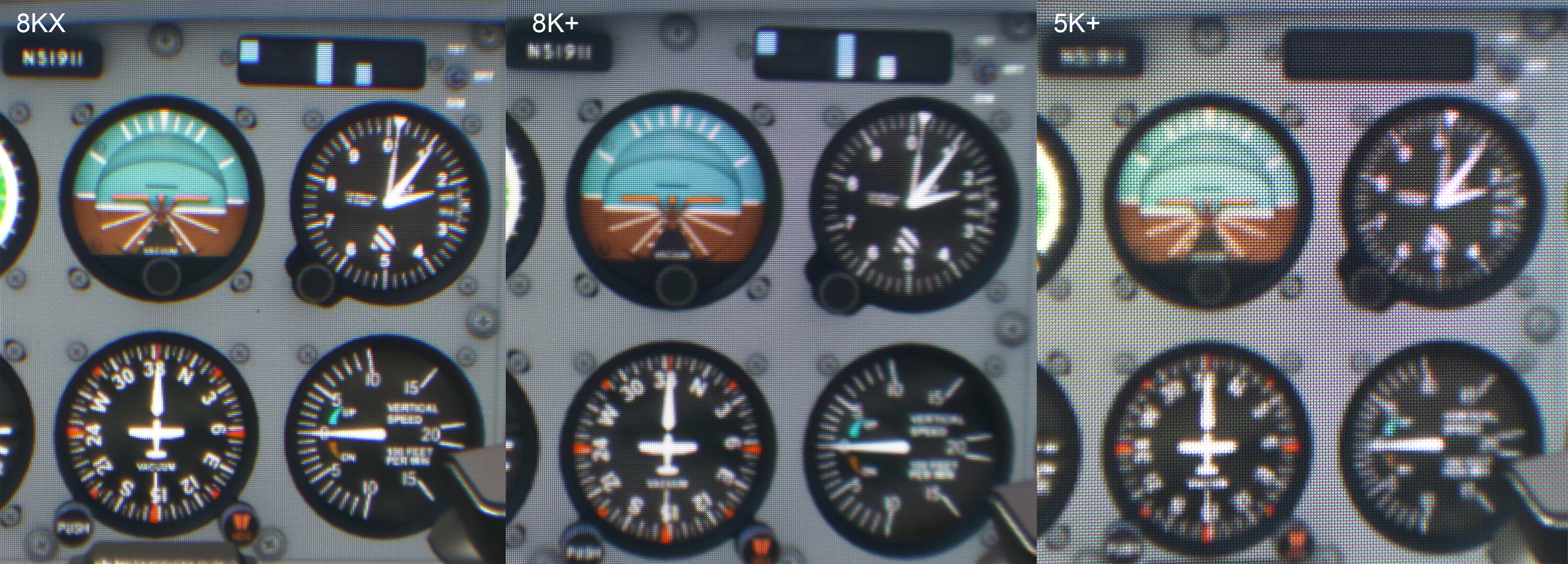

I’m not sure about “blurrier” - I mean, the improved upconversion works really well - sure there isn’t more actual detail, the source image is still 1440p, but a good upconversion algorithm can interpolate between pixels, and can sense edges and things and make them sharper (a bad algorithm can go way overboard with that though).
This is what you get with a really zoomed in image:
If you look at the text plate in the upper-left corner, the text is actually readable on 8K+ but not on 5K+ (but even more readable on 8KX)
It was a painful purchase on the wallet, but I factored in selling my 5K+ once the 8KX arrives. If in a few months I’m able to sell it for $400-500 (with the Vive DAS), I figure it’ll be worth it.
Wow, that is a stunning improvement over the 5K+.
