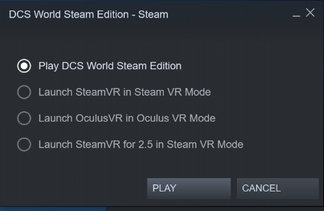

Regarding the Steam launch options, for DCS I get this. Iâm always choosing the first option, and ensuring my headset is off and PiTool is not running.
Regardless, SteamVR and Oculus Store launch anyway. I have found that the 2D version will not quit if I quickly get a mission up and running, but left in the menu, the game will quickly quit back to desktop.

Ha ha yes. The Oculus option is a new one. Having two SteamVR ones seem superfluous, but hey even the 2D option loads SteamVR anyway so that makes three
