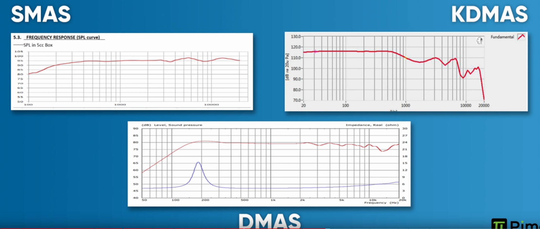

Indeed, in this case DionP’s comments are a mix of blatant nonsense, ridiculously outdated audio design practice, and totally unfounded allegations. Only buzzer devices used where audio quality is totally irrelevant could vary from frequency response charts that much.
My own testing of the SMAS shows Pimax’s frequency response charts are indeed highly accurate. And listening by ear is often the best way to fine tune these things - it’s what the professionals do.
(https://youtu.be/eD38JaCjWwM?t=3307)
Indeed, from the frequency response charts published, I would expect the KDMAS to have excellent bass. Some of the complaints thus far suggest volume is a major problem though, and I would expect the KDMAS not to be as loud as the DMAS?
