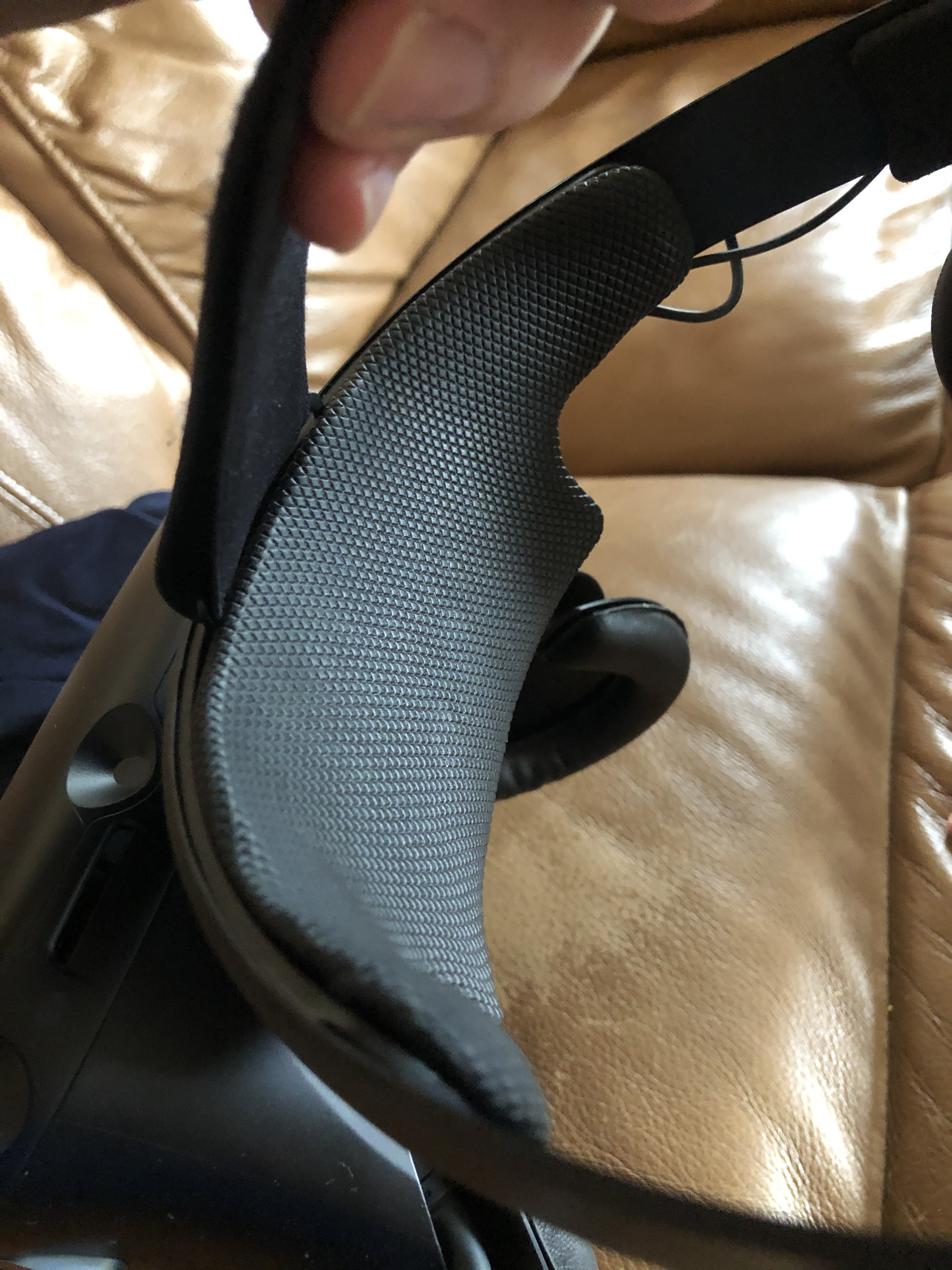

The mod is very easy , should keep the empty lens sockets facing down to stop dust , my only concern with the cosmos mod is the hinge , with the vive/vive pro I could use a thinner face mask literally eyeball to lens and get a good fov but looking at the cosmos that looks a bit tricky to do because of the hinged bit above the eyebrows
Nothing a hacksaw couldn’t fix I suppose ( and yes I would )
Easy fix I changed the side pads and removed 90% of the foam from the centre cushion it improved the FOV immensely. Flip still works and doesn’t wobble like std.
