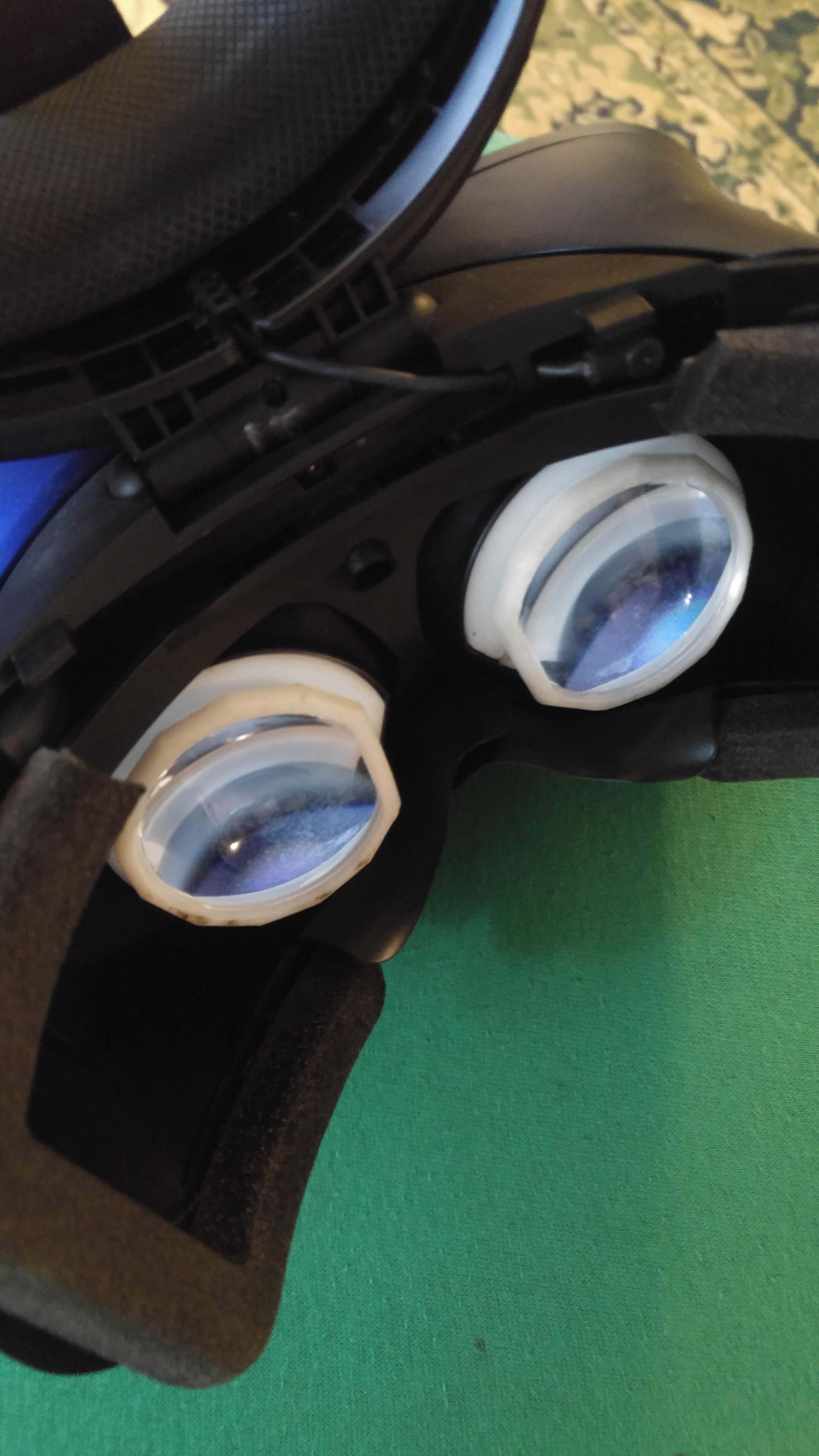

I’m all set up now with the cosmos gear lens mod , I used the (screw in) adjustable focal length adapters to get a nice crisp image without needing +.5 reading glasses.
The vive pro wireless setup works fine with the cosmos , just needed to make a cushion to put under the wireless receiver and get a better battery pack , the cosmos draws more current than the pro .
Using the vive pro as a tethered headset now and sharing it’s controllers with the cosmos with OpenVR-SpaceCalibrator
This looks about 85% as good as the reverb G1 did , just a hint of screen door ( better for me as no glasses required with adjustable ipd ) . I might get the elite faceplate for it so I can use 100% steam tracking ,
The horizontal fov I get is 98 degrees which is fine ( was a 100+ before I used the focal adjust lens adapters)

The vive pro must have a different focal length to the cosmos because i get a focused image with the gear lens in the vive pro but not with the cosmos , hence the adjustable lens adapters .

Where did you get the screw type adjustable adapters?
I 3d printed a standard set for my cosmos but found the distance isnt quite right leaving it out of focus.
Is there somewhere I can download the 3d files?did

Yes I have a copy of the files here , they’ve dissappeared off thingiverse
about 3mb , sent you the link in PM
Awesome thanks very much. I’ll print them tonight
I think he took them down because they’re a bit filmsy , I had to add a slither of plastic bag in the thread to tighten it up and stop it turning too easily
