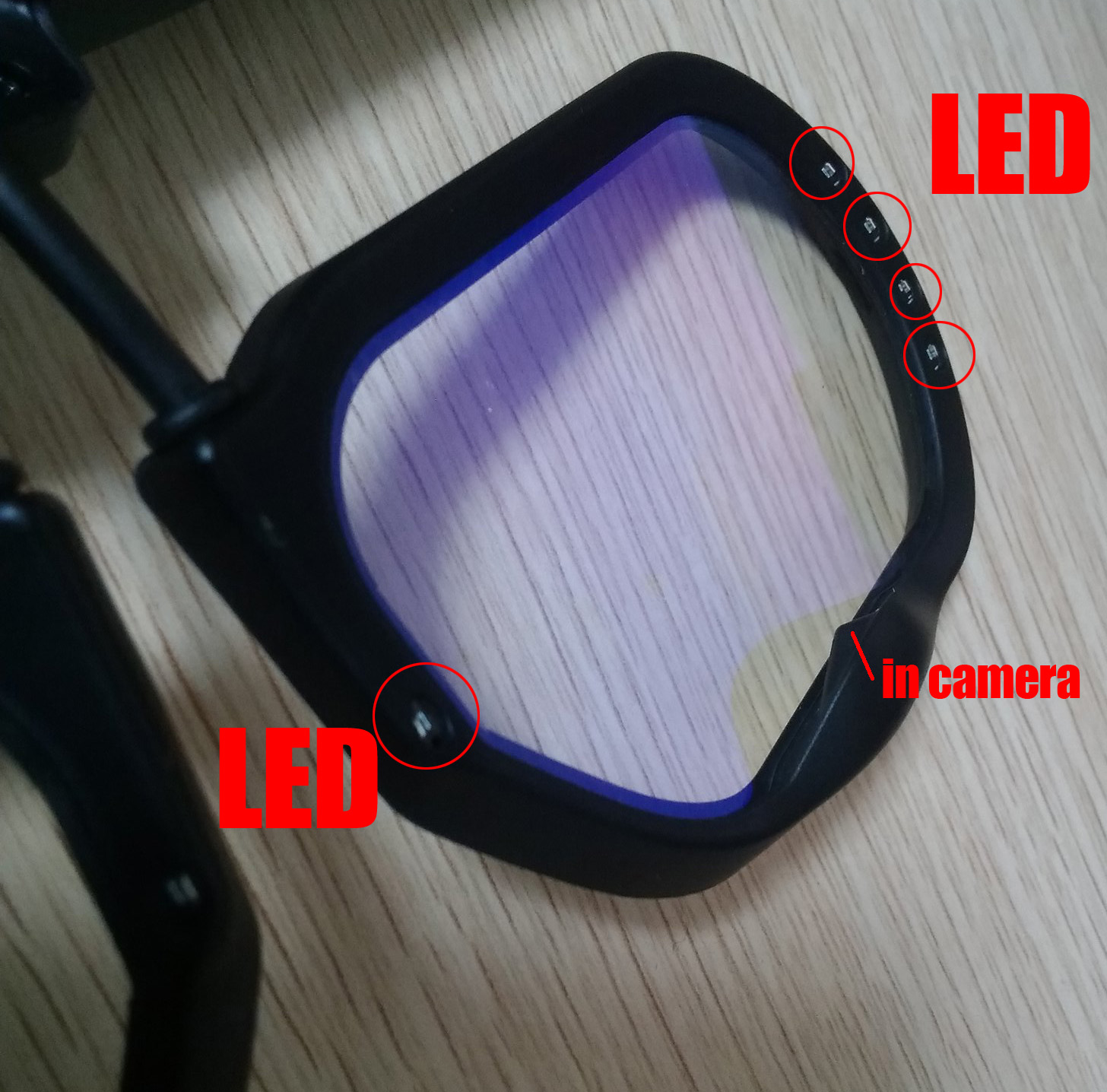

I’m not a technician so I don’t know the details but it’s a photo.
As a mechanism of this module, LED light is emitted, and the faint reflected light is captured by the camera below.
Since the LED is placed right next to the camera and it faces the glass, the glass must have a reflective property.
bounce: LED -> eye -> glass -> camera
Light from the HMD is slightly reflected on the glass, creating a ghost.
Probably about 3% of the light of the entire HMD.
The light is sufficient for the human eye to find it.
Dust and misalignment of the lens will magnify it.
If you can use it in the best conditions, I can agree about 90%.

The back of the silver hardware is a double-sided sticker
Stick the sticker on the lens.

Not a good choice double sided tape. :thinking:
Yeah, adhesive on the lens… But what could they’ve done to engineer the sucker so it moves with the lenses/IPD adjuster…? Tough nut, folks.
edit: The ET could clamp the lenses but the dust cloth is in the way. The Index’s dust rubber design will make it easier for Valve to do just that.
They announced the headset 3 years ago, they announced the eye tracking 3 years ago, maybe it would have been possible for those two companies to talk to each other and in some way design the headset and eye tracking module so that they fitted together in some way without needing glue
its really not rocket science, but since they did both without any consideration it would now need a hardware revision to fix
the lens modules could have had pin holes around the outside, the eye tracking module then has pins that clip in to those holes, job done, there I’m a bloomin genius

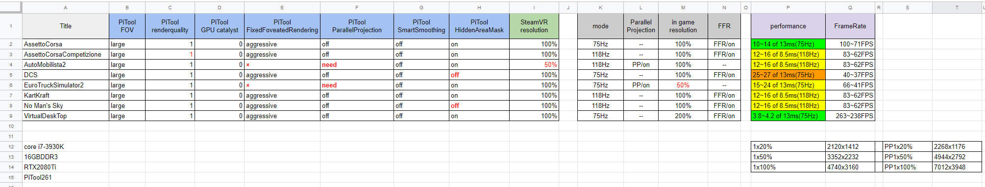

・ACC
If you enjoy racing as a competition, You may need to reduce the resolution.
・DCS
A high frame rate is not required except for Dogfight, so I think it is good to play with high resolution.
The drawing process of DCS is high compared to other titles. But it’s not impossible to play beautifully. With reduce the number of towns, trees and cars.
Please check if you can turn on PP and FFR with rFactor.
(I don’t know that)
While using Parallel Projection increases the rendering resolution and is fatal, ETS2 and AM2 require it.
At the same time, Fixed Foveated Rendering has no effect, so it increese costs more.
(Old titles may need it.)
The upscale high rate mode has faster response speed, but the resolution is slightly lower, so jaggies appear.
And the display feels dark about 5-10%.
You should use it in titles that need fast action, such as F1 and Kart.
By removing unnecessary filters and objects, you can play around 60 to 90 FPS. Beautiful, wonderful and playable enough.
my basic settings and perfomances
