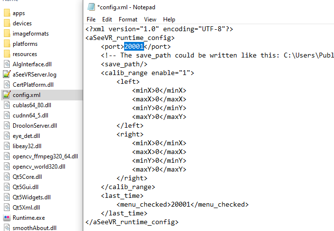

if you have trouble with the server not connecting, try changing the port of the server.
Edit the config.xml file in the runtime folder. Change the 2001 to something else (20001) and save
Also, change the setting for the forward program: in the forward folder, edit the network.ini file and change the server port to the same number you entered in the other file.
