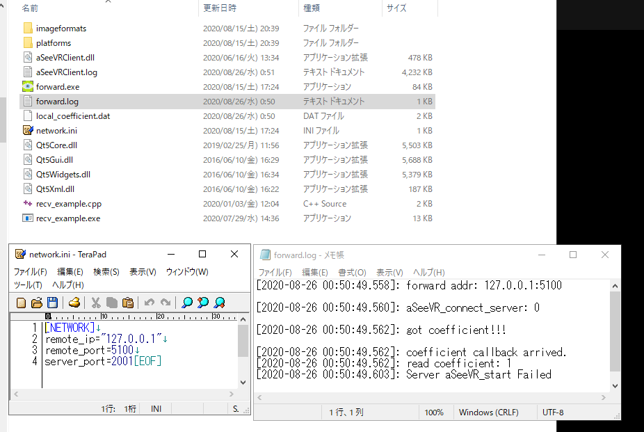

from the forward log
'[2020-08-24 16:49:03.751]: forward addr: 127.0.0.1:5100
[2020-08-24 16:49:04.772]: aSeeVR_connect_server: 0
[2020-08-24 16:49:04.774]: got coefficient!!!
[2020-08-24 16:49:04.774]: coefficient callback arrived.
[2020-08-24 16:49:04.774]: read coefficient: 1
[2020-08-24 16:49:08.607]: Server aSeeVR_start Failed

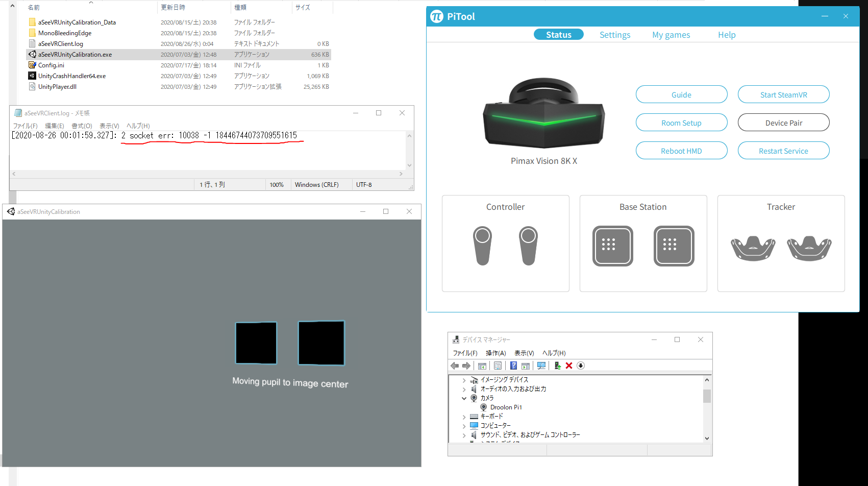

from the aseevrclient file in in calibration
,[2020-08-23 12:17:42.136]: 2 socket err: 10038 -1 2836
[2020-08-23 12:17:42.136]: 2 socket err: 10038 -1 2836,

calibration is not working. socket error?? what is it.
sigh
Could somehow the firewall interfere? Maybe worth a try…
Does it mean that an app called ”forward” that starts at the same time as aSeeVR is making an error trying to establish a connection?

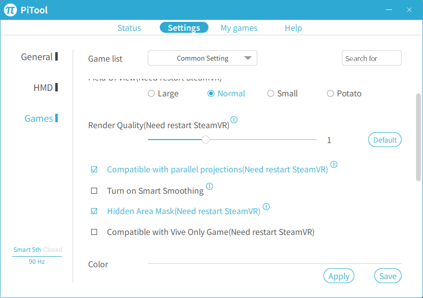

  1. No Fixed Foveated rendering option on my pitool 263, is this normal?

forward log
[2020-08-26 08:28:24.387]: forward addr: 127.0.0.1:5100
[2020-08-26 08:28:24.391]: aSeeVR_connect_server: 0
[2020-08-26 08:28:24.393]: got coefficient!!!
[2020-08-26 08:28:24.393]: coefficient callback arrived.
[2020-08-26 08:28:24.393]: read coefficient: 1
[2020-08-26 08:28:29.241]: Server aSeeVR_start OK
[2020-08-26 08:31:23.422]: call aSeeVR_disconnect_server
