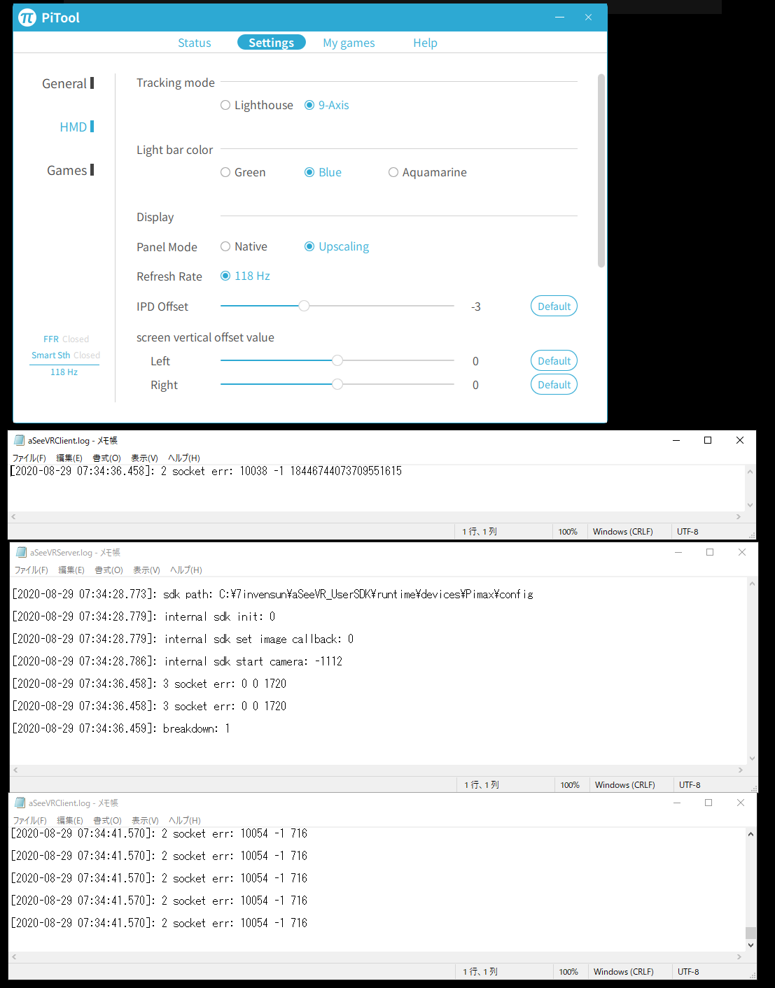

I am an 8KX user and of course use the USB 3.0 port but ET is not working.
I tried various things such as changing the port setting description and giving administrator authority, Upscale mode,but the LED never shines.
ET is not running or the ET server is not running and the software is giving a connection error.

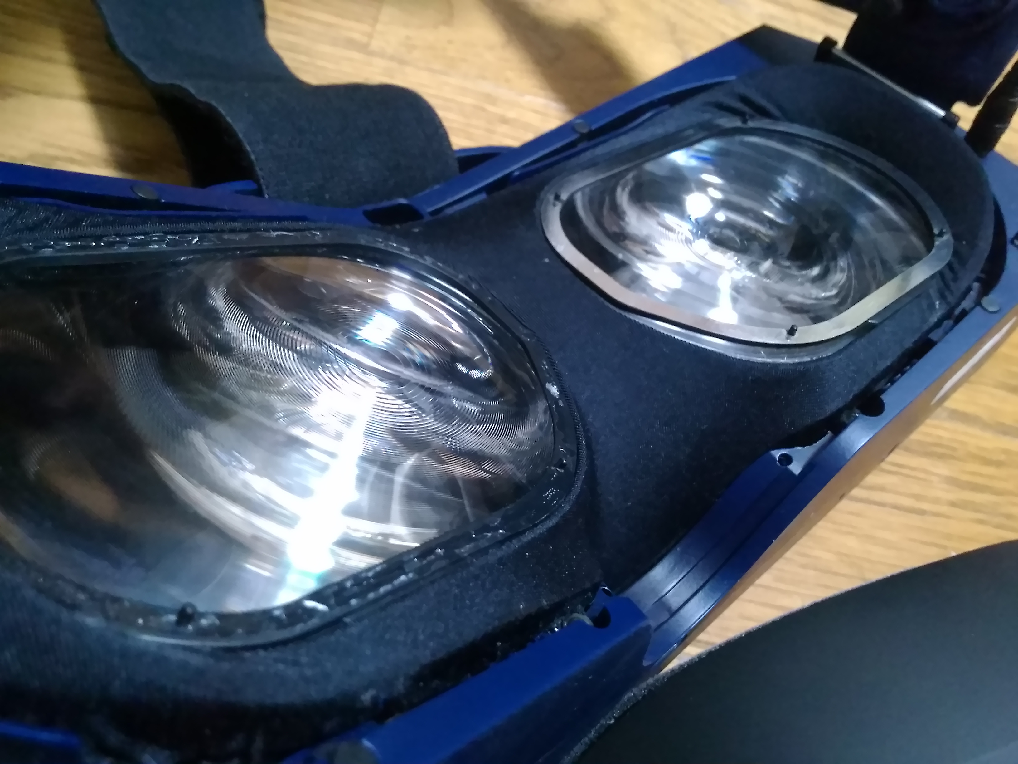

My base ring is broken right and left.
The upper two pins of the left ring were broken.
Also, the silver frame came off.
The right ring loses its holding power on the adhesive surface with the lens and is peeling off.
My IPD is 73 and the IPD dial is always MAX
The two cables in the center have high tension, and I think that the holding power of the ring is lost.
I expanded the top hole, but I’m not sure if that’s enough.
Spare parts will be needed for everyone.
