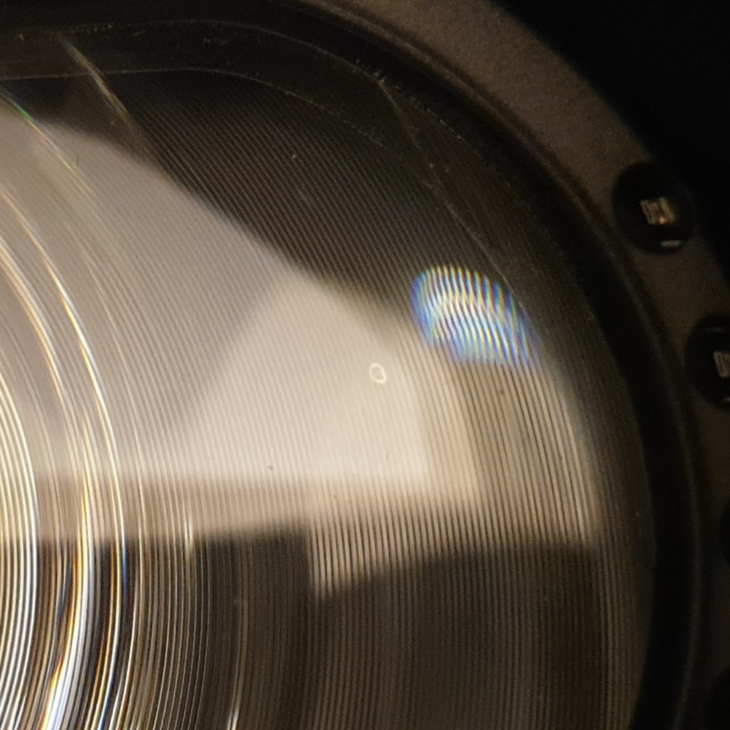

  2. One Eyetracking lens has what looks like a coating defect, meaning a tiny mark is also visible.
I’m not confident what it’ll all look like once I power it up in a week or so. I was planning on writing a detailed revie, but if the visual experience is going to be spoilt it’s probably not worth it as I don’t want to be unfairly negative as it might be a freak event.
Below is image of little mark on Eyetracking glass - slightly right of centre.
And on the headset left lens with Eyetracking removed a tiny scratch is visible (slightly above centre of the image), everything else is dust, fabric particles from cleaning cloth.
As someone new to VR, I’m not sure if these tiny marks will be visible once my eyes are pressed right up to the lenses. Has anyone experienced this with their newly delivered headset/eyetracking?
Thanks.
I also have some of the first defect. I was hoping it was some kind of pull off coating as the issue looks the same as when you have a speck of dirt under a phone glass protector but i dont think it can be removed. Manufacturing definitely was not in a cleanroom of the level it needed to be.
