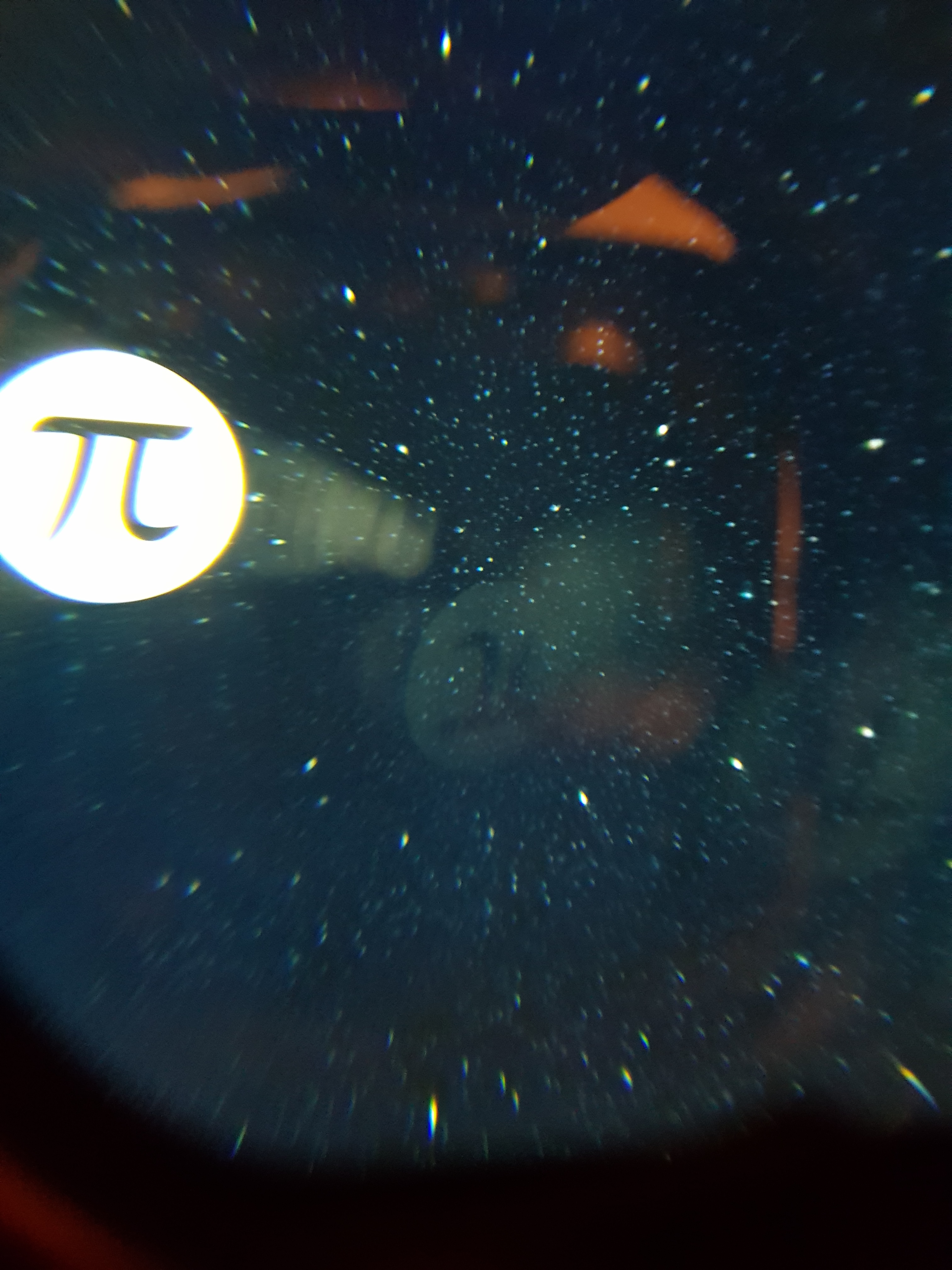

The reflections are definitely there - if you look at the Pimax logo on the splash screen before SteamVR is loaded up, you can see the Pimax logo is reflected and flipped upside down on each of the lenses.
Not…good :crazy_face:
we need an official answer if the plastic lenses are needed in the eyetracker.
Should have been AR coated on the front side (facing the lenses)
That alone makes me think twice if I ever want to install it at all - and it basically kills the product (for me and maybe for others sensitive to image quality… and since we’re all enthusiasts here, who isn’t).

  • Are the lenses on the eye tracking module required? If they are not required, what is the procedure to remove the lenses from the eye tracking module? If they are required, is there anything that can be done to reduce the glare and reflections that appear during use (as seen in the image above)?
