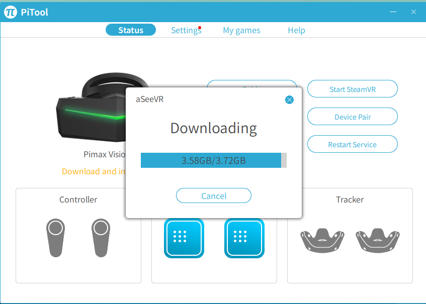

I received my 8KX yesterday and proceeding installing my eye tracker today. As soon as I start installing the software, it keep downloading new file. It is still going at 2.56gb, is this right?
the version i installed last week was 1.0.0.10 and had ~175MB, so yes look unusual and pitool does not suggest me to down load a new version when starting with eyetracking active
3.60gb and is still downloading, anyone has suggestion?
EDIT: I have to close Pitool and reinstall version:264. Must be a bug with PE version and Droolon software. So far the software install ok, then I upgrade PiTool to PE version, but not been able to calibrate. @crony can you elaborate how did you do it? I downloaded the zip file enclosed by @mr.uu, but the file is encrypted with pw.

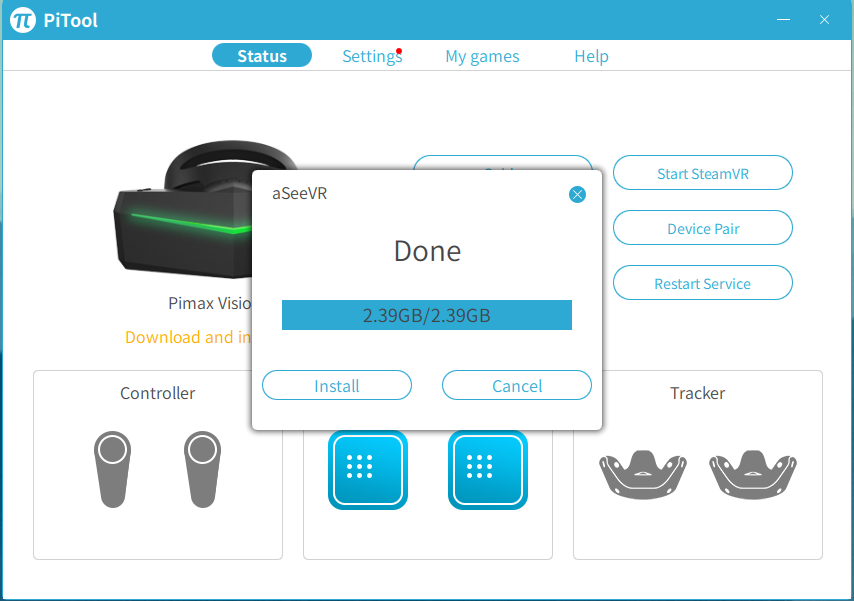

  1. Uninstall previous versions of pitool
  2. Install PiToolSetup_1.0.2.084.exe
  3. Download & Install aSeeVR
  4. Run calibration
    That’s it. ^^…
did not work for me that way with pitool 1.0.1.264
aSeeVR 1.0.0.10 was not detecting the hardware properly without config data from version1.0.0.8 on my system

check the file that was downloaded here
C:\Users%username%\AppData\Local\PiTool
and you can also make a copy and look for the version when looking for the property’s of the file

I have installed PiToolSetup_1.0.2.084.exe not 1.0.1.264 And the pitool version is 1.0.2.084
I just installed and calibrated again and everything is fine.
