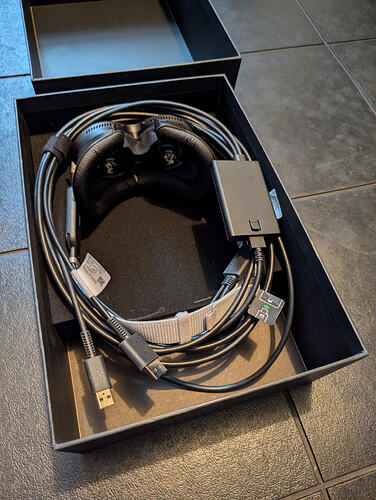

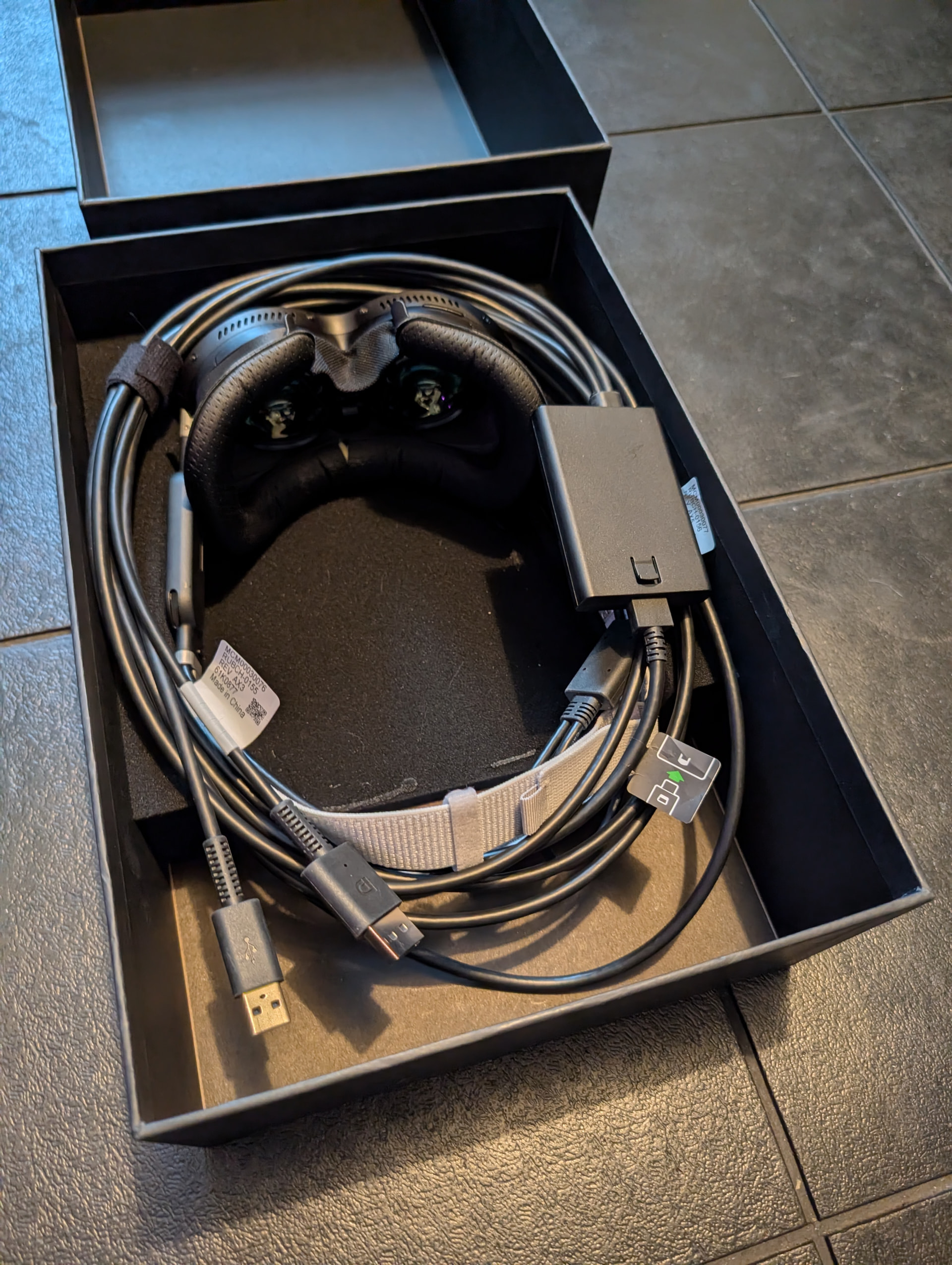

  • Pretty straightforward, although there’s only a quick start guide provided. The first thing I noticed is that there’s two diagrams of the Dream Air SLAM instead of one of the LH version and one of the SLAM - both images are identical and are shown with integrated cameras - @PimaxQuorra
  • The 8KX needed 1 DP and 2 USB ports, whereas the DA requires 1 DP, 1 USB, and 1 power socket.
  • There’s a link to a setup Youtube video, which doesn’t go into much more detail. I was hoping for some eye tracking setup instructions, but that’s actually very simple just from PiPlay.
  • I was hoping to use the auto-IPD feature, as the 8KX had a lot of issues for me, which I could never quite fix even with mods. I was more confident of this one however, as the minimum IPD goes lower. I have a small head and so need around 58-59mm. I realised this feature has been removed, so I set it manually and it’s absolutely fine, thanks to the large sweet spot on the lenses.
  • I feel there should be more initial setup information available for new users - eg it’s fine for me, but I see no information about using Lighthouses etc. An overview for anyone who might be new to VR would be worthwhile.
