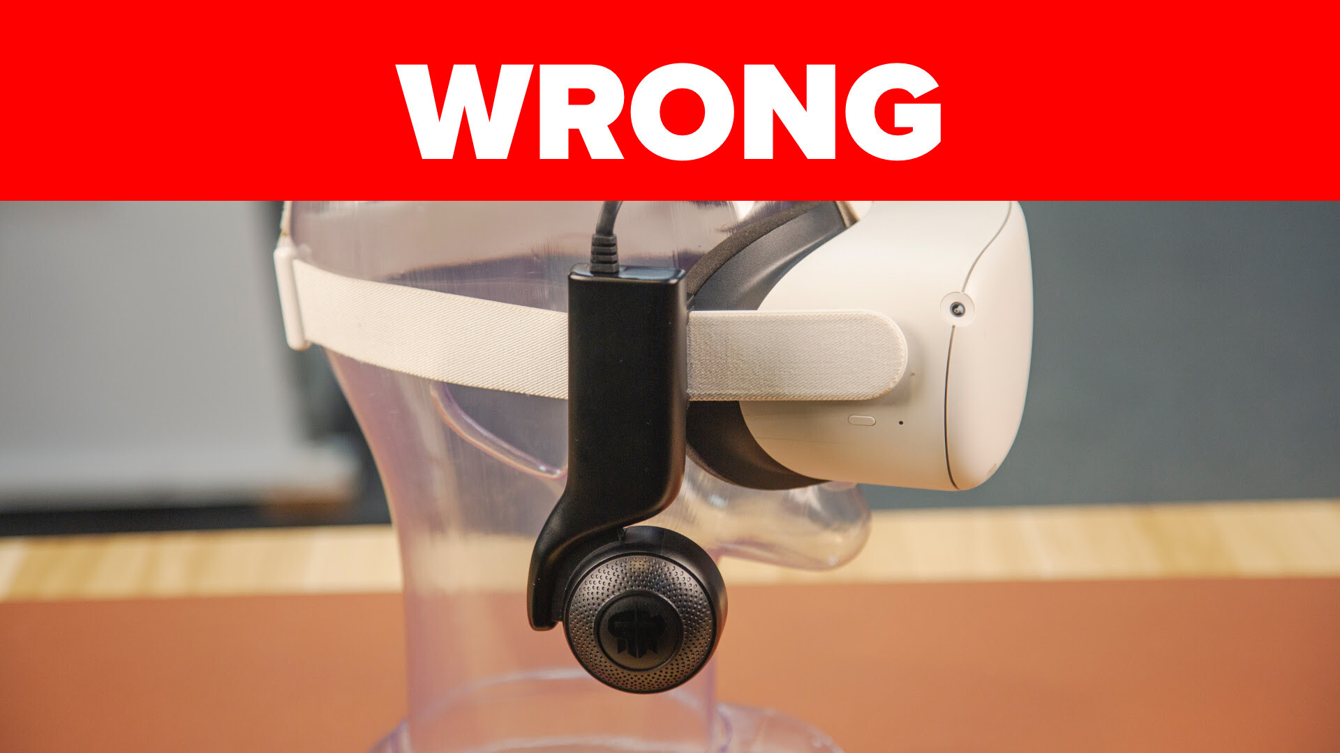

VR Ears are very different than headphones and so is the installation process, we can compare first time setup to that of early consumer drones or high-end speaker monitors. VR Ears does not press against your head and cannot be quickly thrown on and function well. They must be installed, positioned properly, and can take some time to optimize. We wanted them to feel firmly attached to the headset, like they are a part of it, but users could upgrade their next headset with VR Ears far into the future.
This is an example of the incorrect setup position; we can clearly see the clip is placed much too far back on the strap and the speaker is way below where your ear would be. (They think we’re idiots)
Correct setup position, VR Ears is on the 3rd click position and adjusted. LSToast: “they sound way better, comparable to Index but I would say a little lacking on bass…they sound amazing”
We cannot stress enough the importance of closely following the instruction manual and/or watching the video tutorial. The “sweet spot” for optimum audio is fairly narrow, and it is important that you make sure that the center of the speaker driver is positioned directly over your ear canal.

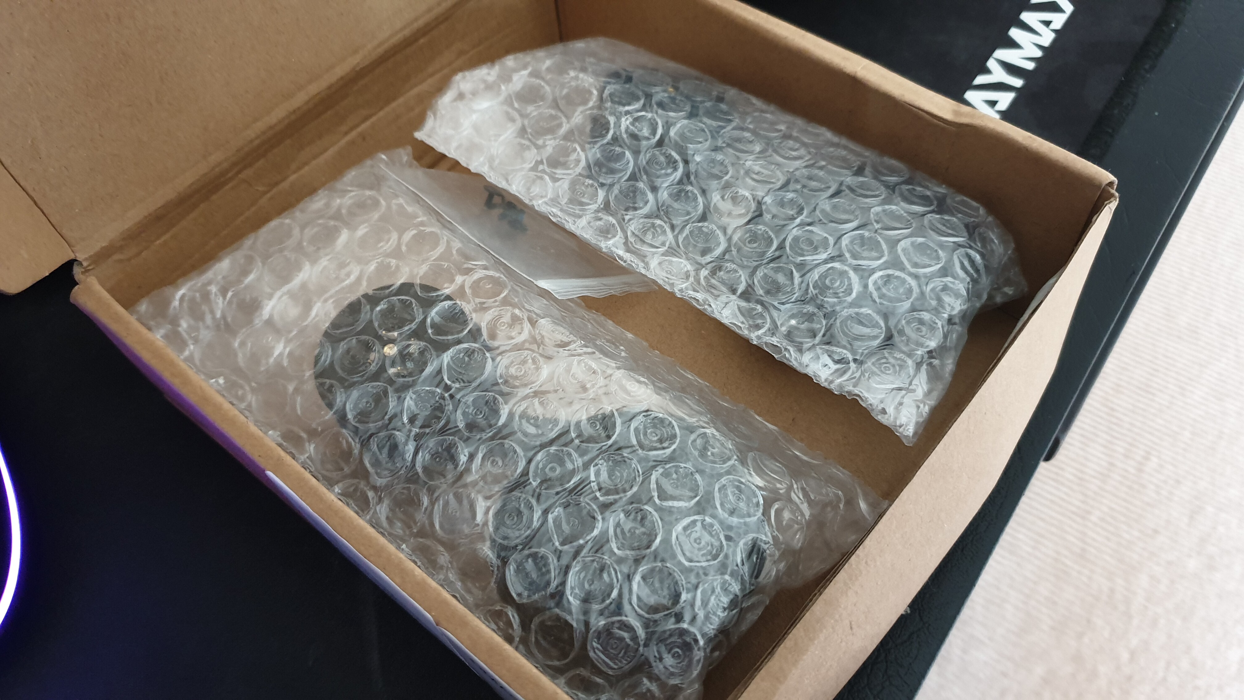

Just received this, going to install it after lunch and a really no frill feedback on how I feel it performs.

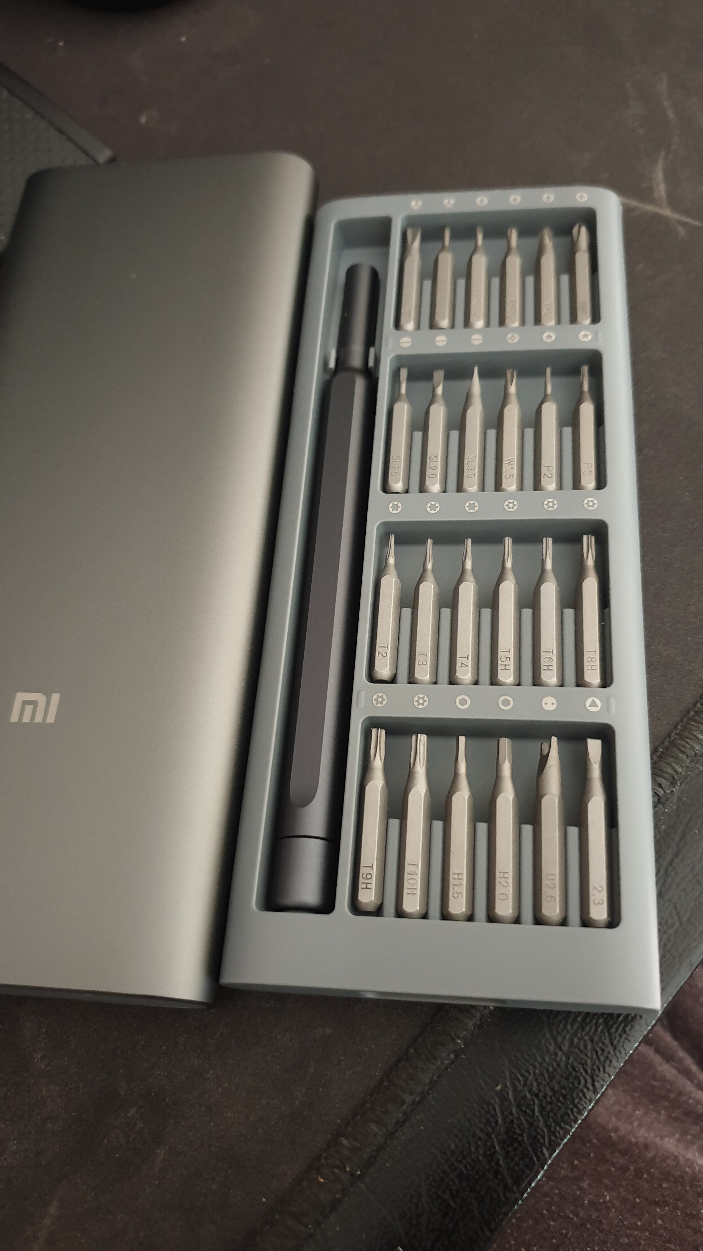

ps. gonna find the world’s tiniest screwdriver first.

It is a ph000

Had to dig mine out of my backer box
lol after some digging no i don’t have the world’s smallest screwdriver and I don’t have a backerbox. Looks like I’ll have to install it a bit later after paying a visit to my brother’s house. Retail shops are still locked down here so buying one is abit of a task at the moment.
Hey pimax, include a tiny screwdriver in the box next time! Not everyone has a screwdriver this tiny! :upside_down_face: for a $100 usd accessory it’s not too much to ask!
But small issue, worst case is borrowing one from my neighbours.

Ok here we go
Pimax should put these in store lol
That looks way nicer than my set! :+1:
Ok here is my impression,
Build quality is top notch, premium material, holds comfortably in the hand, it is a great set of precision set. Would recommend this screwdriver set. :joy:
