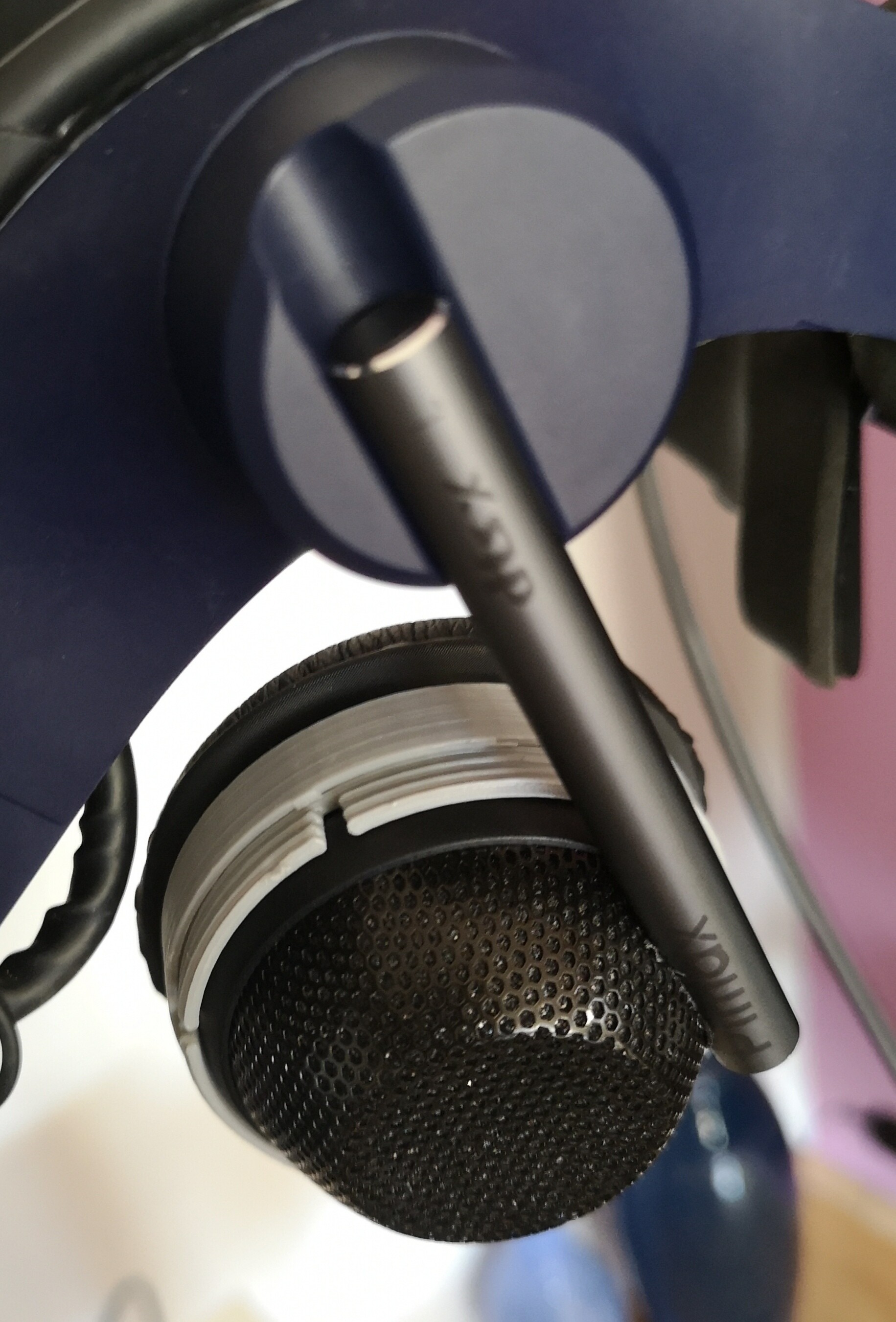

I don’t have the DMAS but could it be that the noises you people are hearing is actually feedback from the noise getting picked up by the microphone because now it’s an open speaker configuration the noise leakage will be a lot more then with the SMAS or KDMAS
And I know you hear it when there is no sound playing but feedback is what you get when the mic is close to the speakers just sharing some thoughts not an expert on hmd audio solutions

I messed a bit around with the DMAS and found that if I only plug the right side speaker into the headset, the sound quality drops drastically, but the annoying sound is gone. As soon as I plug in the left speaker too, the sound goes back to its normal quality, but the noise promptly appears on both speakers. If I only plug in the left speaker, sound quality stays normal but the noise is there too.
Anyone have any idea what is happening here?
