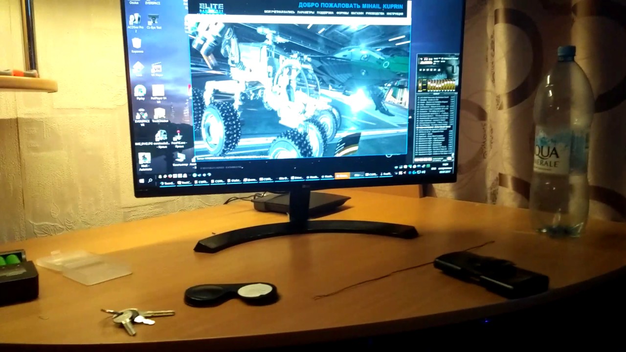

Working:
Do not pay attention to misaligned axles. There were problems with the calibration right now they are not.
Aw sweet. @CReDo, is this with v1.1.92 drivers? Are you using freetrack or opentrack with the Pimax Headset?
I’m using Psmove + Driver4VR and 1.1.92
No matter which driver piplay costs

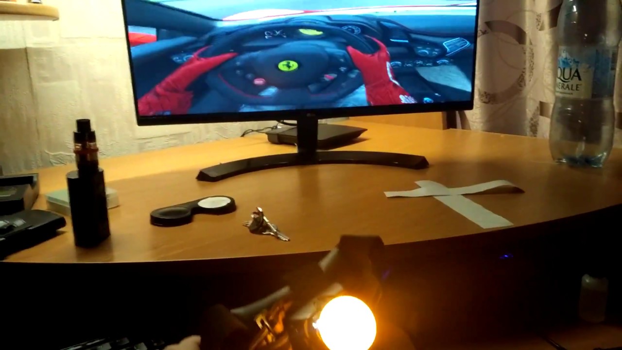

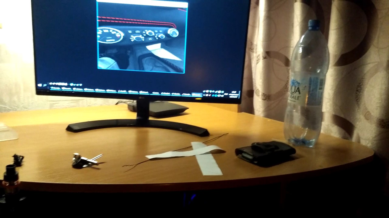

Here is the work in the races:
