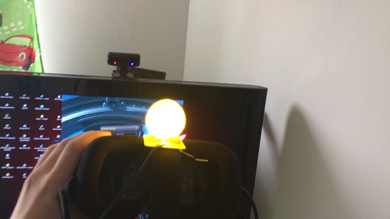

- used PSMove controler & PS3Camera => 10$ [ but PSMove is needed only for first configuration / if you could borrow for a day then only camera = 5$ ]
- driver with full licence - to have all further upgrades without time limit => 8E [ but works in demo mode up to 10 minutes = 0$ ]
- a little PLA plastic for my 3Dprinter => couple of cents [ but a pingpong ball will be more then enough ]
- a 12VLED => 1-2$
- time

I like the solution as it has options and can be done with a pingpong ball [ or something round, probably golf ball, or a PSMove on HMD - better but heavier and inconvinant ] - do not requires a customized specific hardware [ that only one company produces which costs a lot, or is unavailable to purchase ], and I also like it because in general it works

Yes, one camera because I didn`t even know what will happen - will it even work or not [ not many informations online are available ] - but after I made it to cooperate - yes, could add another one, but still as a cockpit user [ as @Oculus uses one tracker in front ] for me to use 2-4 like in YT tutorial will be more problematic [ those wall-mounts in a small room ]. I suppose 2 PS3Camera in front corners could make all posisioning more precise ?
