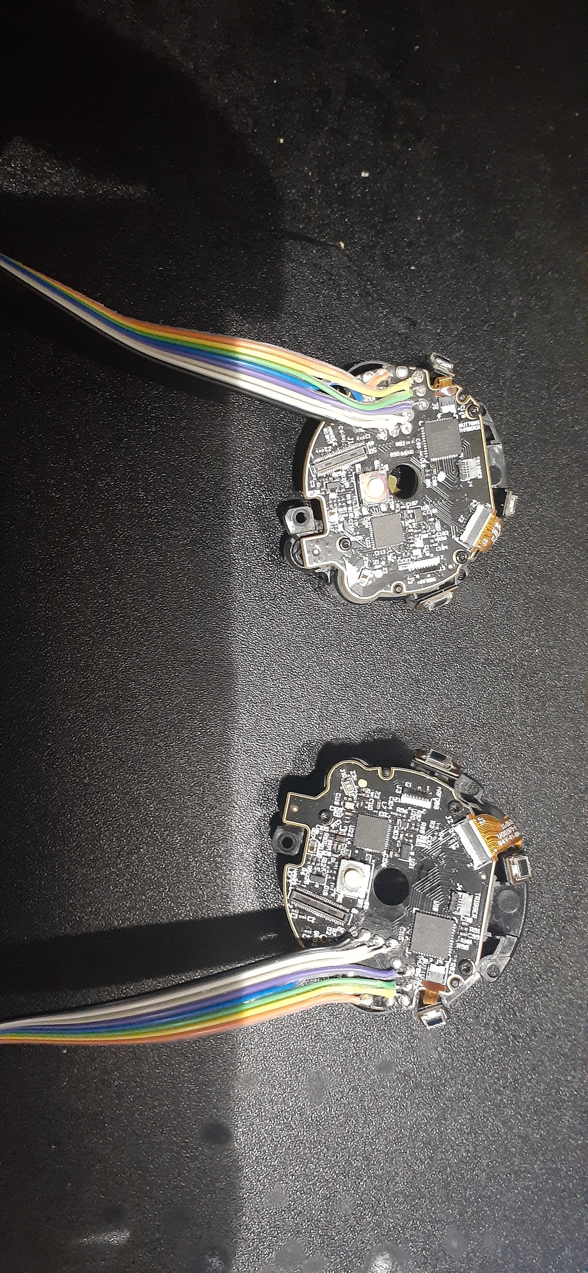

Anyone has a suggestion where we could mount or have wires with connetors pass through in the knuckles, without getting in the way of any ir sensor?
Thanks!

Work in progress for hacking both the quest controller and the valve knuckles controller
Quest controller

Hacked knuckles for using with the arduino based locomotion system.
Tested it and it works!

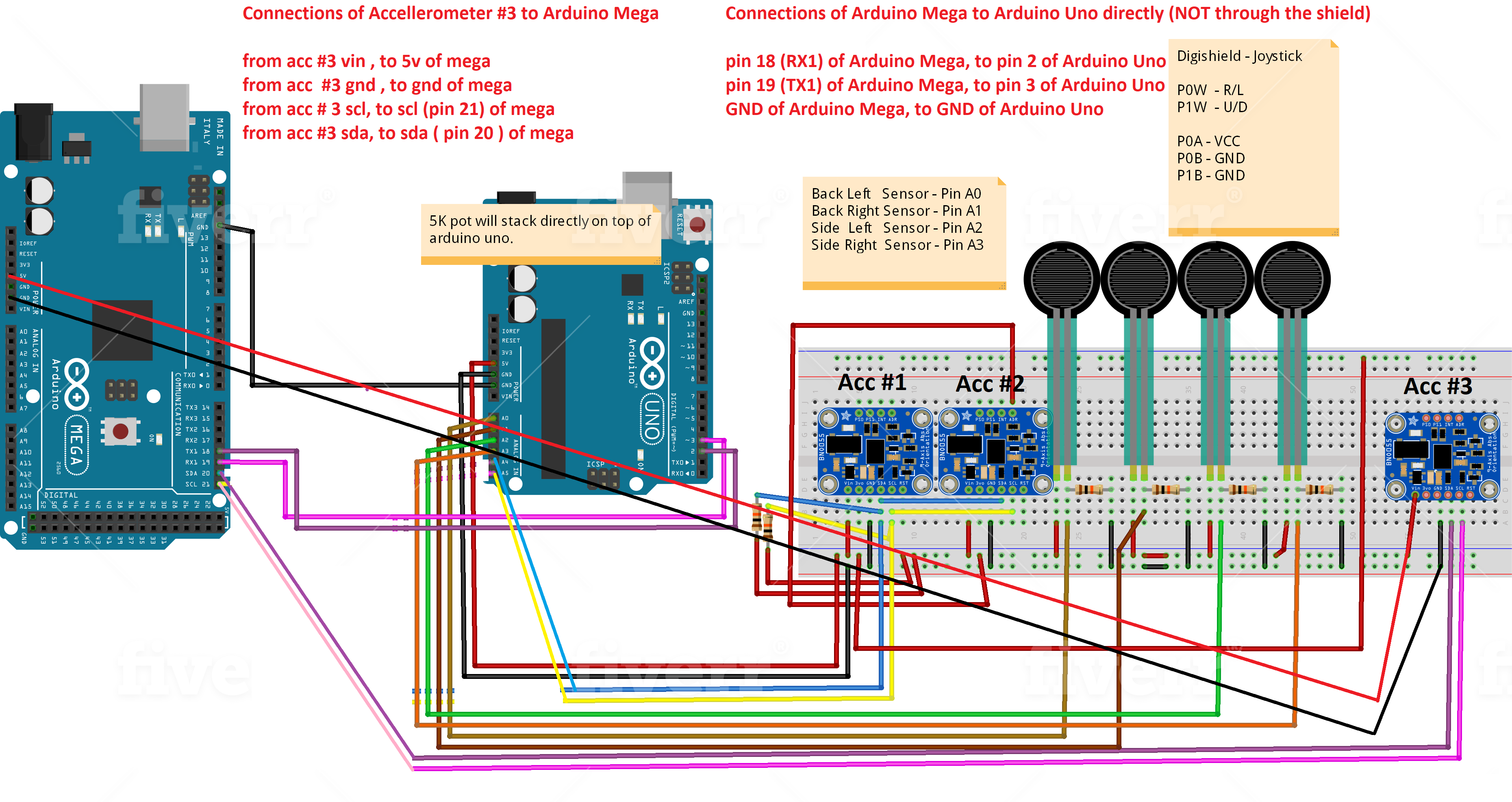

Added the 3dd accelerometer at the chest for different use:
This is how the sensors are going to be used for controllign the joystick/touchpad of controllers for quest, knuckles, xinput ,vive custom controllers , ps4, xbox

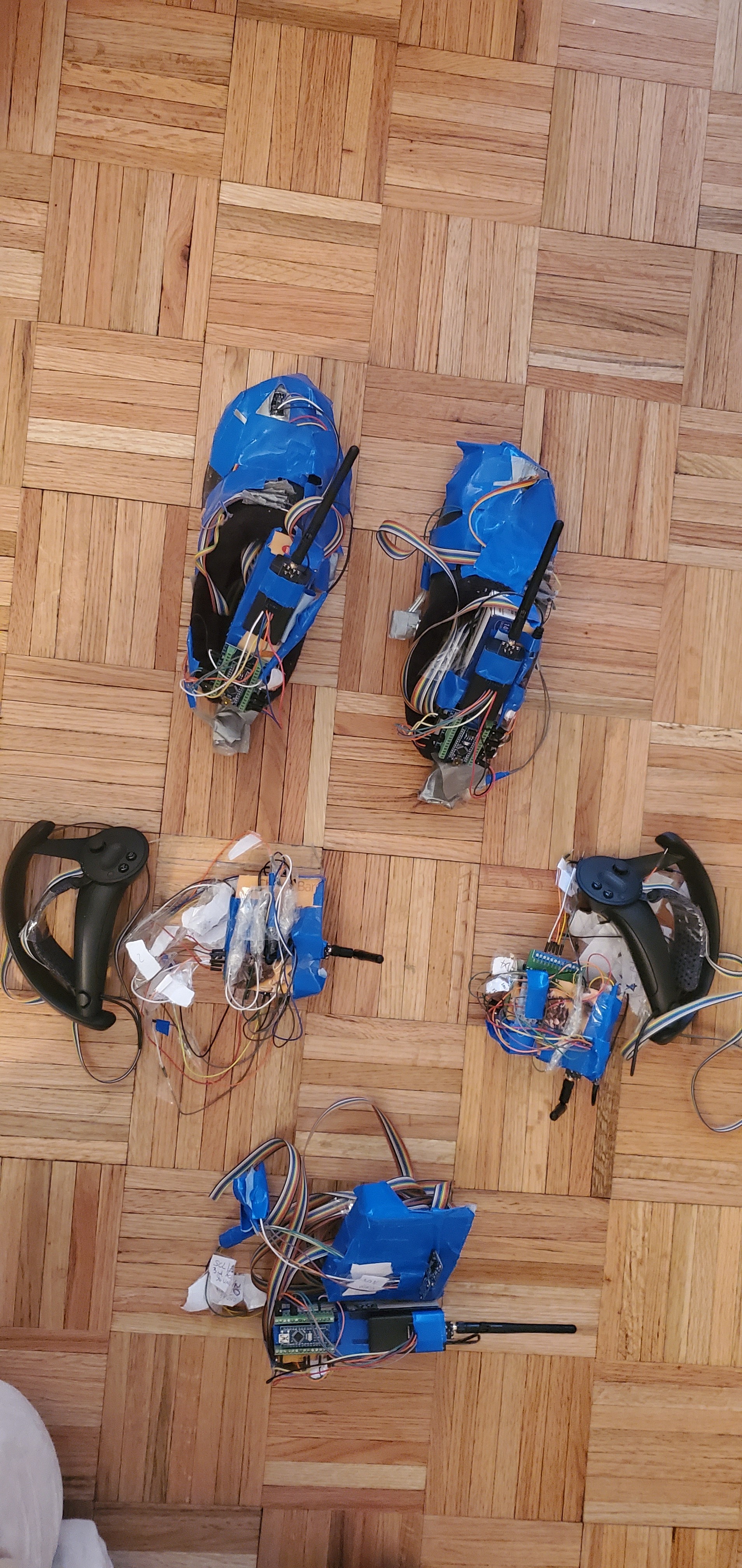

This is the wireless setup sketch/ how the modules will be. Any long wire will be removed to make the system look like more as wireless as katloco , rather than a wired walkovr with wires running around
Testing phase and programming of the 5 wireless nodes.
Right foot node with accelerometer (for walking and running) and pressure sensors (for lateral and backwards movements).
Left foot node with accelerometer (for walking and running) and pressure sensors (for lateral and backwards movements).
chest node with altimiter (for jump and crawl) and accelerometer (for forward, backwards, lateral and diagonal movements , using upper body)
right harm node , for controlling right controller (ps4,xbox, knuckles, quest, custom vive controller, xinput controller)
left harm node , for controlling right controller (ps4,xbox, knuckles, quest, custom vive controller, xinput controller)

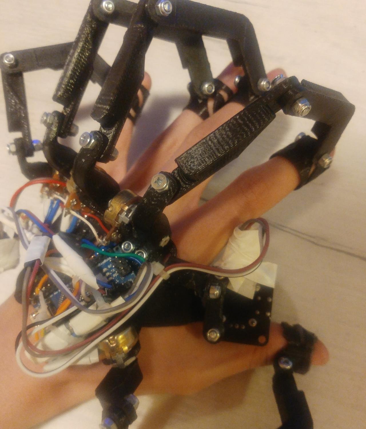

Holy sh***t are you making your own dexmo gloves ?
The hand controller is not my work. It is his work => https://www.reddit.com/user/AkayaKimi/
I hope to add the locomotion to this custom controller, as he was also mentioning about it.
For whatever reason though , his page with the instruction is down and I am not sure what is going on with the project ![]()
