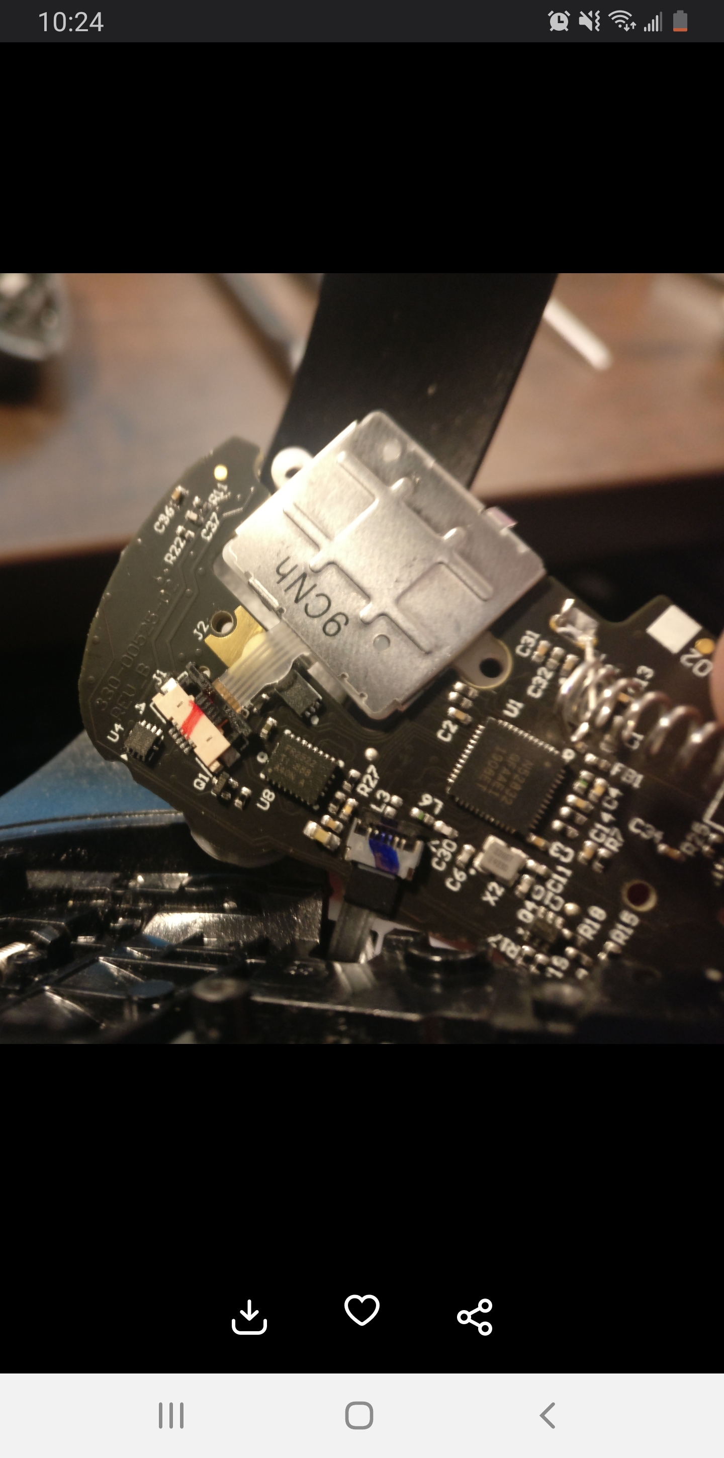

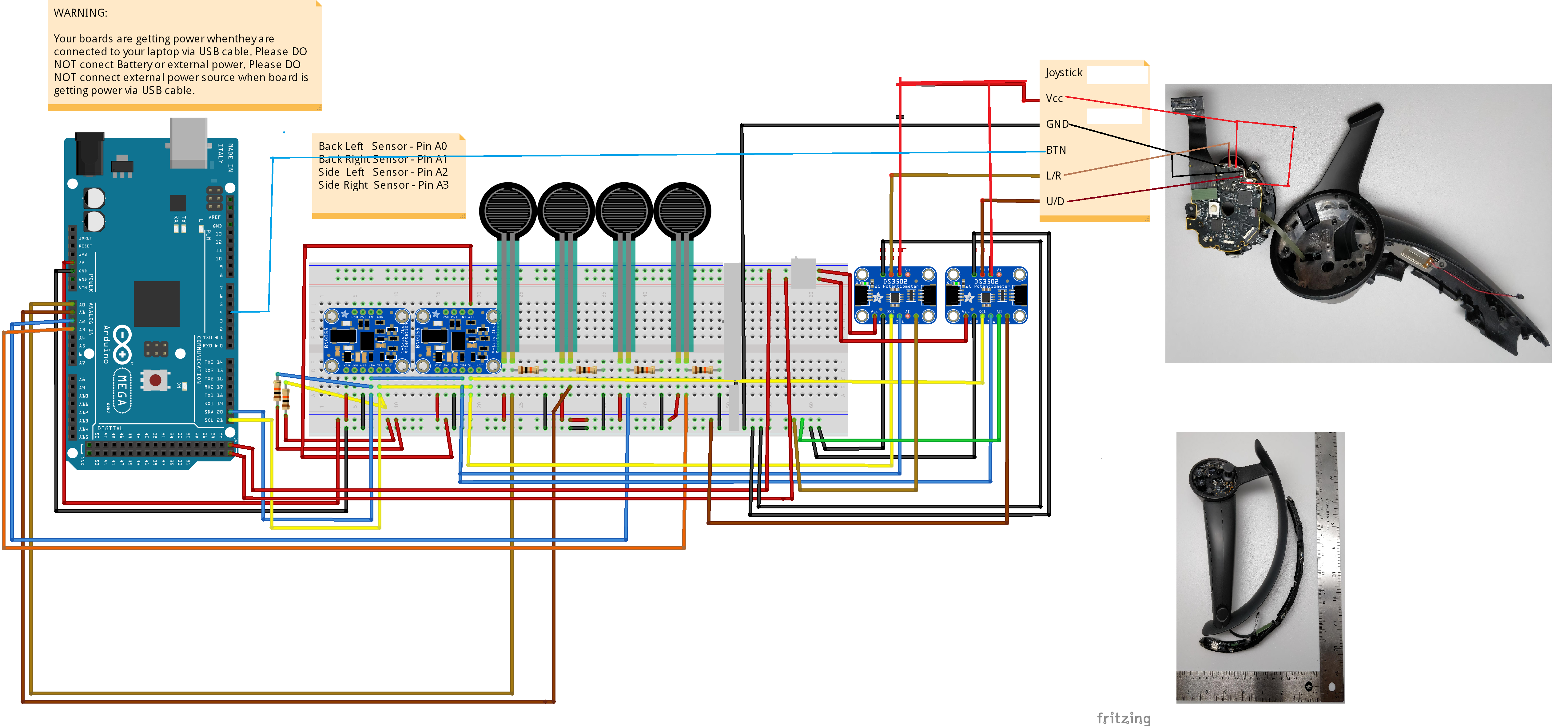

It is possible to make a custom vive controller using a vive tracker and changing the vive trackr to vive controller.Then it is possible to use the arduino due and some mix of this circuit
Then, using my method, we can control the joystick of this vive tracker controller and hence use my idea of locomotion system in vr gaming that use the vive controller pad for locomotion .

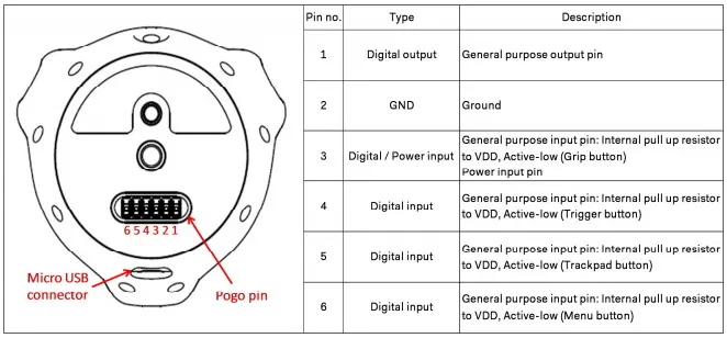

The arduino code I have found from the vr riffle have issue with the trigger, so the trigger has to go through the pogo pin. If we get a proper working code for the arduino due and the vive tracker, than we do not need to use the pogo pins. The arduijo due in theory is only neede for the joystick. The other functions of the vive tracker are in the pogo pins too and actually I think that vibration is only on the pogo pins, but I am not 100% sure
This is correct, there is no vibration feedback using the Arduino. The trigger pin on the tracker would be digital(Arduino could be analog), not that you ‘need’ an analog trigger.
Maybe I have the trigger wired wrong on the arduino. It has to be through the poetentiometer, correct ? That is why probably I was having issue. The thing is that in the code of the riffle the pins are all different now
d5 or d1 = press of joystick
a1 and a2 = axes of joystick
grip = d9
menu = d10
system = d11

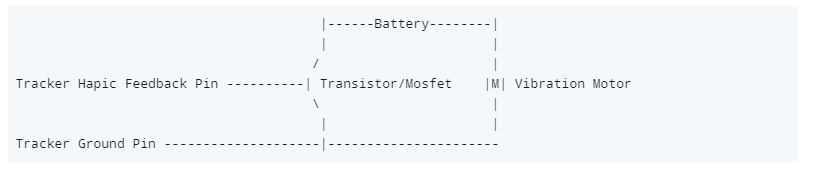

What can we use to make the vibration on the custom vive controller?

You could use small vibration motors(cell phone size), I’m not sure what the mA output is, but you could use relays to control something bigger if needed.

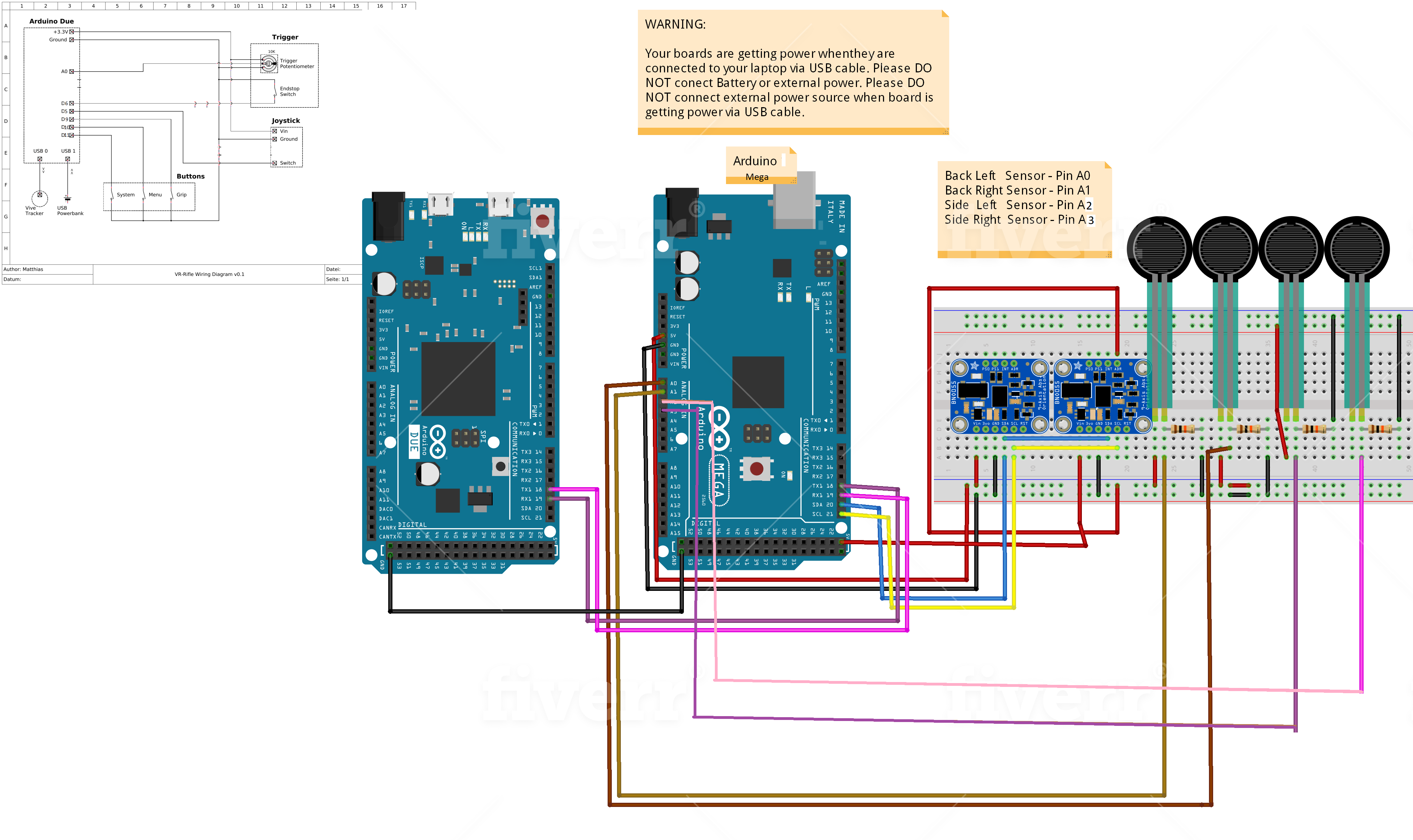

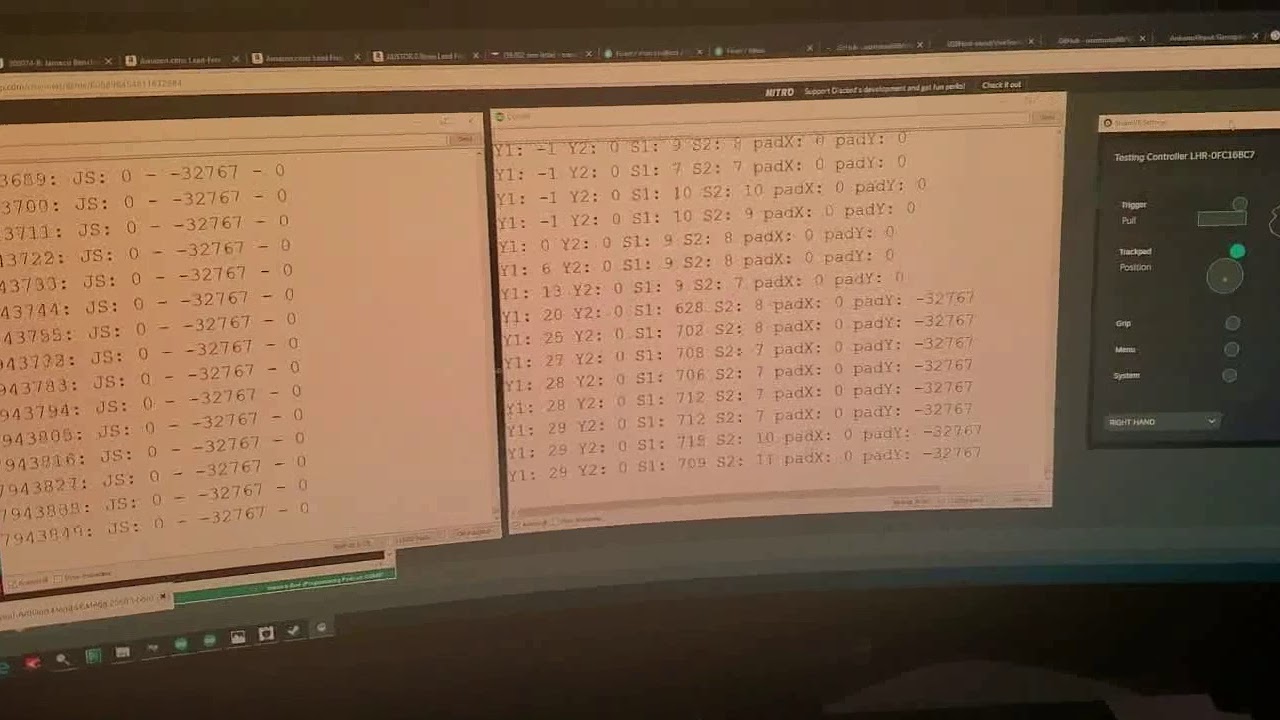

the video is of the data going from the arduino mega that I am using for locomotion using accelerometers and pressure sensors, to the arduino due used for making a vive tracker custom controller by matzman666
If anyone is interested to test, you can make your own vive custom controller using a vive tracker set in controller mode . and then you can control the track-pad of the custom vive controller with an arduino based locomotion system.

Working also on replacing the joystick of the oculis quest , with the arduino based locomotion system.
Pratically , with oculus quest (without the link connection) we could walk and run and strafing and go backwards , using the custom locomotion system , instead of a joystick

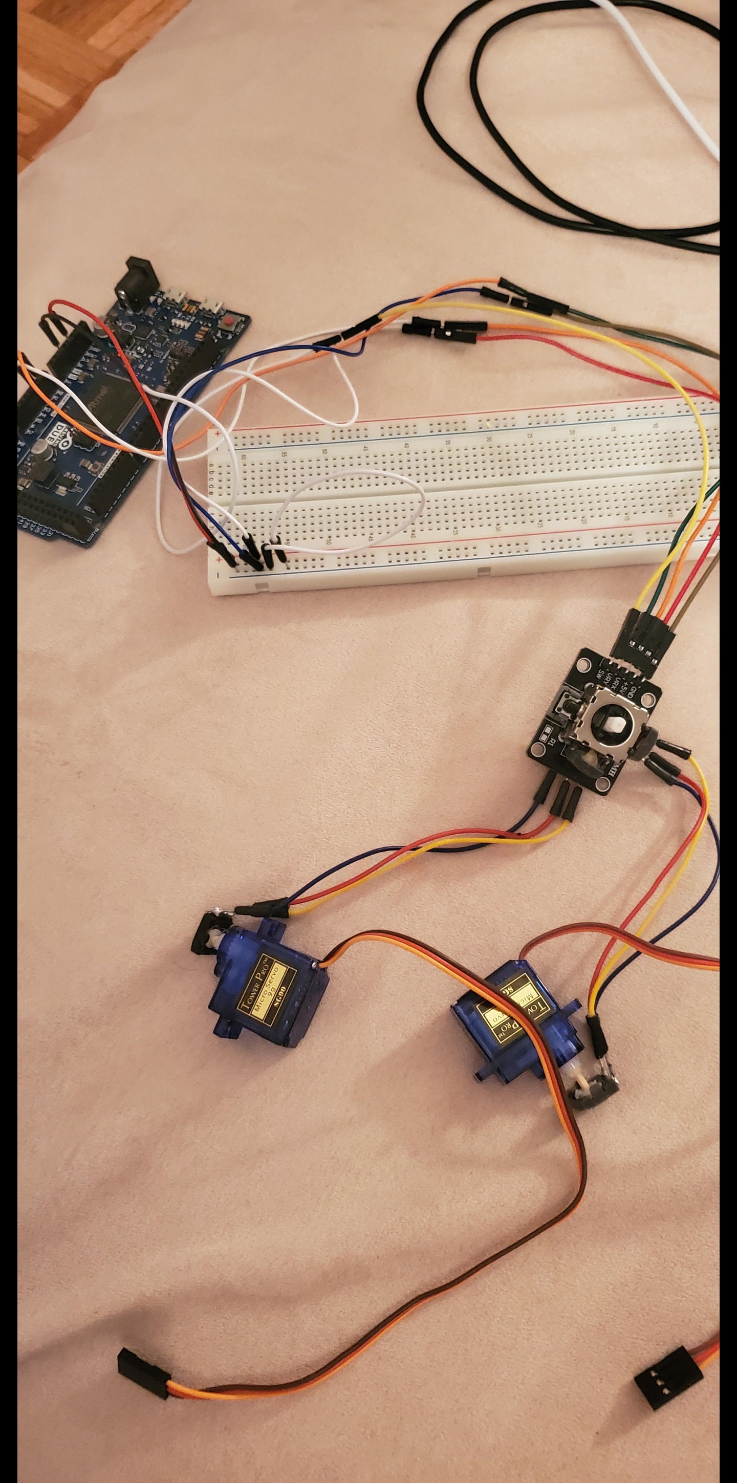

We were able to remove the servomotors, so now everything works through digipots and we can also arcivate joystick press and double press and release when running, to actuvate in game running or movomg joystick while keeping joystick pressed etc.
