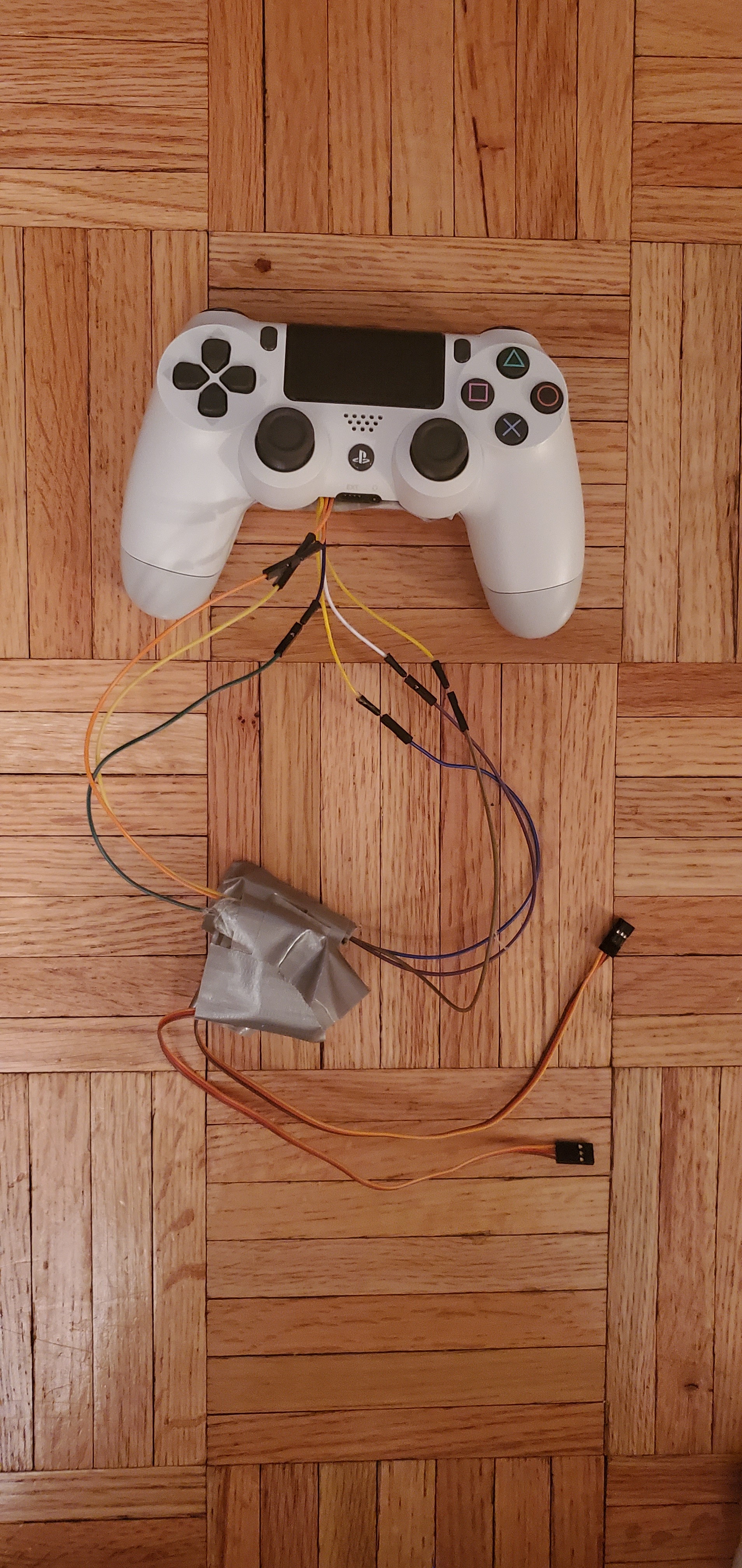

Custom made locomotion system through hardware modification of gamepads and vr controllers using arduino and sensors
https://streamable.com/j08y6

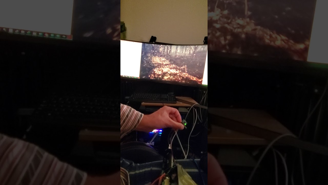

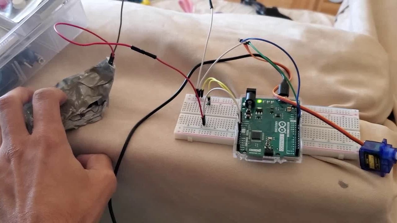

Going backward in the below video , but I have fixed it just reverting how the motors are mounted.
Still working on fine tuning the walk for smooth walk and sensitivity.
Still work in progress, including its implementation on vr controllers (like mounting it on an old oculus rift controller or on a valve index).
Thinking and trying to implement another solution for vr controllers (using still this system) , that would not require disassembling the vr controller or the gamepad controller.

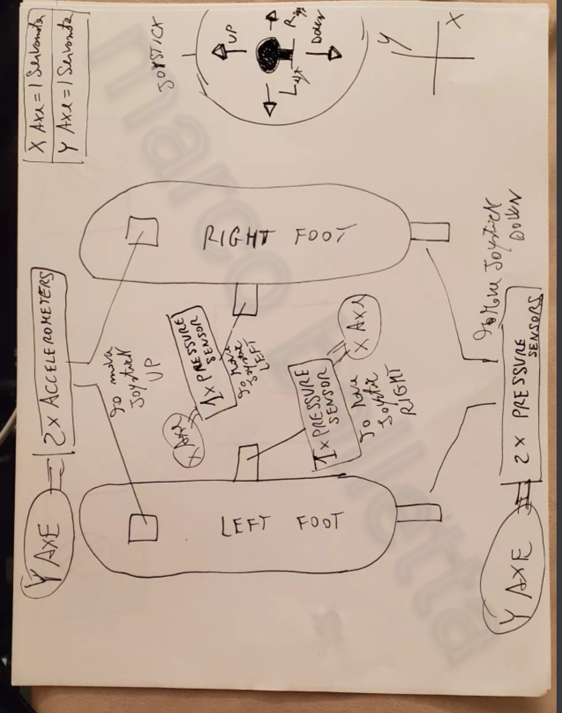

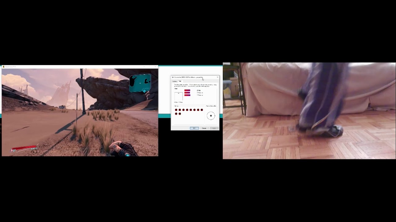

Testing the shoes
Very impressive looking. :beers::sunglasses::+1::sparkles::trophy:

But how would we then be able to control the joystick with the accelerometers and pressure sensors?
I guess we need some sort of arduino coding to be able to directly control the joystick of the arduino gamepad with pressure sensors and accelerometers.

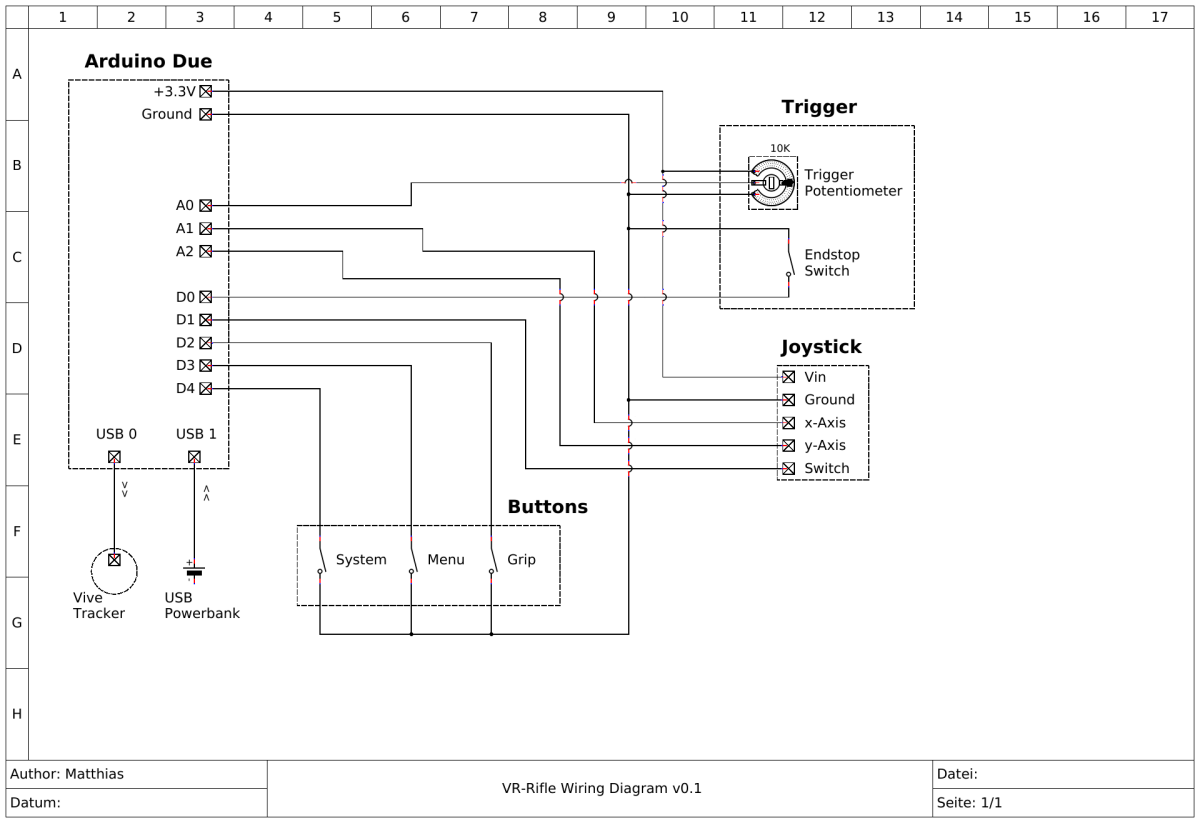

Would you please be bale to share with me the circuit layout of the controller you made ? Do u use arduino uno?

Also, the next step is to attach the setup I made , to the “arduino due” that is connected to a vive tracker and makes a custom vive vr controller with joystick in place of thumbpad.
Part of what you are suggesting is also what i wanted to do next with this vive custom controller , controlling also direcrly the joystick, wothout using the potentiometers. That requires me to ask though who is helping me with the arduino conding ,to make a code that controls the arduino jiystick directly with the accelerometers and not going through the potentiometers
https://www.reddit.com/r/Vive/comments/afqg7z/got_tired_of_waiting_for_knuckles_so_i_made_my/?utm_medium=android_app&utm_source=share

I have made my arduino custom controller based on the above circuit and library but i have ordered the arduino joystick for completimg the circuit . The one i have is broken so i was not able to test the joystick yet :frowning:
Yes, the accelerometer would be mapped to the Y-axis for movement, I’m thinking this would just send a Y axis value instead of controlling the servo.
I am using the GamepadPins sample code as a starting point and I made a modular box with a Pro Micro clone, so there’s no real layout.

But how are the different buttons connected to the arduino? Is there a circuit/skematic for it ?

I can see my vive tracker as an hand and I can click the buttons connected to d0 and d2 and a0 and I have the vive tracker performing actions in steamvr.
Nothing happens instaed when clicking the buttons I have connected to d3 and d4. Maybe the pins/functions associated to the pins have changed ? Is there any way to test al the pins, I mean figure out what pin should do what and how to use that pin to send signal to the vive tracker?
Do you mean for the vive tracker custom controller?
If yes, I just copied the circuit done for that riffle/gun and I see that some buttons works, some others I am not sure they work and the joystick I need to test it as soon as I get the joystick. I have to let you know about that idea of the use of the vive tracker 1.0 for he custom controller. Hopefully this week I get he joystick and I can solder the board
