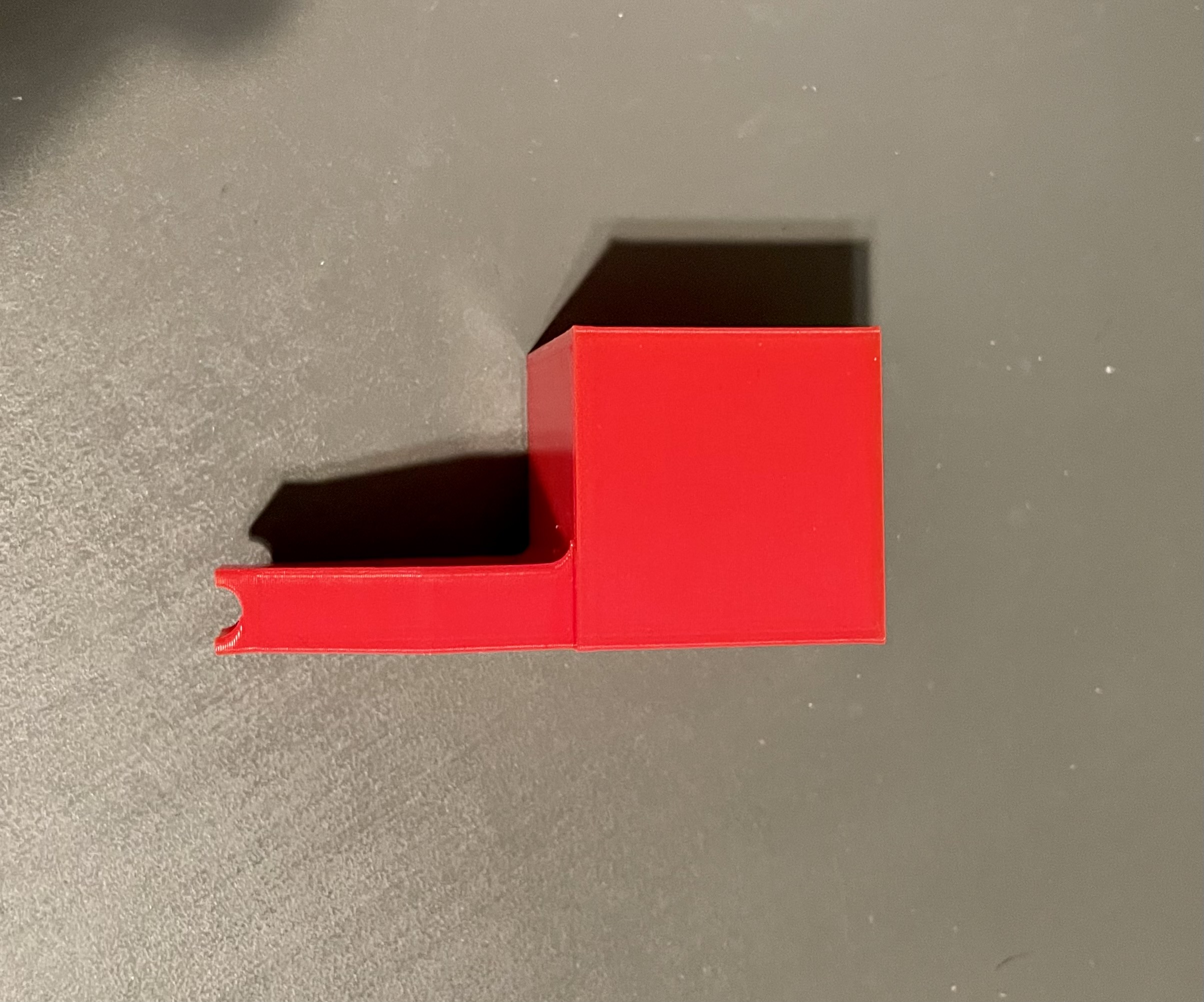

OK so I just quickly modified the snorkle fan with a 30mm front - You will need to make sure you use the flat Peg and I would use a bit of double face foam tape to secure it.
https://cdn.thingiverse.com/assets/55/bc/83/15/84/Pimax_DAS_Peg_Flat.stl
It looks like it printed ok so let me know how it goes for you.
