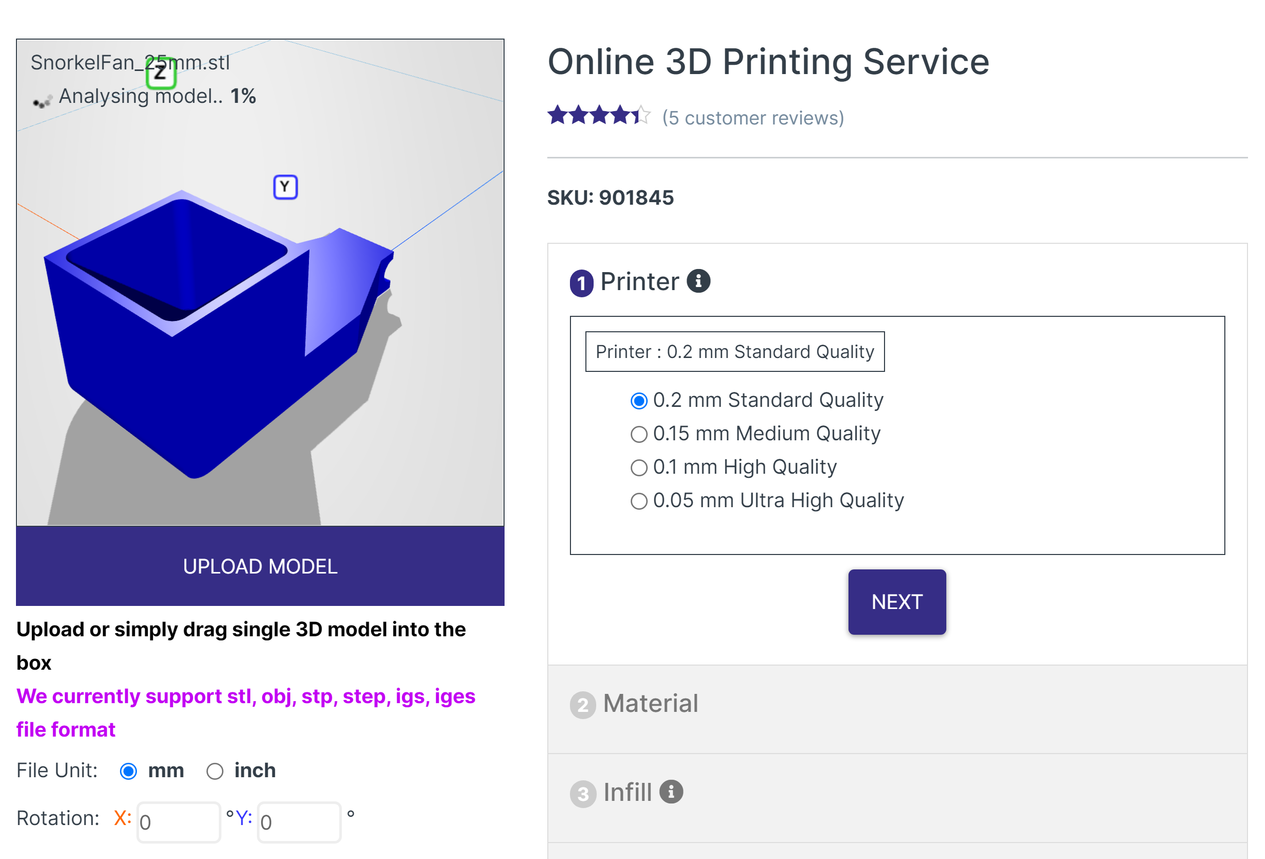

Hello brother, need little help to select what’s will be the best while ordering in 3D printing online, I attached the screenshot below so please do let me know what should I select, You can’t believe but honestly, I have never ordered such services before

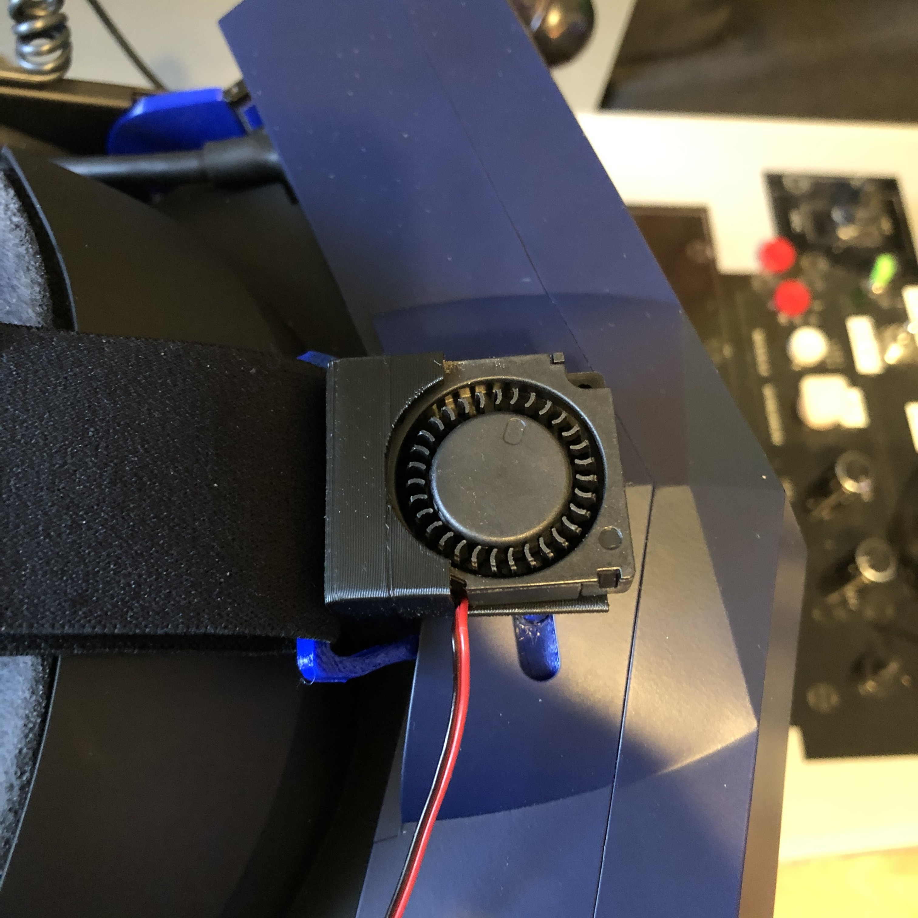

This is a 30mm side fan i think!
Remember what you want to print,25mm or 30mm
Thanks, bro, Do you have any idea about what to select
Printer Quality - 0.2mm or 0.15mm or 0.1mm or 0.05
Material - ABS, PETG, or PLA ( I assume PETG is far better as I saw some people said that )
Infill - I have no idea about this what to choose in between 10-100%
I am asking this because this is an online order as no offline services are available at my place so I don’t want to order something wrong which is non refundable.
Why don’t you try 0.15 medium quality?
Material i don’t know.Go with what you know!

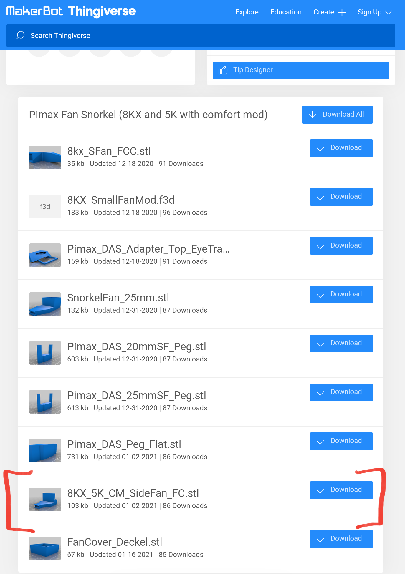

According to the @Sidekick1 snorkel thingverse page, infill is 100%.

FanCover_Deckel.stl
Printer: 0.15 mm Medium Quality
Infill: 100%
Material: PLA - Blue
Scale: ×1 (2.7 × 2.7 × 1.4 cm)
Filename: SnorkelFan_25mm.stl
Printer: 0.05 mm Ultra High Quality
Infill: 100%
Scale: ×1 (5.8 × 2.5 × 2.7 cm)
Filename: Pimax_DAS_25mmSF_Peg.stl
Infill: 100%
Scale: ×1 (3.14 × 0.76 × 3.3 cm)
Filename: Pimax_DAS_Adapter_Top_EyeTracker.stl
Infill: 100%
Material: PETG - Blue
Scale: ×1 (5.95 × 3.89 × 2.48 cm)

@tadnyarahul Use the sidefan snorkel as this uses a side fan.

@tadnyarahul The sidefan snorkel uses a 30mm fan with a side outlet.
Btw, What is the use of this side fan snorkel?
It is more of an open fan that lays on it’s side and pulls from the top. It pushes more air but it makes more noise. I made several prototypes.
