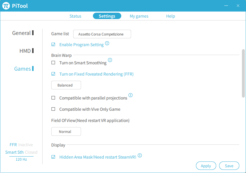

Hi I have been Looking into Asseto Corsa Competizione for a while, often with no luck (used to run really bad).
I did give it a try now and it really has improved. I am able to mange About 60 FPS ±7. It doesnt look like a Dream, but it is playable now (imho for me).
So i though I post the Settings (@SweViver ) in case some one wants to give it a try or has better tipps.
Sorry the “through the lens” shots are not anything near @SweViver 's but I hope the most stuff is readable enough - if not I will try to type down the Setup.

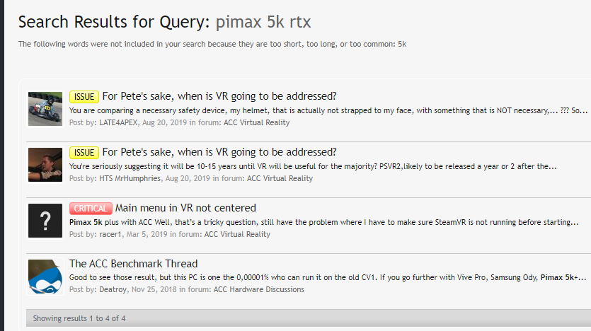

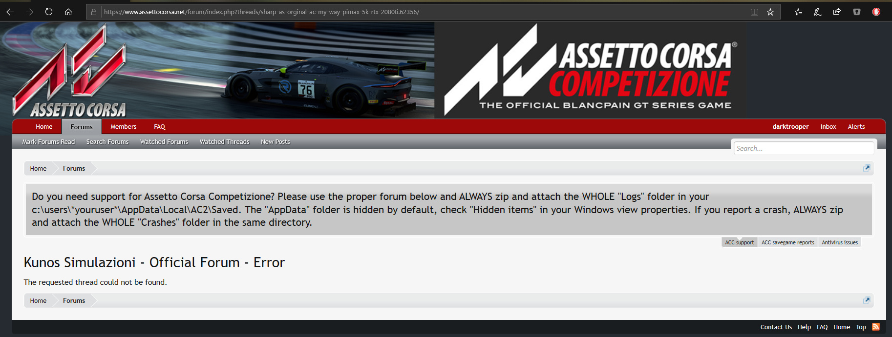

Sorry - the link is not working for me and Keyword search did not return the same thread…
can you post the link again?
It works when I click on it. Weird. Do you have account there ?
Go to “ACC VR” forum tab, its on first page .
Thats what I get.
Yes I do
it is DarkTrooper
https://www.assettocorsa.net/forum/index.php?members/darktrooper.198671/
just type Pimax 5k in search
Edit : now its here :slight_smile:

Thanks ! I tried it - the sharpening helps! did lose a few Frames but using 90/45 will work fine (instead of 120/60)
you can try add FXAA in game options if you like but sharpness will be slighty worse
BTW I tried my setup with 60/120 but recived “out of video memory” error - that weird for 11GB RTX card :slight_smile: Maybe this is PT version issue ? What is your PT and firmware ?
You might try lowering your PiTool Quality setting. Some games automatically use super-sampling, which uses more memory. I’ve personally had the issue with Hellblade and needed to have PT at 0.50 to run without crashing at startup.
I will check asap - just back from work but I do have pitool set to 1.0, normal FOV and steam to 120%
Edit:
PiTool 245
HMD 2.1.255.255
Hidden Area Mask is enabled, SS on FFR Conservative, ,Normal, RQ 1.0
