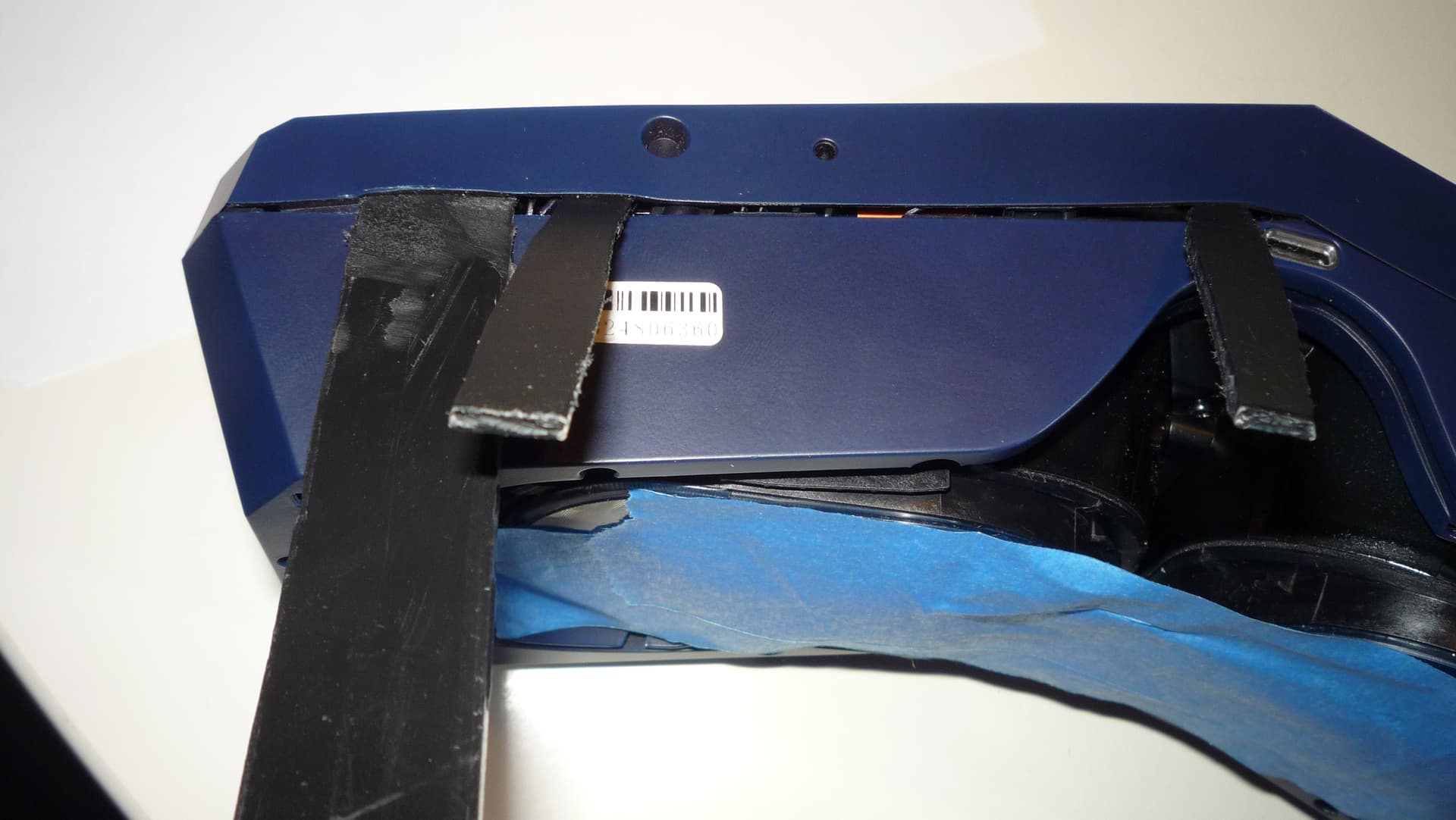

I did the mod. I had to or the headset would have been useless to me. I made some pry bars out of plastic for splitting the cases. As far as the slider goes, you dont have to disable it, you can meticulously drill a small hole through actuator that the slider “pin” will go into. Just take your time, dont get in a hurry, document with pics.

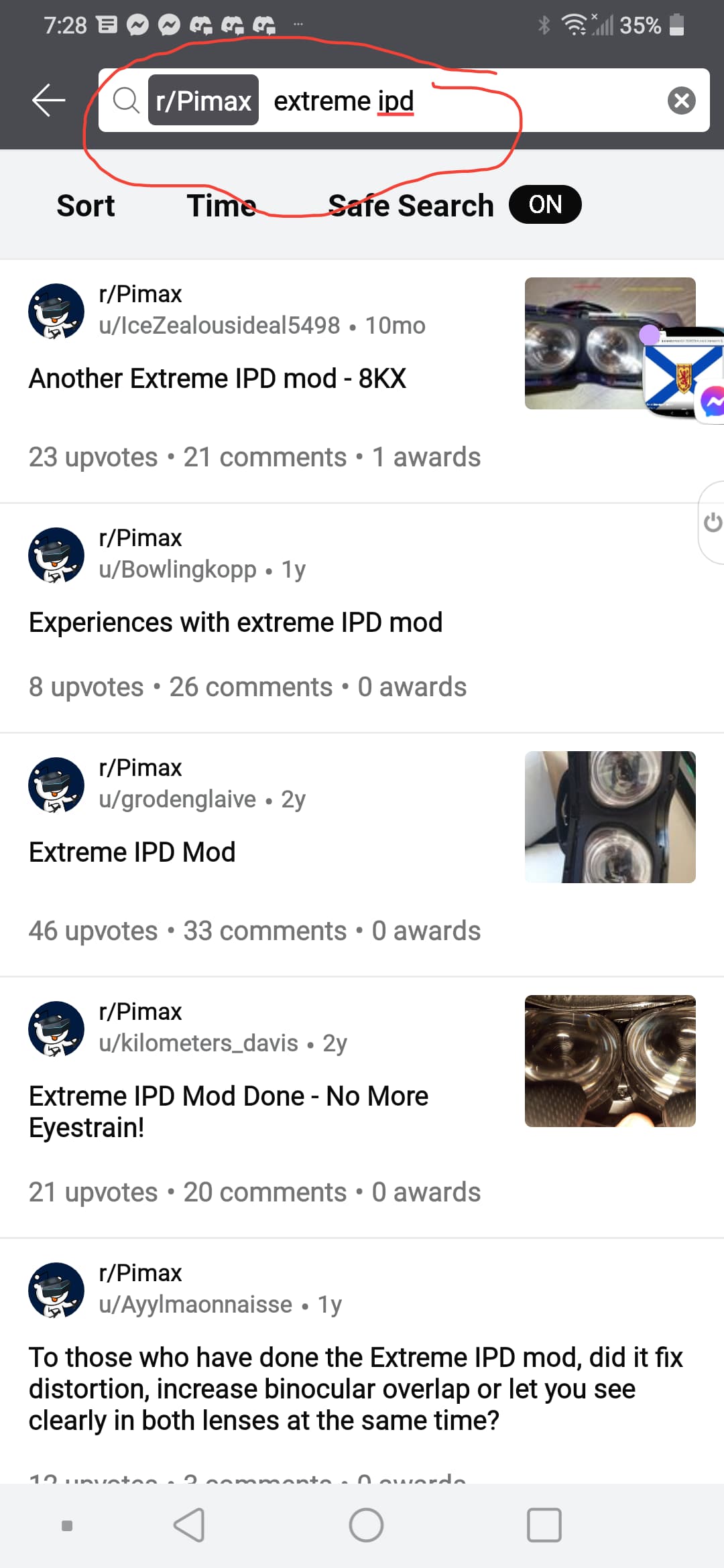

Use this search term as shown in r/pimax on reddit.

Man its been over a year since I did the mod so I dont remember much about it :roll_eyes:. Sooo that being said if you look at the 2nd pic , just below the left lens, you can see the slider under the square plastic actuator(has a round hole to the left of a square hole which was the old hole the square gray slider pin protrudes through, hope that makes sense. I dont have a tutorial or documented mod, I just shot pics of everything. If you send me your email address I can send the pics, I took them in incremental order. The pics might just make the whole process confusing, lol. But it can be done.
