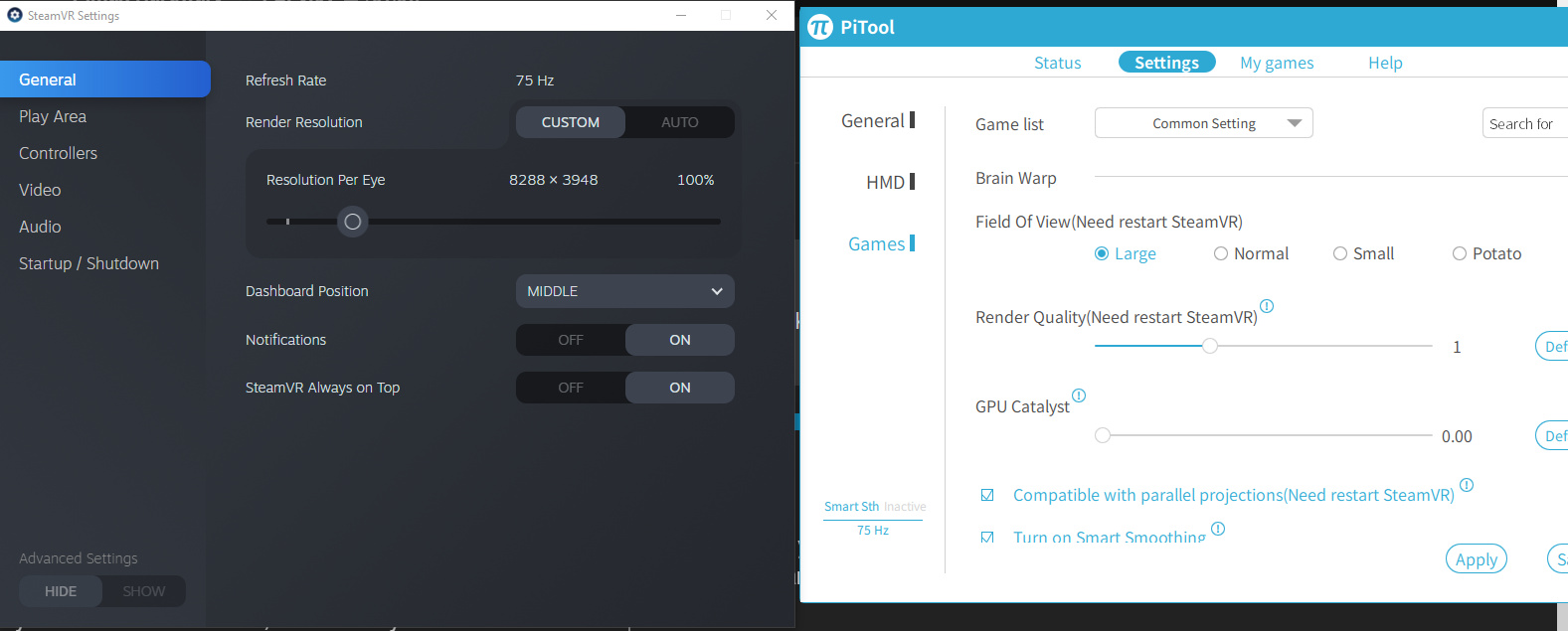

For the reason i have mentioned before, but you missed it. When you setup your 8kx, this are defaults:
This is how it starts:
This is the resolution which you see if move the slider to steamvr recommended
If you set to ‘auto’ it will be again a different one.
And this is native resolution from native spec: 3840 x 2160
Dont you see the difference? And then you start moving these sliders up and down with no visible change, and your fps is not changing. Still dumb users doing sh1t? Or maybe its just pitool being not very userfriendly doings its own sh1t? Or maybe its steamvr with his limitations by default which not everyone knows about? It takes time understand this things and its not possible if we dont try and dont discuss this.

Maybe you missed the most important point: Because pitools software updates and StemVR updates do change the standard resolutions. The only way to avoid that is to focus on vertical pixels (PP does enlarge horizontal pixels) and manually select there to around 2160. Then start the game and check with fpsvr or SteamVR performance graph the frametimes. If you have headroom you can go further up with the vertical pixel settings. Depends on the horsepower of your GPU and of course the game.
