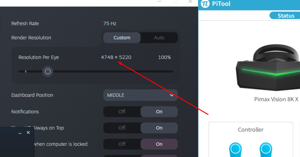

Resolution per eye in SteamVR? Check your screenshot. Something went wrong there. Small FOV?
And to say they blew image quality - based on the Home planet? Do you know what texture resolution is to begin with?

Nothing wrong. I have not posted this anywhere yet, but the time has come. There is no way to find out real resolution rendered and there is no way to change it. Its locked and limited somewhere around 4k and there is nothing you can do. You can only lower it (which is clearly visible), but you’re not able to go above 4k even if your steamvr shows he is trying to render 16k :smiley: Pitool rendering quality 2.0 + steamvr supersampling x200% visually provides same picture and same frames amount with no changes whatsoever. Its possible its some bug, but i think its just limited by dp to avoid issues. It is also possible this is why games with PP enabled look a bit worse than PP disabled, not 100% sure through. I have spent yesterday 4 hours trying to understand why resolition changes from 4 to 8 depending on the fov/pp settings, and then reallizied - its just doesnt works and has no changes above 4k, there is no point of trying changing it.

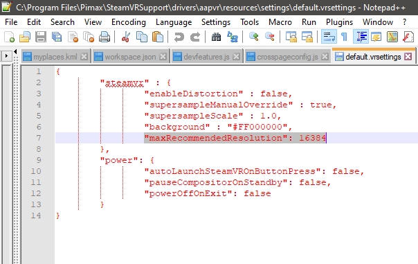

maxRecommendedResolution:16384 in steamvr.vrsettings will let you go above 4k
https://community.openmr.ai/t/maxrecommendedresolution-where-to-set/26682/5
As i said, i’ve spent 4 hours yesterday. I made a clean instal, deleting any pitool folder i could find in program files, program data, local app data. I have also uninstalled steamvr and deleted configs and steamvr folders as well. I was testing half life alyx, i was ingame, and i could see with my own eye steamvr saying its rendering more then 16k resolution, in big FoV, with pitool supersampling of 2.0 - with 75 stable frames (which is nonsense) giving me visual quality of 4k.
4 hours of trying different settings, different multiplies, restarting game everytime, restarting steamvr time to time, and the only difference i could find - if i go below 4k. So this slider actually worked, but only for decreasing, and no increasing resolution.
As i said - its possible it is a bug, but for now this is how it works, because there is no way this guy could test games with 1080 gtx and resolution above 5k.

What if i dont have it set anywhere, should it work or is this must have by default? My config files have no maxRecommendedResolution.
@CMM In your screenshot you’re editing the wrong file. It needs to be steamvr.vrsettings not default.vrsettings.
open cmd and run
C:\Program Files (x86)\Steam\steamapps\common\SteamVR\bin\win64\vrpathreg.exe
it will tell you what folder your current config files are in. then edit steamvr.vrsettings
if the setting isn’t in the file then add it so it looks like in the screenshot
also this was meant as a reply to the original post but it should work for @industria as well, just dont mind me talking about your screenshot :wink:

If u dont have it set, then you have it on default 4096.
The config file can also be in /appdata/local/openvr/
Only edit the steamvr.vrsettings and NOT the default.vrsettings

One more thing to keep in mind is that some games (ie SteamVR Home, some other Valve games, maybe HL-Alyx) use dynamic supersampling.
IIRC, it looks at your settings, says “I know what they want better than they do”, ignores your settings, and dynamically changes the SS to keep a consistent frame-rate (decided by them). Then the game might look like garbage no matter how high you set your SS.
there is a start parameter that will disable that, i just don’t remember what is it. google should know.
Just try adjusting these.
No need to set set supersamplescale or resolutionScale higher than 1 with 8KX. Its already overkill at these values below. Although, I recommend you to try gpuSpeedRenterTargetScale to 1.5.
Rememeber to ALWAYS edit steamvr.vrsettings and no other files.
steam1
steam2
Heres the thing, with Pimax VR Experience, you will be able to either automatically or manually set all this values with 1 click. Or just let the VR Experience always set these values for you when you start a game.
Way easier than editing the values manually…
Remember that every time you restart SteamVR, one of the gpuSpeed values gets updated, because a new “benchmark” of your GPU is made upon SteamVR startup. So if you set all values to 2000, after 10 reboots, all values will be lower again. This is why I want the VR Experience to set these every time, so you never need to bother about SteamVR crippling your image quality.
