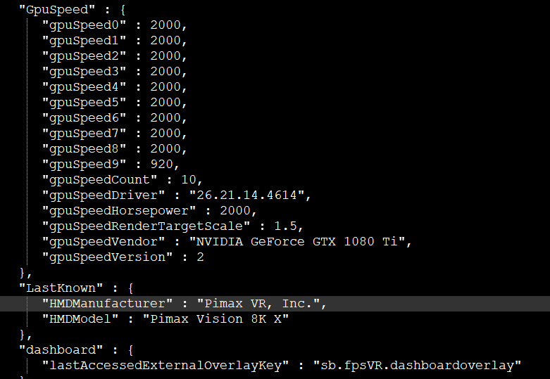

Hmm, my gpuSpeed values are in the 800’s with a 1080Ti…does that seem right? I’ve never seen/heard of anyone touching those values. What do they mean?

Around 1000-1100 for 1080Ti, everything between 1200 and 1500 with 2080Ti.
Setting it to 2000 is best, because the average value will decrease for every SteamVR restart.
The average value is auto-generated by SteamVR, its called: gpuSpeedHorsePower, and no matter what you set it at, it will be an average value or your gpuSpeed0-9 values together.

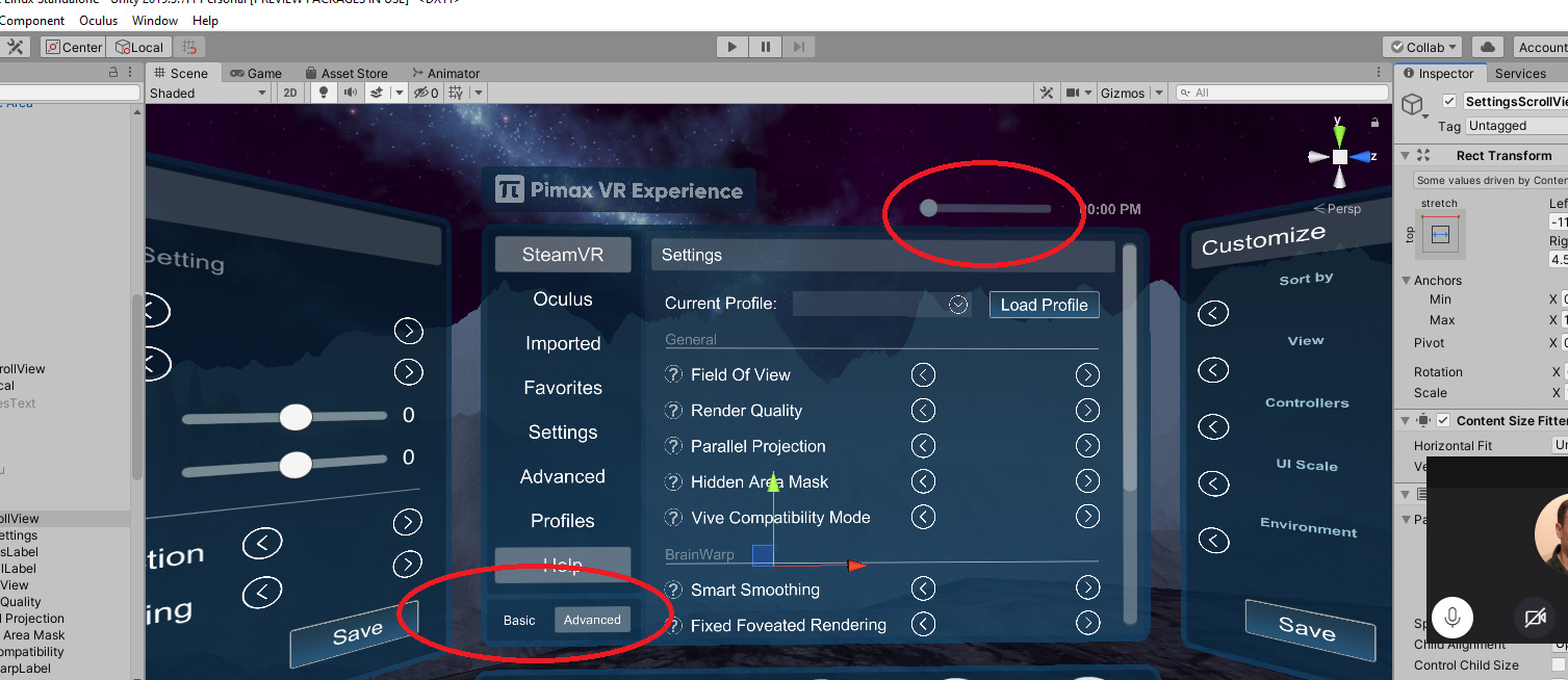

Currently Im messing around with Basic/Advanced mode switch and volume slider which for some reason have taken me quite many hours to get right haha

Have you tried doing this with 1080ti? Should i consider it as very low and being not able go above 4k?
I have tried step by step.
  1. edited both configs
  • D:\Games\Steam\config\steamvr.vrsettings (this one changes values with each restart)
  • C:\Users\nothi\AppData\Local\openvr\steamvr.vrsettings
  1. disabled advanced settings
  2. edited gpu speed values to 2000
No changes :frowning:
No matter what i do, the game launches in same resolution. Changing supersamling in pitool has no affect too. The only changes im being able to do - changing FoV or decreasing resolution below 4k. Going above has no impact on my frame rates or picture quality.
