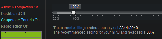

Just increased SteamVR to 100% just to see what it looks like:

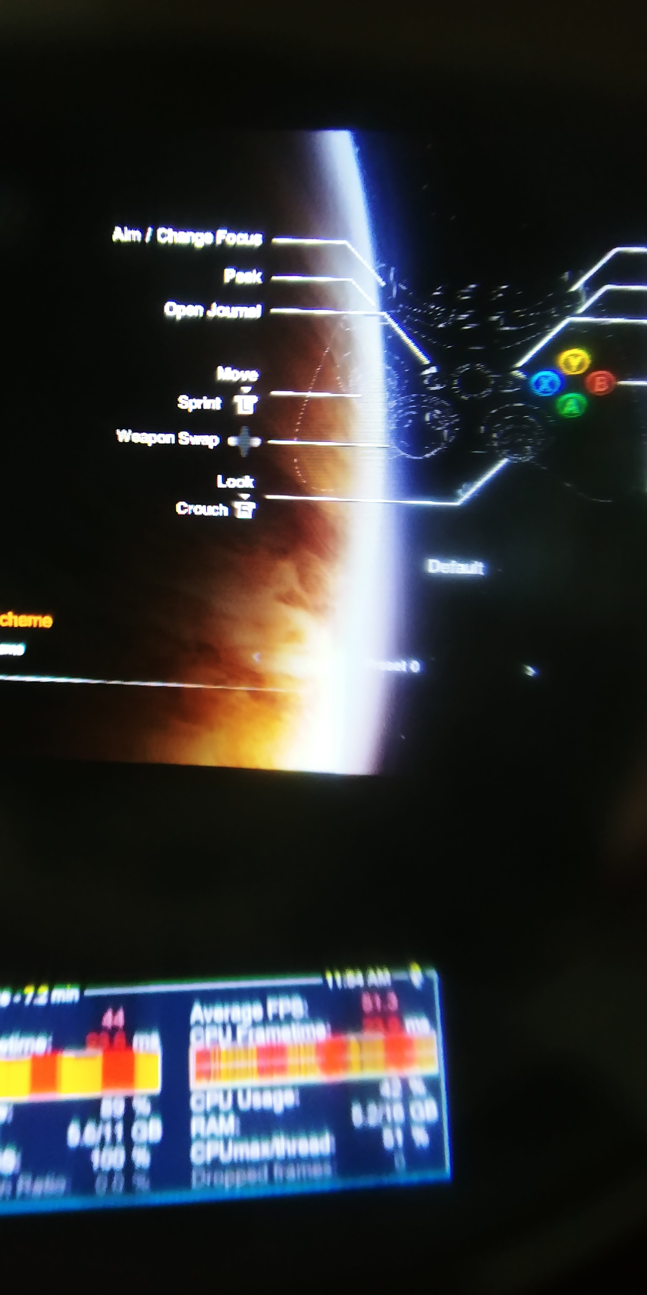

and just saw your post so done controller shot
(blur only cos of phone position)
Okay will exit. Though on the 8k don’t need to turn manual override. It suggests 16% on mine where I see it says 38% for your 1080
Fps on the otherhand the overlay looks a touch better than what I see in with the 8k.
So you’re on auto? sounds like its subsampling too far which the pic backs up.
Try manual adjusting.
New pic of controller
hmm, still looks like crap compared to what I’m seeing. something odd with a setting going on somewhere. Wonder if the fact you have an 8k has done something somewhere in pitool backend config?

Its the steamvr setting, if it gets too low its potentially going worse than native res. Something is pushing that resolution down.
What setting did you last use and what res did it show?
Have you tried steamvr at 100% (vid) manual, I know fps will be ‘poor’ but does that improve image quality?
Yeh the shots were at 100% override

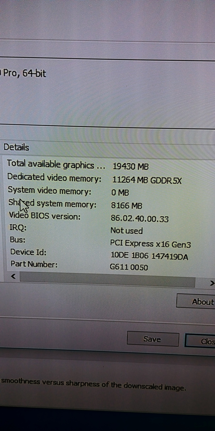

Hmmm… Gut feeling that cpu shouldn’t bottleneck it all that much. Is the gpu definitely running x16? Only say that as I fell for that on my previous pc, another pci adapter had nudged my gpu down to x8 and I had no idea as it was still running ok at the time.
If unsure, quick check on nvidia cp > system info > Bus:
Have you done any benchmark comparisons?
Will check it later but only have 1 pci-x slot. Itx Board.

NV panel checks okay. You system Differs to mine with considerably stronger cpu & double the ram. I have ran 3dmark & vrmark with decent results on par with ranking.
