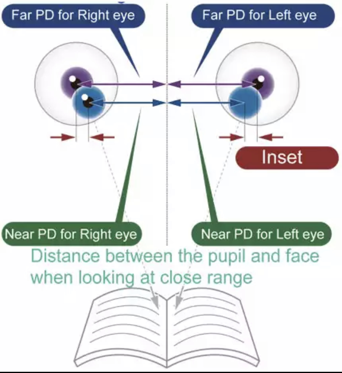

Contrary to what many believe, people do not have a single IPD. We have a range. This generally goes between NEAR IPD (reading a book) and FAR IPD (seeing a landscape). Among them we have a full range of IPDs, like the Computer IPD (closer to near than to far). Optometrists usually only give the maximum range, but not the intermediate ones.
The IPD is totally related to the real sense of depth and presence. For example, if we use the NEAR IPD in VR, we will see close objects with the depth that they have in the real world, but we will see they flat and closer to what they should be.
If we use the FAR IPD (as is usually done) we will see the nearby objects flatter than they should be and somewhat distant, but we will see the three-dimensional backgrounds and in place.

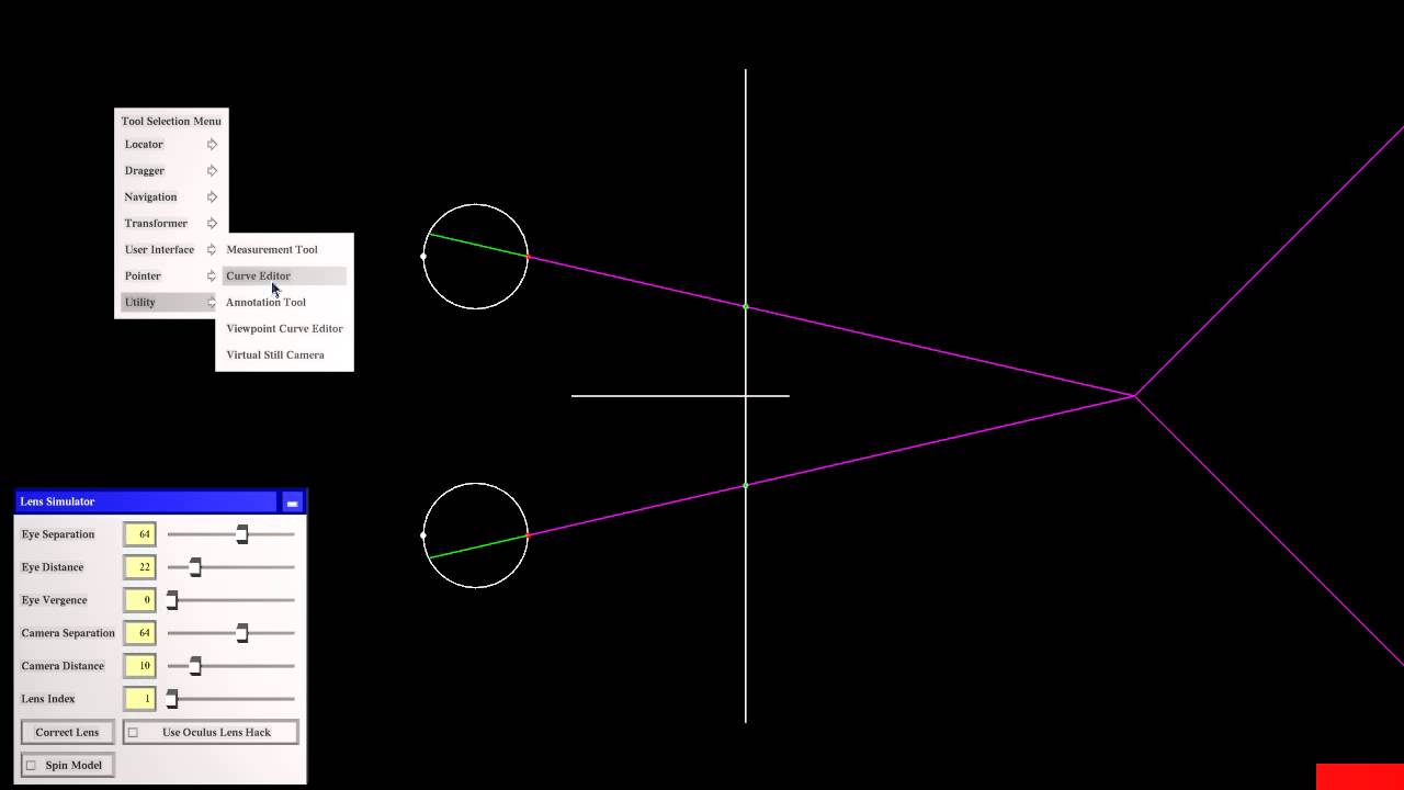

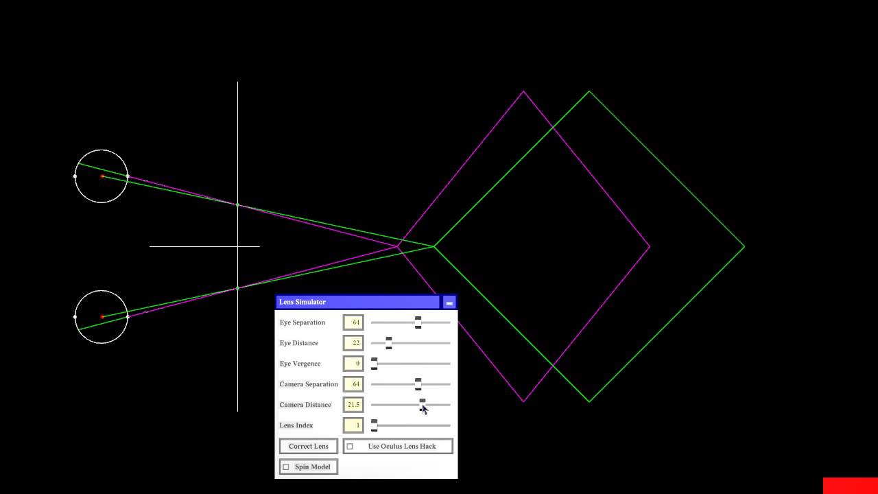

Doc Ok made a video some time in the past, that first demonstrates the effect on a fixed camera projection, when looking around, but then, also, at the suggestion of a commenter, how decent a universal approximation it is, distortion-wise, to make the projection from the centre of the eyeball (…which I guess everybody are doing), instead of the centre of the eye’s lens.

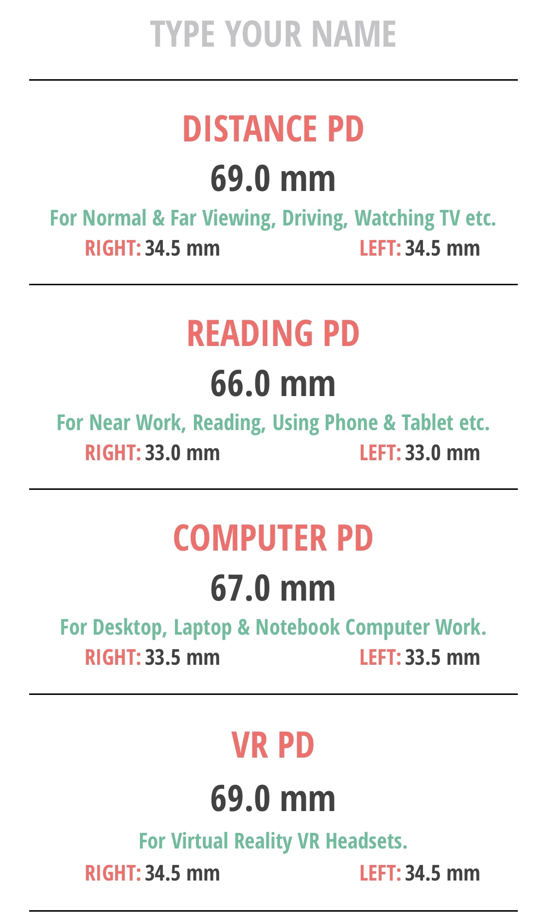

And well, for professionals… I’m actually Epic Official Instructor and I work together with Unreal programmers in the VR department. We always work with VR IPD and not far/near.
iPhone also has 3 apps that give you VR IPD and not only far and near, using frontal camera scanner.
And here you have one screen capture of one of the apps we use. This give the VR IPD for open worlds games.

You meant something like this: Computational Imaging?
This is what I had on mind in my reply, but this will really be only addressable by dynamically adjusted eye pose in runtime, not by arbitrary (but fixed) change to the IPD, which is just a scalar and cannot even describe the full position of the eye. Plus it may as well put the eye on the “other side” from the center, depending on where one is looking.

Exactly. Eyetracking is needed, as would be, preferrably, API standardised eye pose updates for every frame.
The developer is of course free to move the cameras around to suit any whims on their end, unrestricted by the hosting VR runtime, but just adjusting the fixed IPD for a scenario, would be to make the assumption that the user will only ever look at an object that is right in front of them, and at a certain distance. Were one to really double down on the former, one could update the latter with a raycast right down the centre of the view, but it would be unfortunate to do that doubling down in the first place. :7
